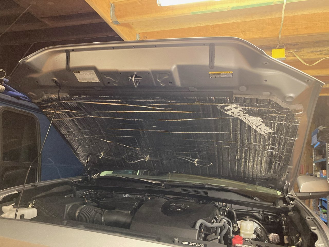

    I bought a hoodliner claiming to absorb sound as well as provide thermal protection for the hood paint.

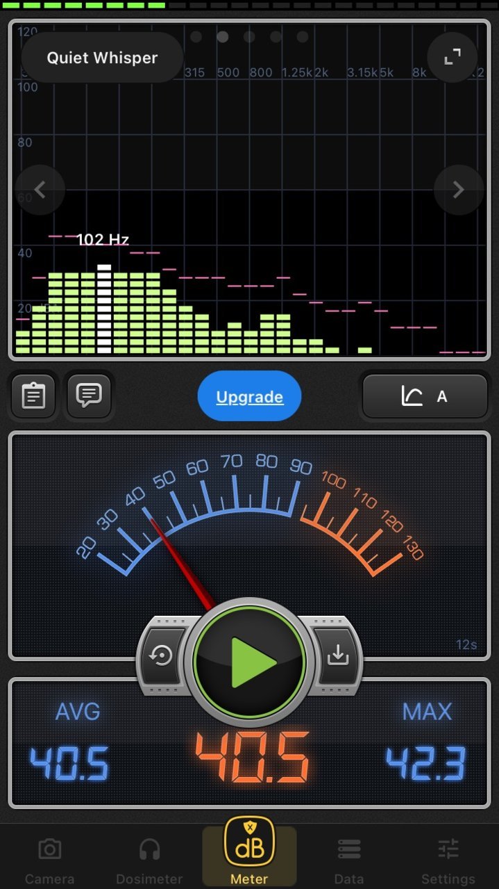

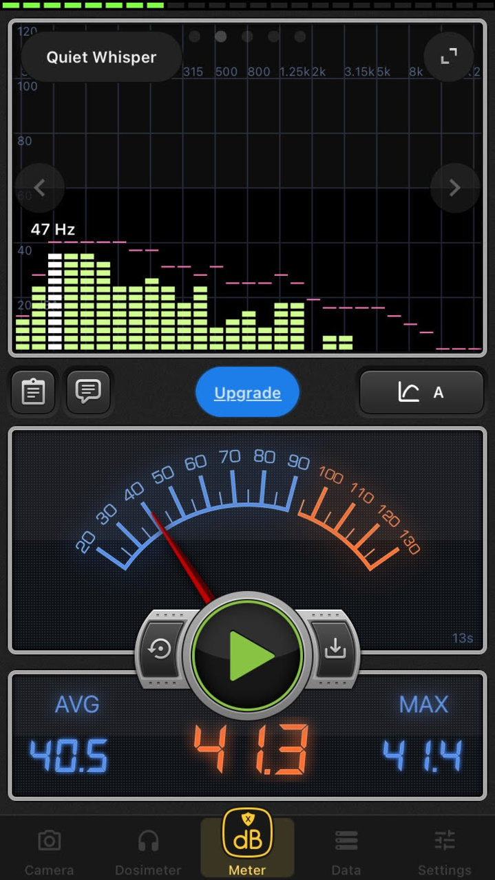

    Using an iphone app, I took A weighted frequency spectrum measurements (10 seconds), before and after, in the access cab outdoors (no reflections) with windows rolled up, stopped and idling. The iphone was held horizontally with the microphone pointed at the windshield near the driver's head position.
    Attached are the results. Absolute numbers are not important. Relative before and after is what I was after. I checked the app calibration and it is reasonably close to an SPL meter I have but this is far from professional equipment. Take absolute numbers with a grain of salt.
    When comparing before and after, ignore everything except the blue "AVG" and "MAX" dBA numbers and the red max frequency band hold bars. Everything else is instantaneous and not relevant.
    The ticking seems to be in the 1.25KHz frequency band. I checked with a stéthoscope and I believe it is the high pressure fuel pump making the noise on the passenger side of the engine, though minor injector ticking can be heard all over the engine.
    A 3dB difference is just barely perceptible by a human. This is a total failure ticking noise wise. I think the cab might be a bit quieter in the lower frequencies but that makes the ticking all the more noticeable. I think the ticking is really coming from the outside thru the doors. Some soundproofing of all surfaces might actually shield you from the ticking. Too much trouble for me.
    BTW: the box it came in showed expected before and after chart and 3dB was mostly what it showed. That is a joke. If these people are competent acoustical engineers, the product is a fraud.
    And there is a click bait youtube guy that claims it made the ticking go away with this "secret" fix. Another commenter called him out as a jackass and I guess I now agree, though it was only one of the inputs to my decision to gamble $55 to nail the ticking.
    I'm not posting a link to his video to give him more of what he wants (clicks).
    I did spend a fair amount of time trimming the liner to meet the gaskets, etc. The little that was leftover I applied to the firewall..not sure it made any difference. The firewall already has some factory material on it but it was not completely covered in the upper portion. There is a thread where a guy covered it with sound deadening material and claims improvement, but he showed no numbers and it was for a 2nd gen. For the 3rd gen I think this will not work.
    So, bottom line: I think the cab is a smidgen quieter but now I notice the ticking all the more. The thermal protection of the hood paint from the engine is probably BS. Would I do it again...NO.
    The product was Dynamat 11905 hoodliner. $55 shipped on Ebay.
    Attached pics of installed hoodliner, before and after dBA measurements. Practically no meaningful difference in those screenshots. Disappointing but not surprising.
    Installed:
    Before:
    After:
