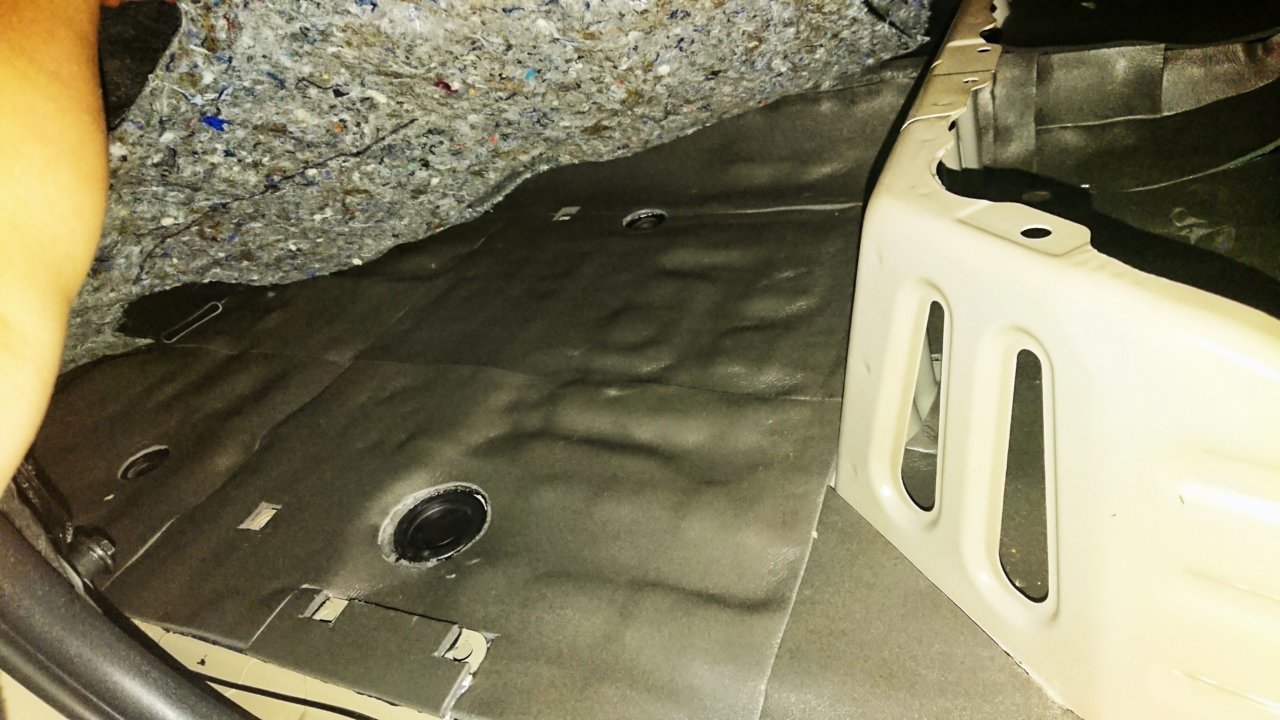

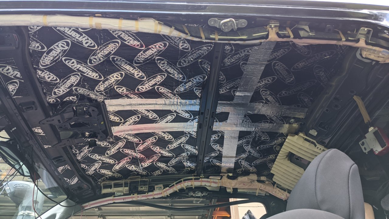

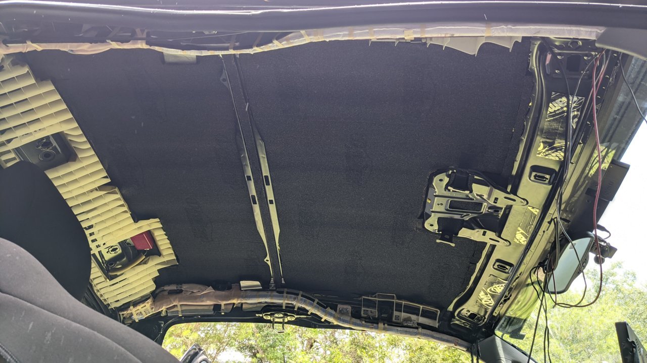

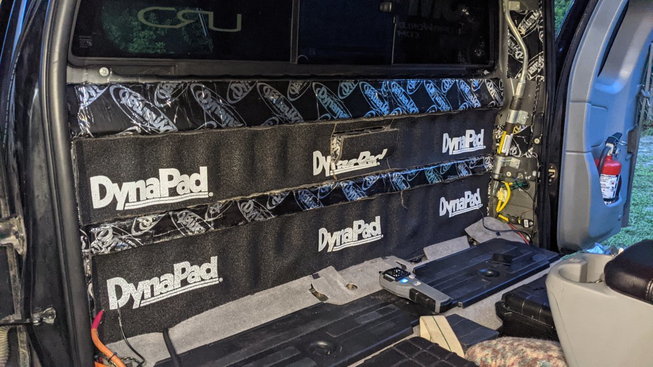

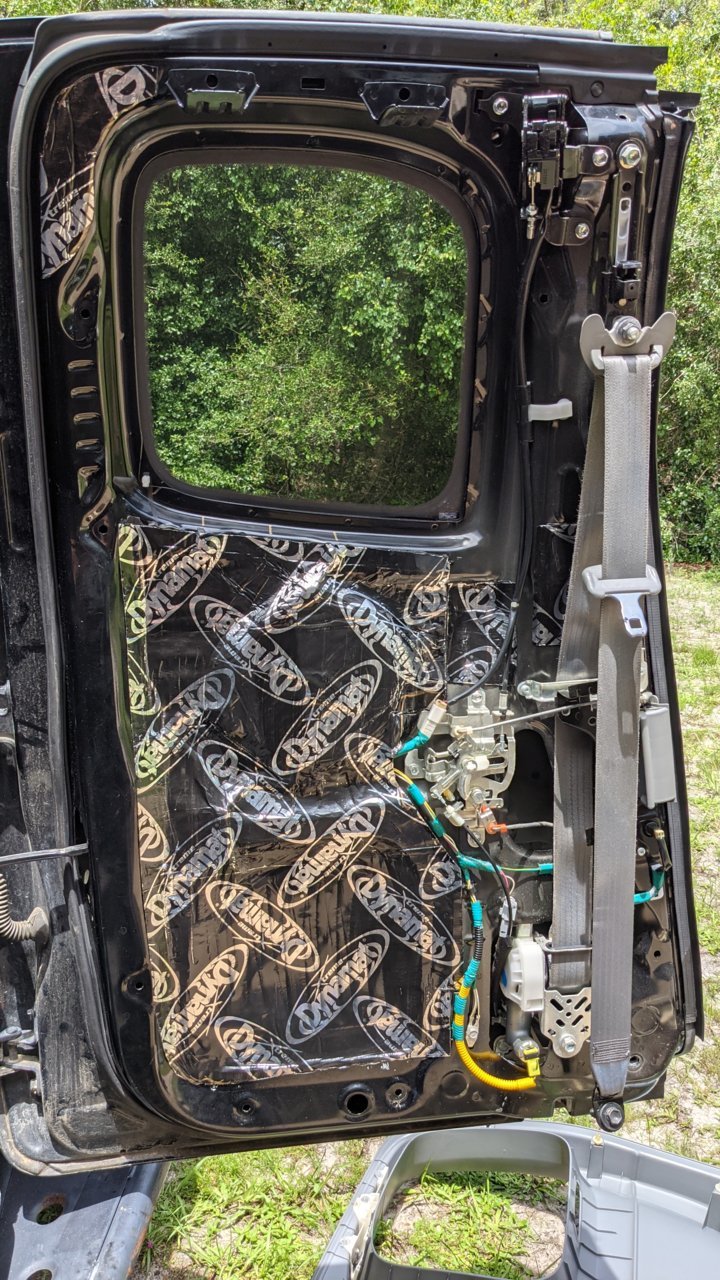

    If you want a quiet truck you got to go all the way.
    All this mess, night and day difference, I was losing my sanity and this allowed me to enjoy riding in the truck without music playing again.
    And yet even still I hear the ticking there's minimum MLV which is what actually cancels sound, this is mainly deadening and I'm still waiting on materials to do the floor which will be more dynapad (MLV) and that should help, I can hear most sound coming into the cab is from the floor now.
    I'm happy but it's still a Toyota, not a Maybach.

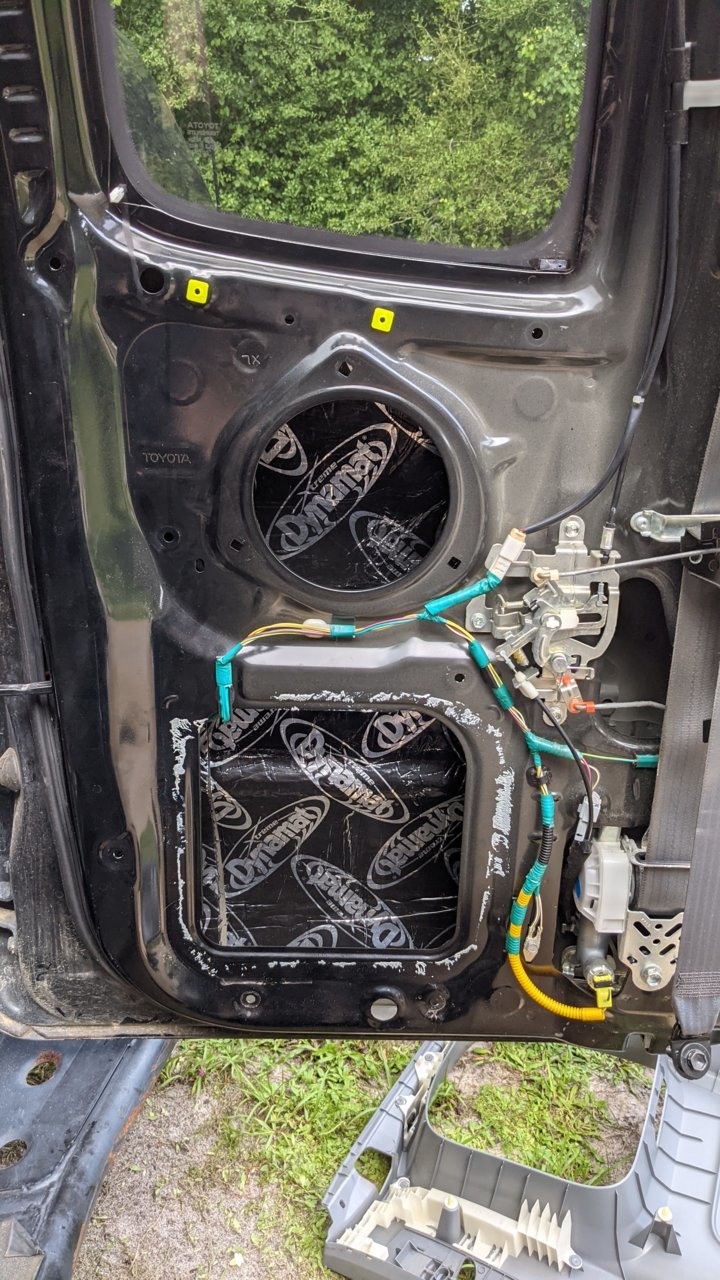

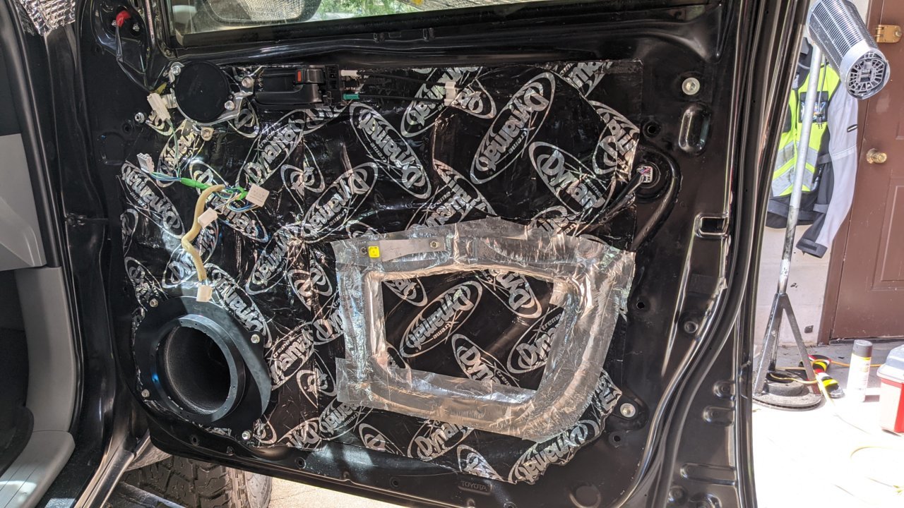

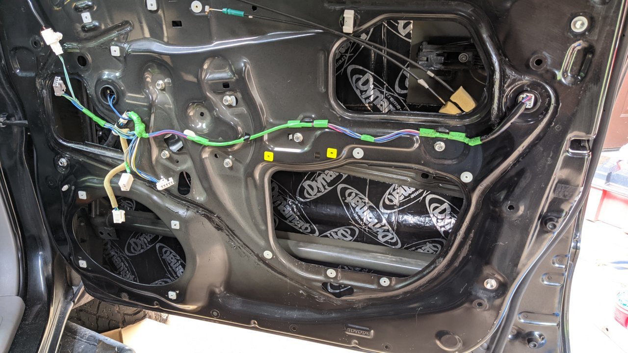

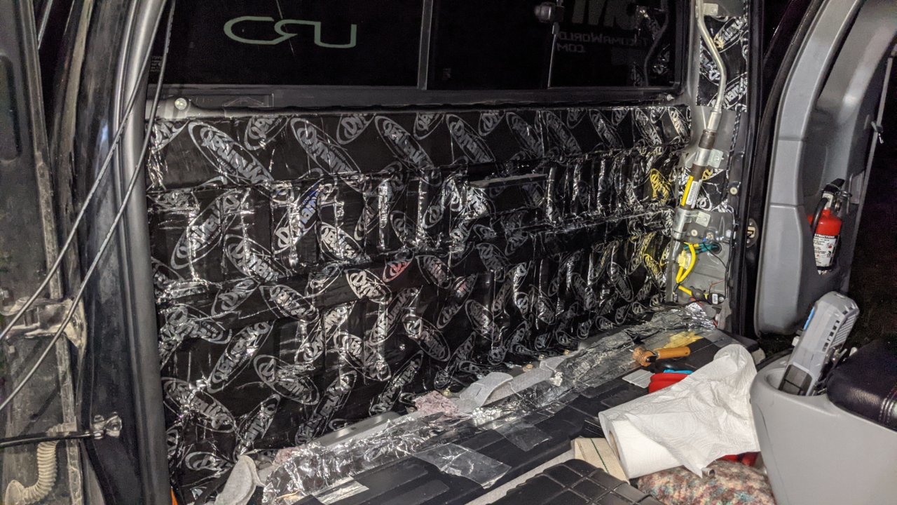

    I have stripped and sound deadened the entire cab. I know it isn't a Lexus, but I would prefer if my passengers also had a comfortable and enjoyable ride.
    Added STP Noise block, a type of thin MLV, as a third later of sound deadening to the rear of the cab.
    Wanted to cover more, but was too lazy to fully take apart the cab again...
    I also installed Kickers CS fronts and KS rears, and the sound deadening really does help to amplify the sound.
    Added open ended speaker baffles to my Kickers speakers to protect it from the elements and help direct sound.
    Also tidied up the wires and some egg crate closed cell foam for the back wave from the speakers.

    I have actually mostly finished this a while back, during the peak of the pandemic. Two layers all around (CLD+CCF) with the rear half of the cab at three layers with the MLV. There is MLV that I want to put in the front half of the truck, but too lazy to take out the carpet again lol. Also after a certain point, it it's just diminishing returns.
    I'm pretty satisfied with the results this far.
