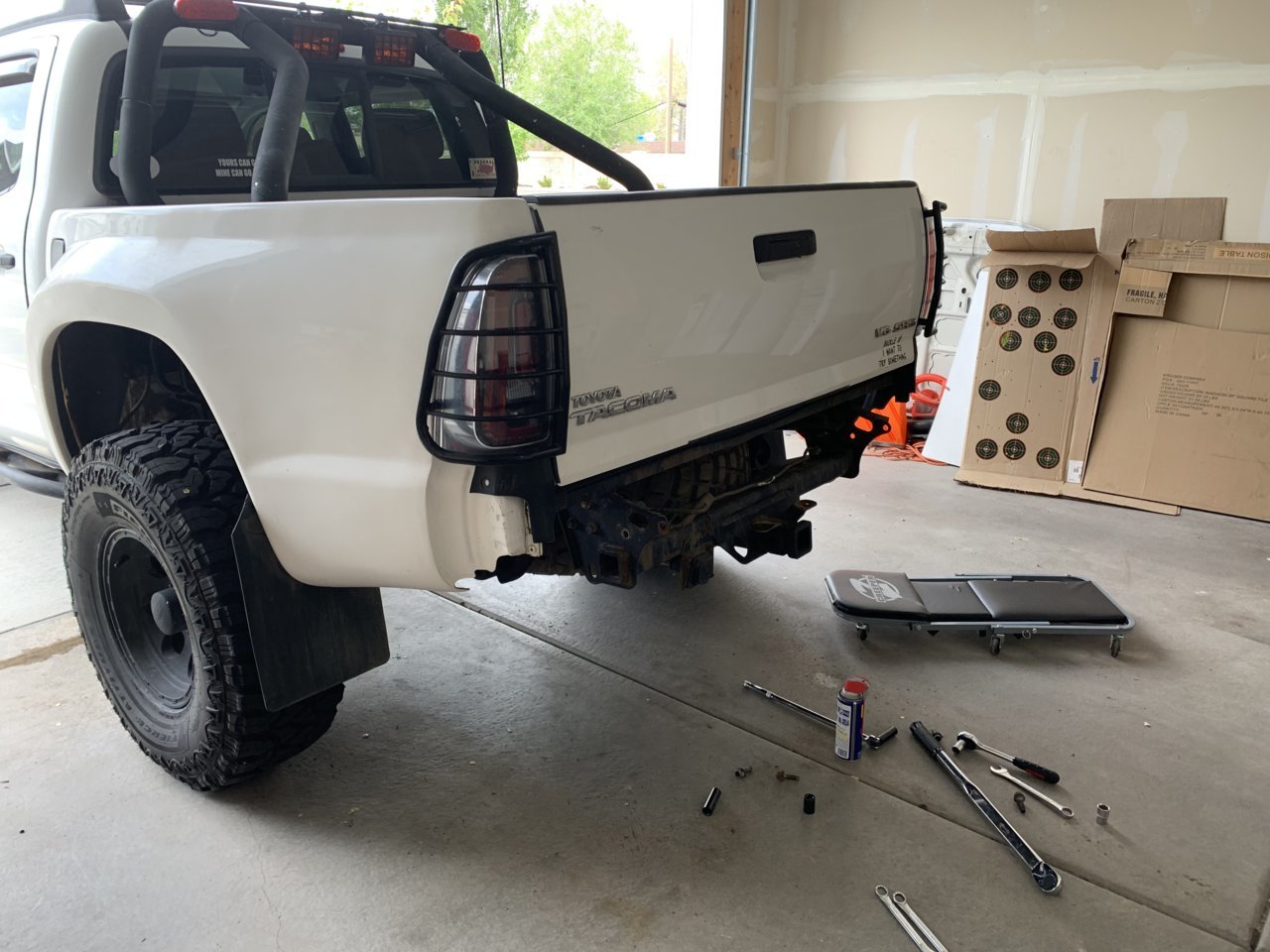

    6 bolts to remove the bumper, hitch stays in place

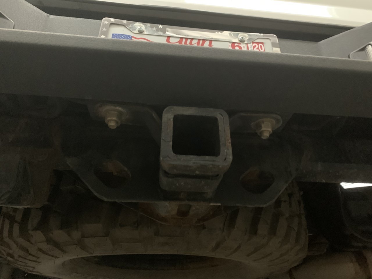

    Does this mount to the bumper reinforcement or the hitch? Both of mine were rusted out so I'm left with the frame and a new Curt hitch on the way. Wondering if I'll need anything elst to mount. It appears the frame is about an inch wider than the bumper mount brackets. Thanks.

    it was a direct replacement for a Tacoma with the standard tow package. 6 bolts in total.

    Oh that's awesome, it bolts where the reinforcement bar would bolt to in the hitch.

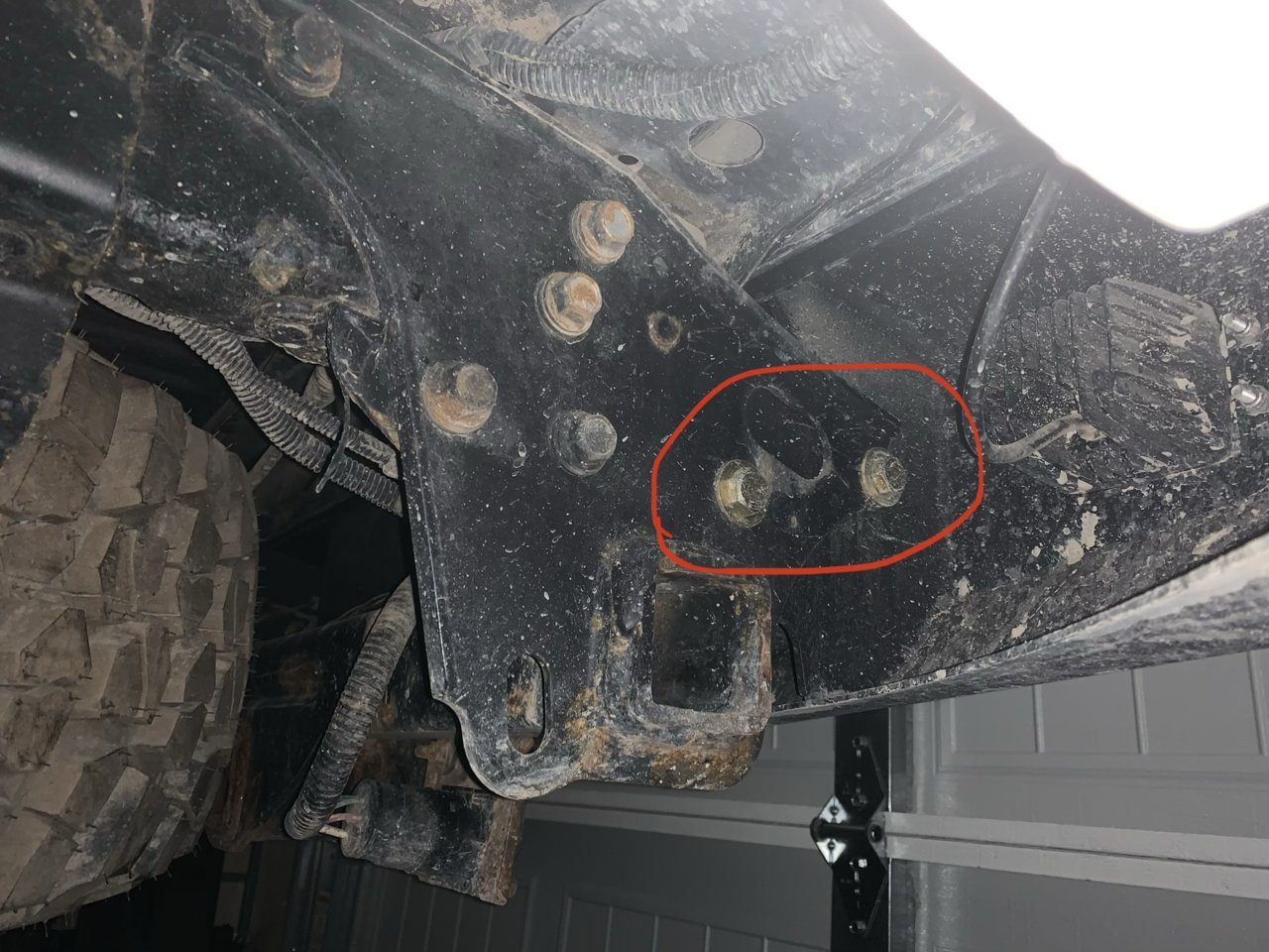

    You ditch the bumper reinforcement. You do need the factory tow hitch, though. Four bolts on the frame and two bolts to the factory hitch.

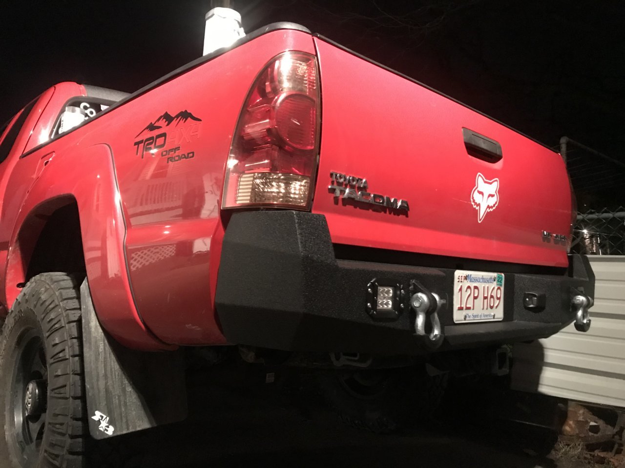

    I know this is an older post but I just got one and wanted to share a pic of it mounted on my 06 turd. I have some minor fitting adjustments to do but I’m fairly happy with it for the most part other than some dings in the powder coating...
