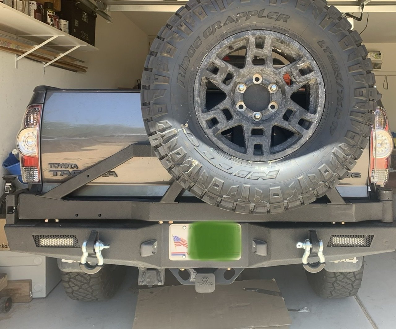

    All valid concerns sir.... its pretty solid though . The swingate comes in 5 pieces and you bolt it together , I felt like problems could arise from this going down a washboard road with an 80 pound spare on the back so I had mine welded together for extra insurance...I also used nylocks on the mount bolts instead of the supplied nuts and lock washers

    The tiregate survived a shakedown test: 50 miles on mogollon rim rd this weekend , no annoying rattles , survived the washboards ruts , held up well....73724C3B-5664-499F-81C7-464B693E6369.jpg

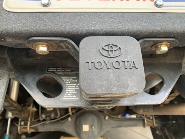

    I was looking to get one of these and emailed several of the sellers on eBay about the factory tow hitch. All of them said it wouldn’t work with the hitch, so I ended up buying a stock replacement rear bumper and painted it to match the truck. I’d rather have had the Hooke road one tbh.

    Mine bolted right on to the factory tow hitch - no problems

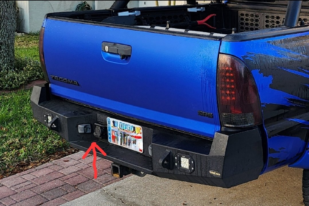

    I've had one for a few years now with no problems. Don't use the d ring points for recovery as I use the hitch and a pintle hook with kinetic rope for that. I also relocated the trailer receptacle to the bumper. Screenshot_20230214_104240_Photo Editor.jpg
