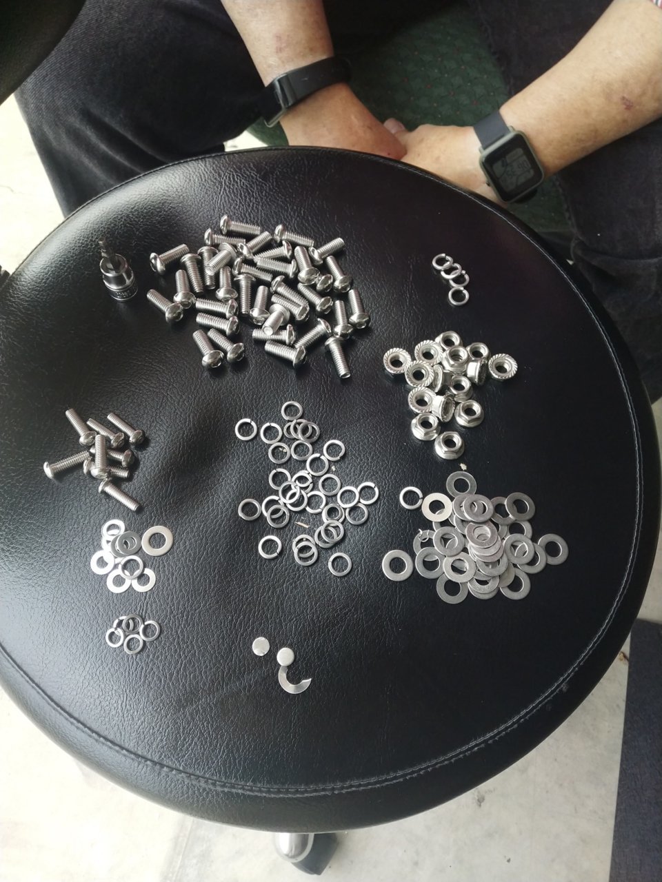

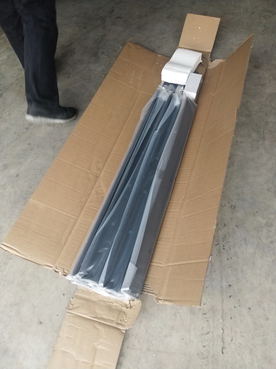

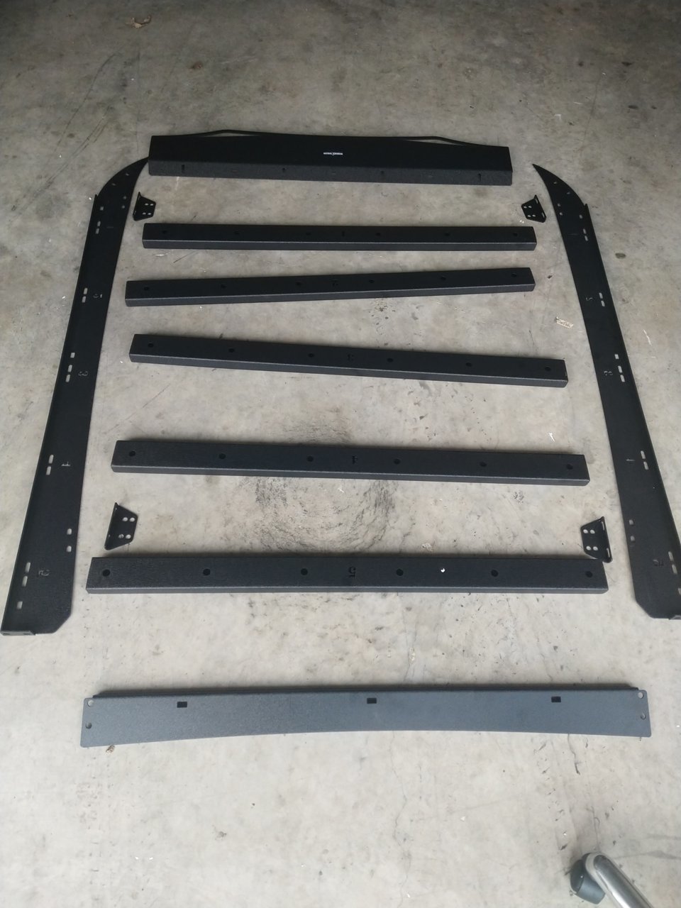

    going to update this post off my phone with photos
    Bought this HOOKE ROAD roof rack
    http://ubox-offroad.com/products/to...ota-tacoma-2005-2019-bxg405?ref=5dde48767b3a4
    Been asked on the FB TW
    On Amazon they claim to be able to hold 350Lbs. the rack holds on 4 location on the roof. there is no T-slots like the other brand. Wind noise is minimal but anything on a roof is going to make noise. This company I think is over seas but ships out of California. Customer service is more of a email thing. There was no direction in the box. I cut the rubber molding on the roof and used some RTV to seal the bolts and molding to the roof. the front needs to add a edge seal so you can make it touch the roof if not the spoiler vibrates and makes crazy noises

    whats the point of the numbers on the side? make sure you know how to count?
    Also, good job on the unboxing pics and video.

    I think like someone on the Facebook said it was a cad file and they made it a cut file probably

    My thoughts exactly..... looks like a prinsu cad file rip off same as the bumpers. too bad they dont have one for an access cab!
