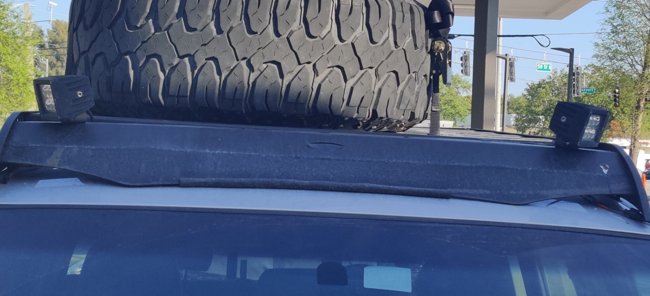

    This rack worked really well for mounting 2x 100 watt solar panels. The panels sit entirely flush with the rack, almost as if they were designed for each other. Just had to use some differently sized spacers because the rack tapers towards the rear.
    Really pleased with the rack so far - installation is straight forward, and it's sturdy. I even managed to repurpose the LED cube lights it came with as tail lights.
    On the downside there is noise at anything over 30mph, I removed the wind shield and replaced it with a light bar but it made no difference. It's a low pitched hum and bearable depending on your tolerance.

    Does anyone have a link to the light bar they used? Should I get a curved or strait light bar? Also the people that left the roof molding how did you do it? Does anyone have pictures of the mounting points with the molding in place.

    Credit goes to @Tpowell707 for pointing me to this light bar on Amazon. It's curved. Puts out a lot of light and one thing I like about it is the curved design acts as both a ditch flood and a forward facing beam so it covers a lot of area.
    I also bought this harness for wiring.
    They also included nice directions for DIY mount in this post.
    I lost one side of my roof molding (lol) so I ended up going bare with no molding.

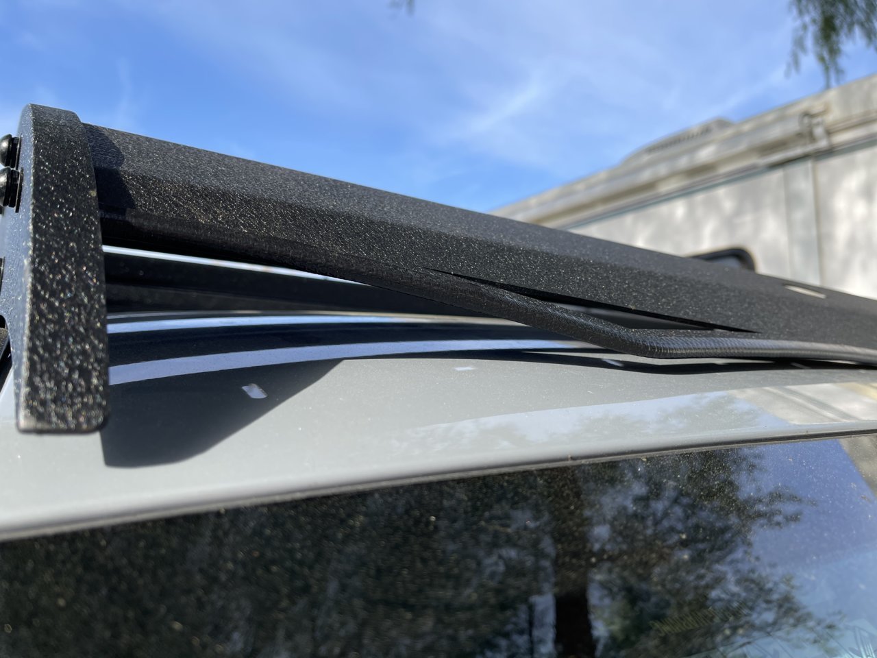

    My left and right sides along the fairing roof edge are 1/4 off. One almost touches the other doesn’t. Has anyone seen this before?
    I’ve unscrewed and disassembled and reassembled the damn thing a hundred times try it to resolve this. Short of pulling the fairing and bending it manually, any suggestions to getting it straight and away from my roof?
