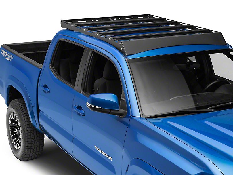

    Looks like they dropped an access cab version!
    Tacoma Access Cab Roof Rack for 2005-2021 Toyota Tacoma Gen 2/3 - Hooke Road
    there are some pretty big differences from the 2021 DC version:
    • The cross bars dont have 3 long holes, this has 5 large rectangular holes with bolt holes in between
    • Wind deflector is a bit different
    • No LED bar cutout on the wind deflector
    • Holes on the side rails
    • Not as slim as the DC version. (3.38in vs. 3.82in)

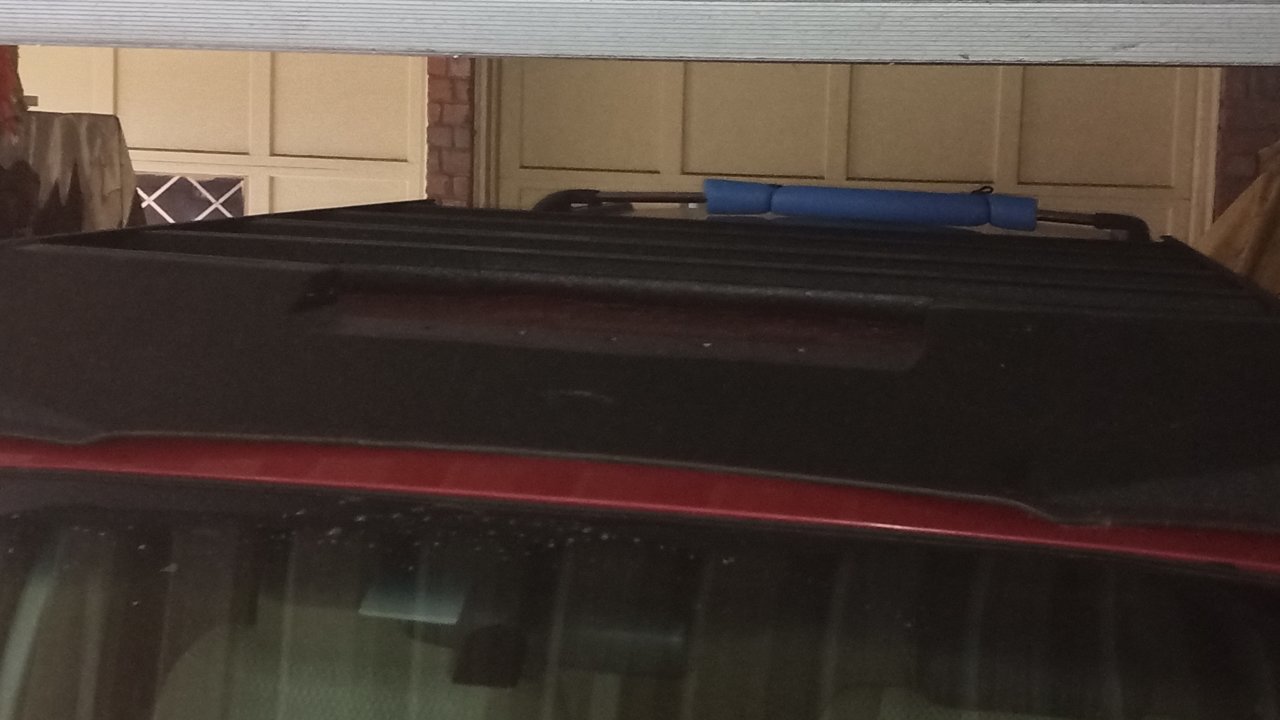

    When saw that video, it clicked in my mind how the Hooke Road rack had almost zero wind noise when I drove to Arizona with my paddle board on top of the truck. We had stuffed half a pool noodle between the rack and the cab of the truck to create padding for the paddle board. (as shown in my picture, further up in this thread)
    Then when the rack is empty, it makes a slight whooshing. Now after seeing your Zombie Slayer video, I am wondering about pushing half a pool noodle all the way under a couple of the crossbars. Sort of like the old pool noodles I used to keep between my Mighty Max truck and the fiberglass camper shell. It tremendously reduced the wind noise in that former application. Testing will commence when the rain stops. If this works well, I will update here in a few days.

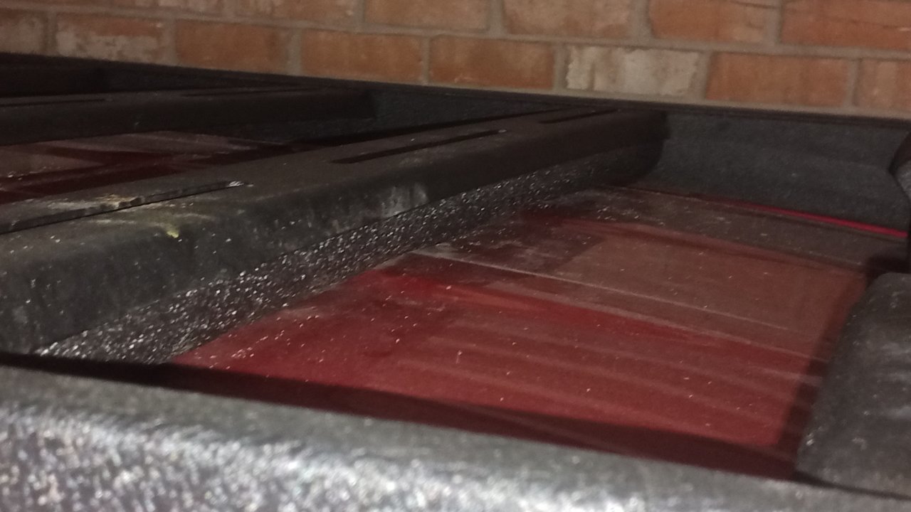

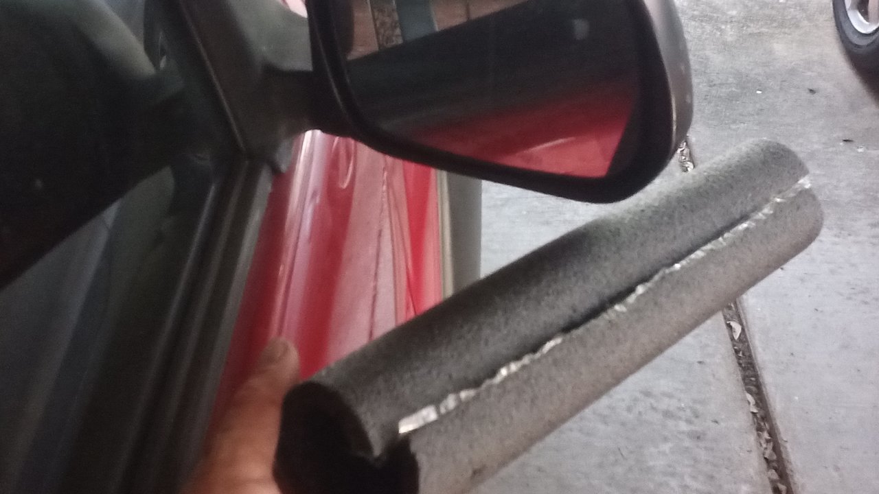

    Pipe insulation is what I used.IMG_20210827_191114_930.jpgIt is fairly invisible there under the second crossbar.
    Seems to block the wind and it is more subtle than a pool noodle.
    IMG_20210827_191222_160.jpgI chose bigger diameter than pool noodles, I think it goes on two-inch pipe.

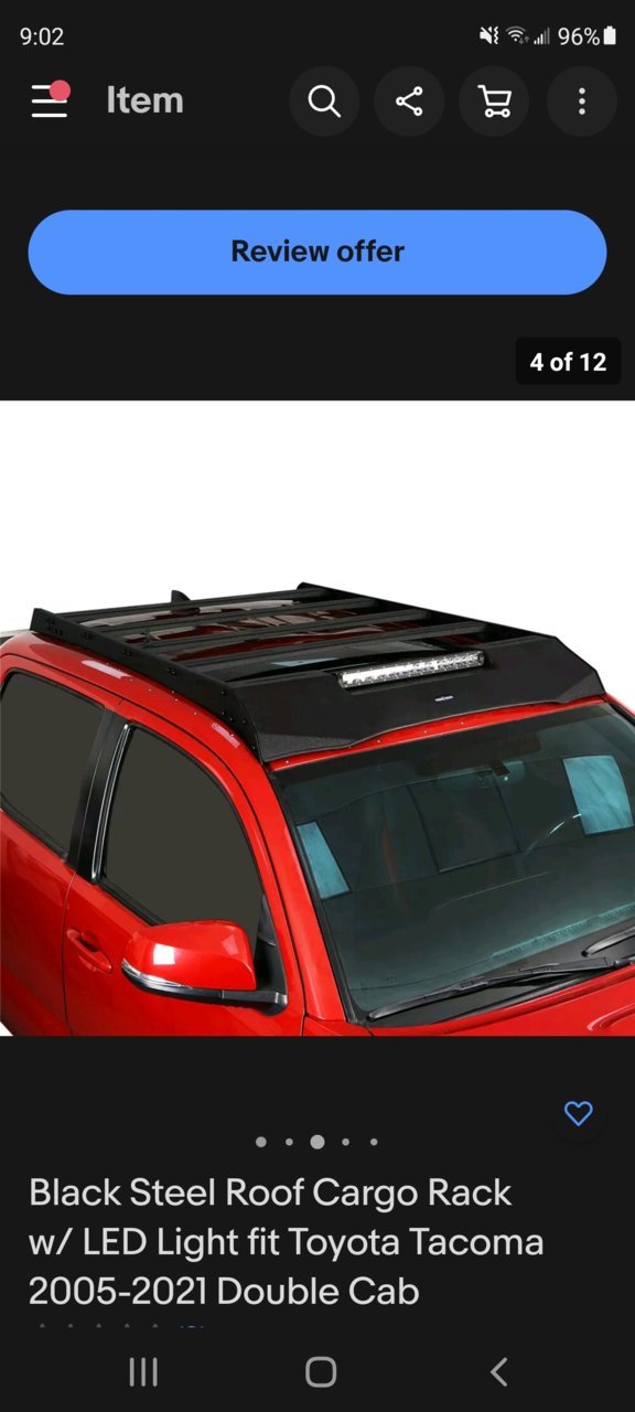

    Is anyone running the hooke road roof rack that has the led bar like in this picture ? If so can you please post some pictures.

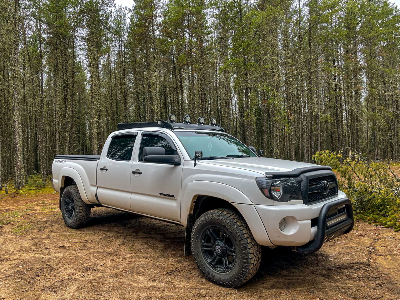

    Love this roof rack. For the price it can’t be beat. I haven’t had it through a winter yet but I’m sure that all the salt on the roads here will cause some issues but I’ll find out soon enough, decided to go with the round pod lights on the front and ended up using the included square lights for ditch and reverse lights. So far I’ve only used it for kayaks but it seems solid enough as I can stand on one cross member and I feel it can hold plenty more. Sorry, I don’t have any up close photos.34A929EE-DC72-4B1C-A44F-0DFEC4AAFCCC.jpg
