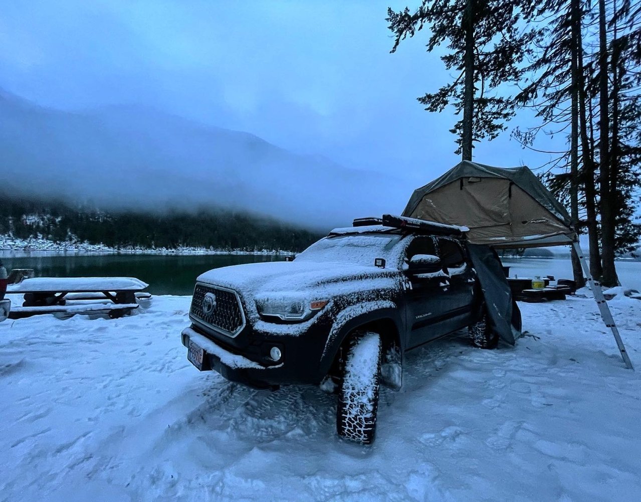

    Update after about a year of ownership.
    for the price you can’t beat it. There are nicer racks out there for sure but for the amount of stuff I actually mount this rack works fine.
    it’s heavy for a rack and the noise isn’t the best but with the rubber strip it was pretty good, although my truck is already pretty load going over 100 KM.
    I mounted a awning ( into the square holes on the side, gun case and then I’ve loaded multiple loads of lumber and all has been good.
    All in all I’d recommend!

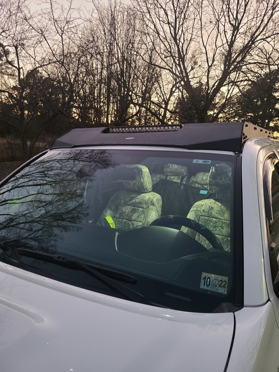

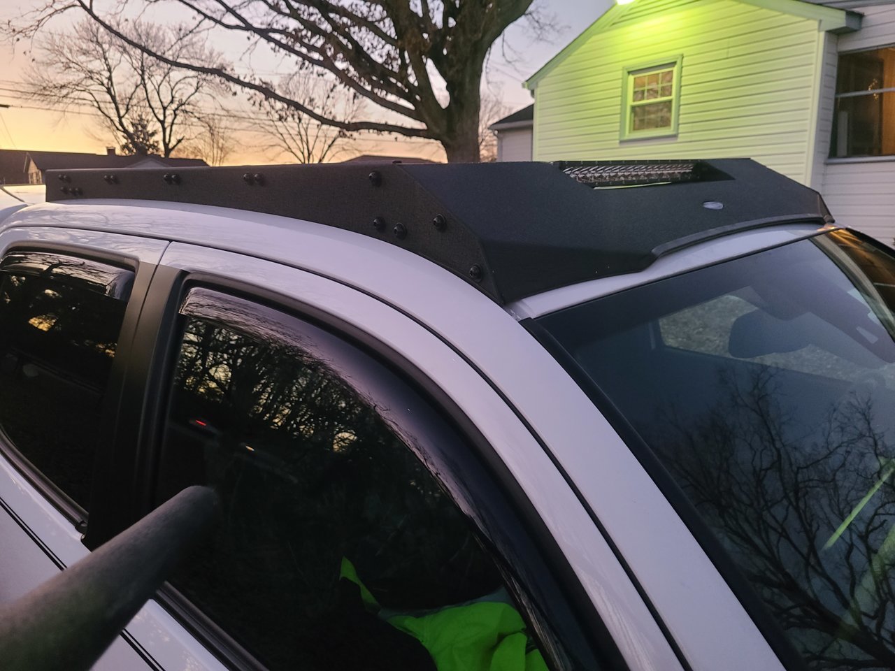

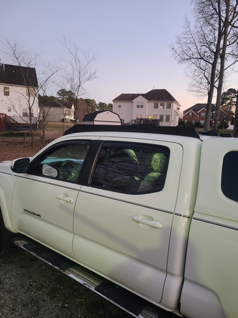

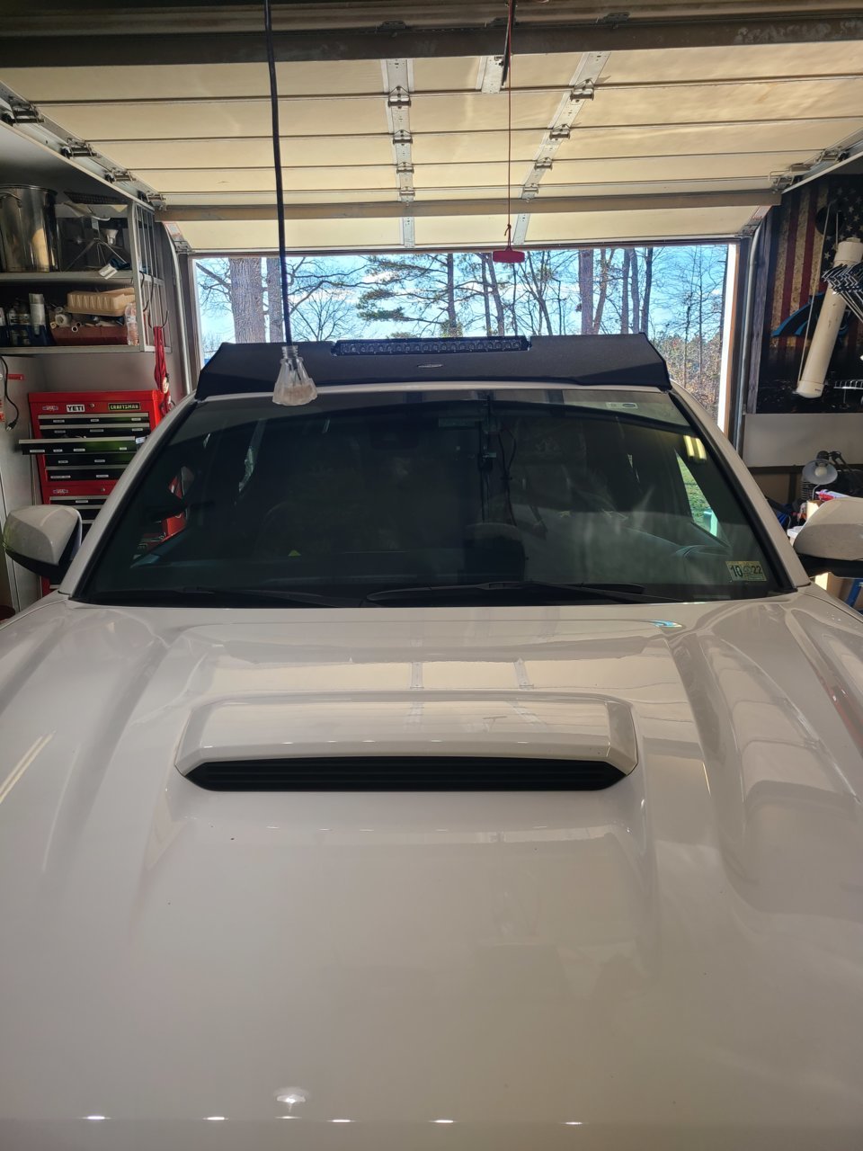

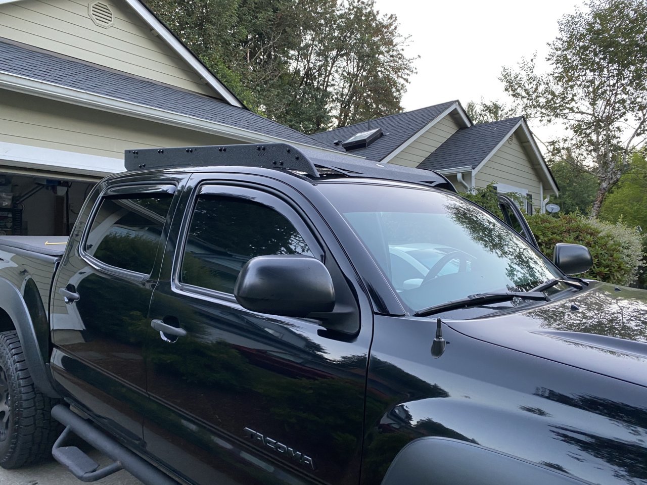

    I bought the new version with the built in light bar about a month ago and just got around to installing it this past weekend. Assembly was pretty simple and straightforward. During my first drive it whistled like a tea kettle at anything over 15mph. I jammed a piece of pipe insulation between the front faring and the roof and that eliminated the whistling. There is some moderate wind noise but it's not unbearable, just turned the radio up a couple notched. So far I'm pretty happy with it.
    20220205_175449.jpg 20220205_175438.jpg 20220205_175430.jpg 20220205_153350.jpg

    How is the road noise with the light bar installed? I took just the front fairing off and the noise got even worse. The humming sounds was quite irritating. I'd hate to buy a light bar and mount it and have a similar scenario as I did with no fairing. Any feedback greatly appreciated.

    do you have any more pictures on how you did the pipe insulation? I have the same rack and did the same thing but still have some whistling going on.

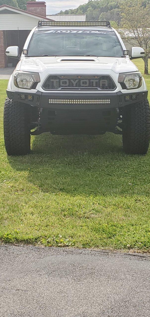

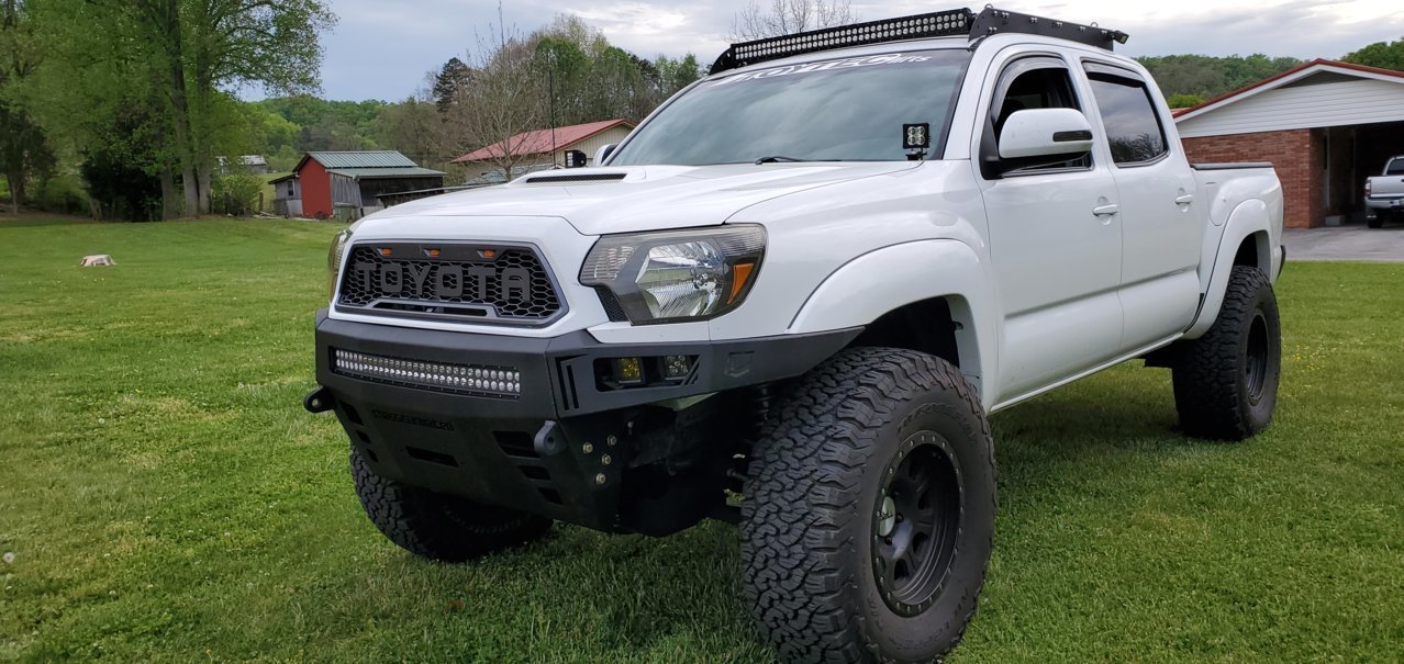

    Mine is way more quiet with light bar then the provided fairing. I tried the bulb seal on the fairing and it didn't do much but rub my paint. I did have to adjust the light bar down a little further than i would like to reduce the noise.

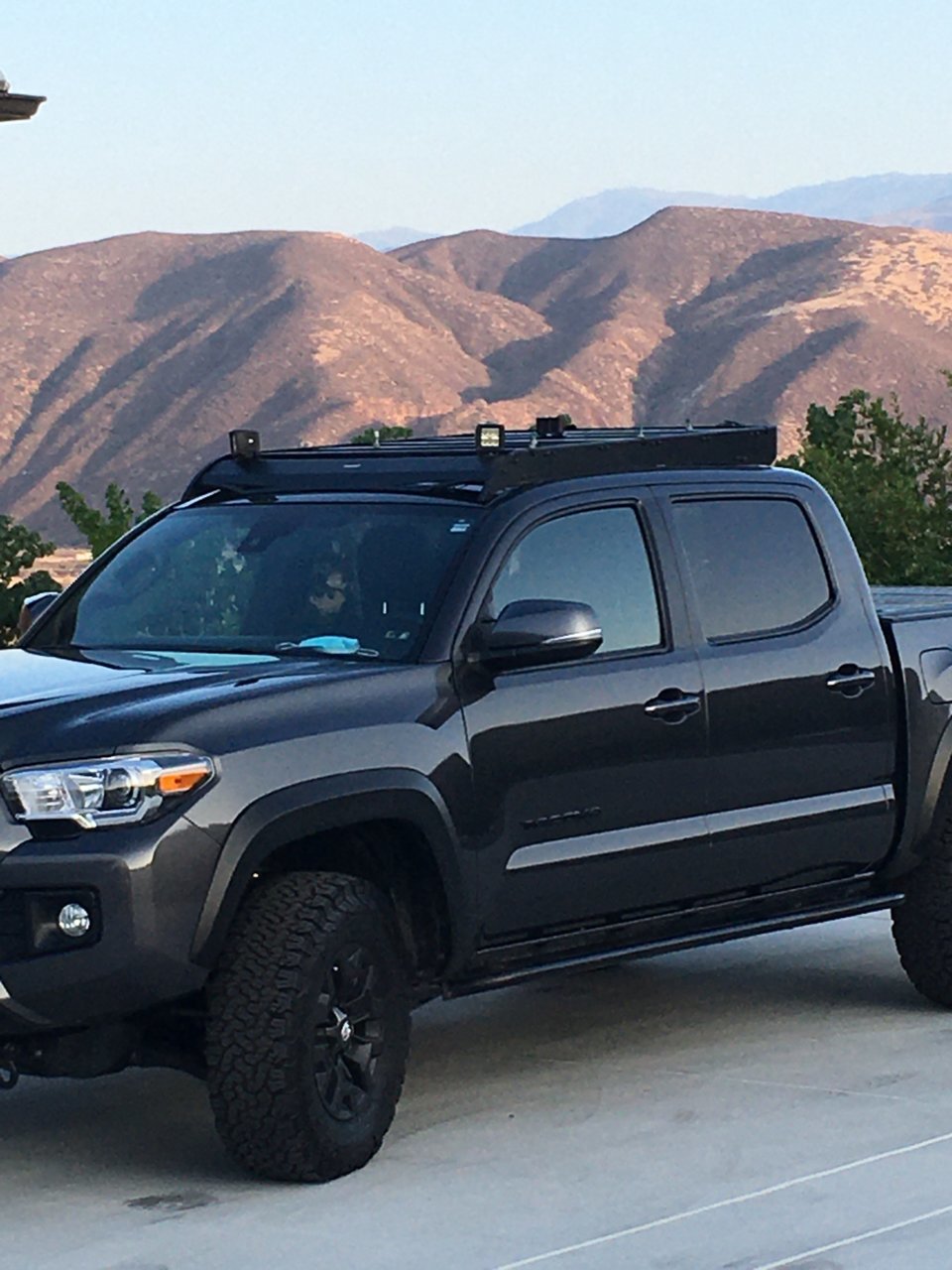

    Just installed the one that comes with the 4 light pods. Install was easy. I’ll probably wire up the lights later. I was on the freeway today and the noise wasn’t as bad as I was expecting.
