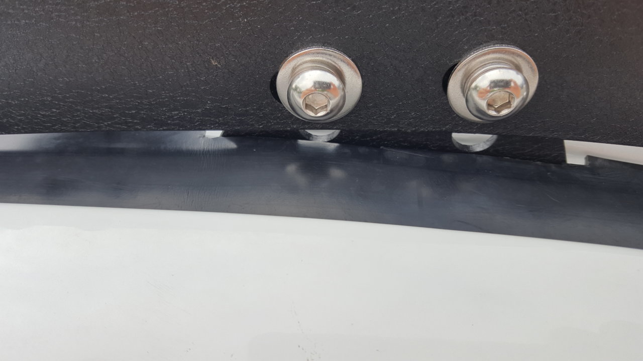

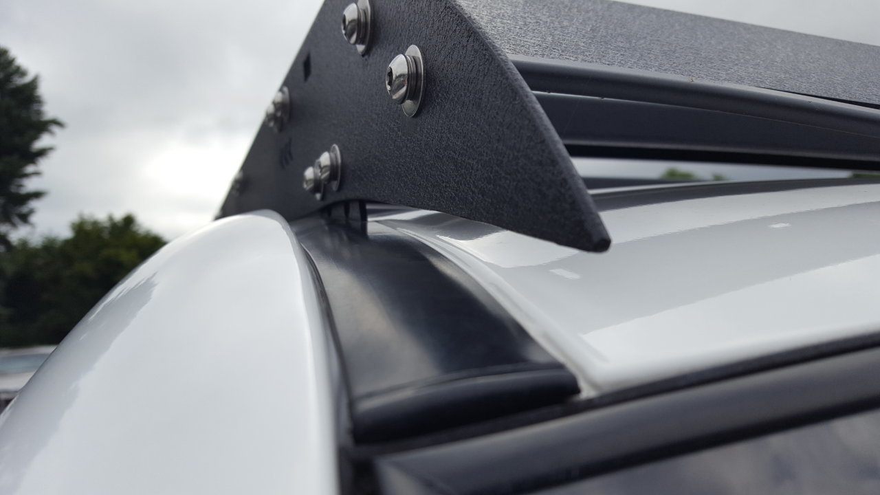

    I notched around the mounts.

    Can someone post a close up of the weather stripping and how you mounted this rack?

    Thanks / I’m looking for a pick of how you drilled or removed the weather stripping when you attached the Hooke rack

    Does anyone have a close up picture of how they mount it ? I really want to keep the molding. Are you guys drilling through or cutting around?

    I agree, a close up picture of how you guys mounted your rack with the molding would be appreciated :thumbsup:

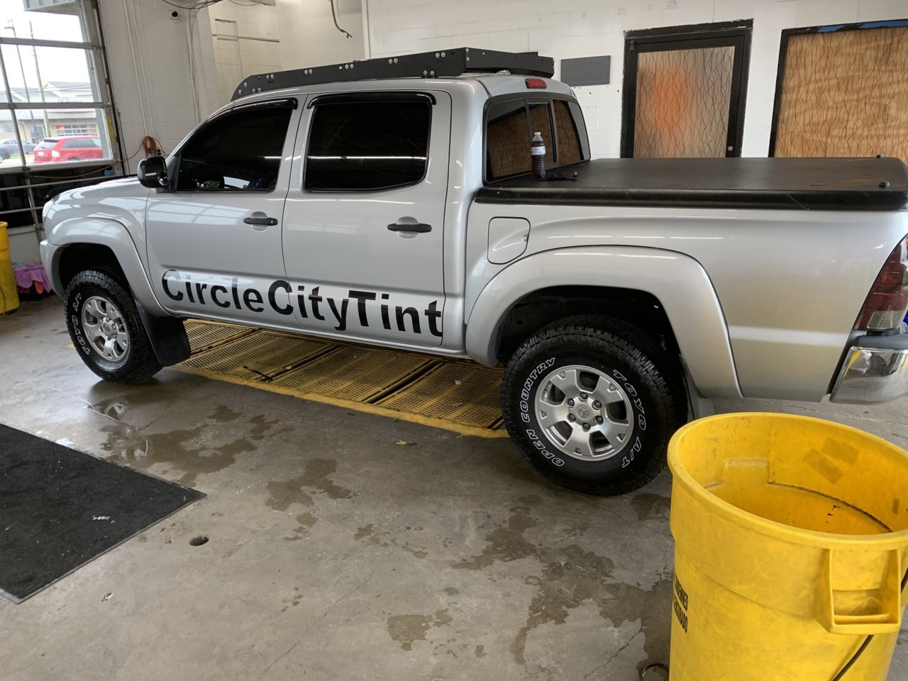

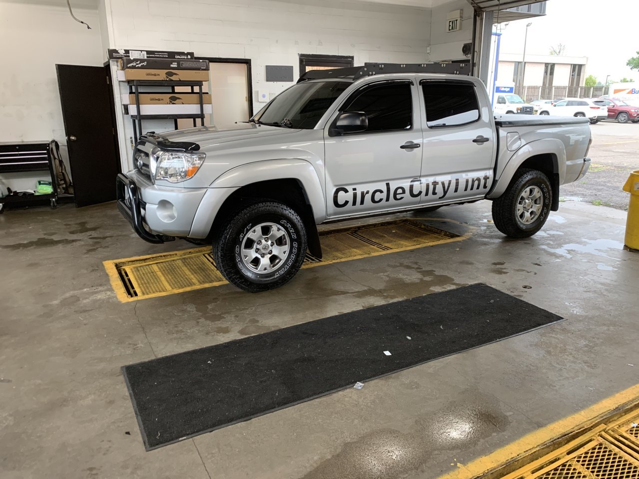

    I just took off the rails. When I bought my truck, one of the rails was already missing but the rack is freaking sweet!!!!! A little windy but overall pretty badass! Couldn’t get myself to spend the money on a prinsu.

    hope this helps, I notched around the mount and had to remove some of the underside of the strip to get it to fit properly.

    Thank you, I'm gonna do exactly the same. Ok I'm sold ordering one tonight.
