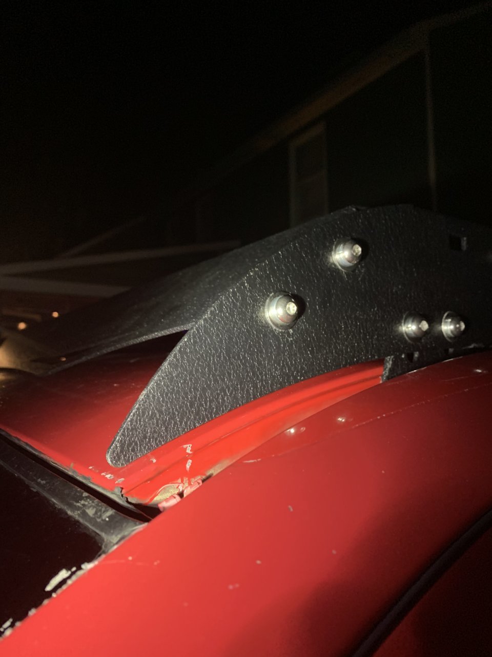

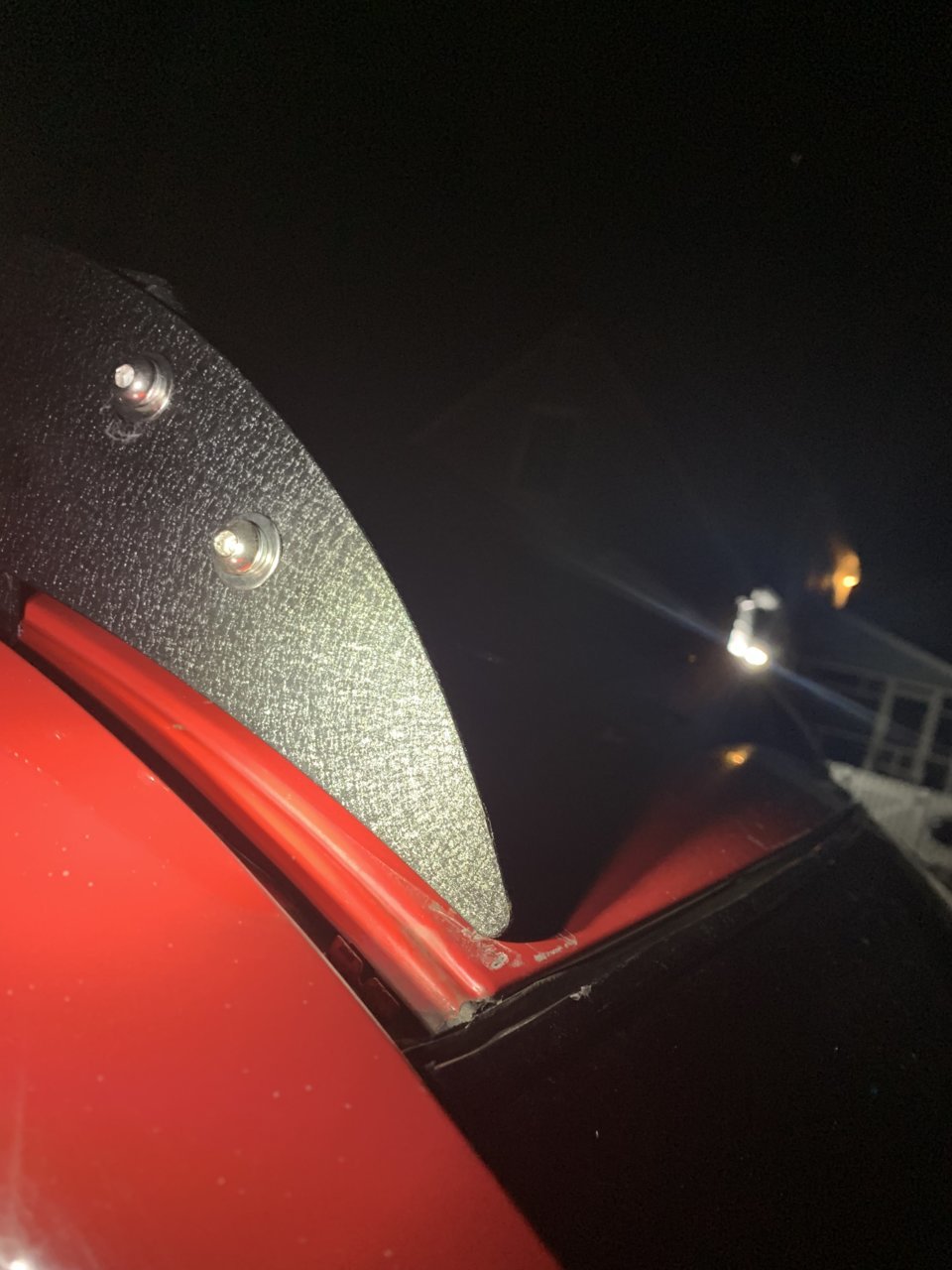

    The front of mine is wayyy too close to the cab. Not sure why some of yours has about a half inch gap between the cab and rack.
    Do the brackets that bolt to the cab side front to back specific?

    Are those scratches from the rack?

    No....that was already there when I had wires running down either side from a lightbar

    I was wondering the same thing when I installed mine. Mine were touching the cab using any combination of the holes so I removed the side rails and re-profiled them with a grinder and repainted.

    That's so weird...so some touch and some do not....

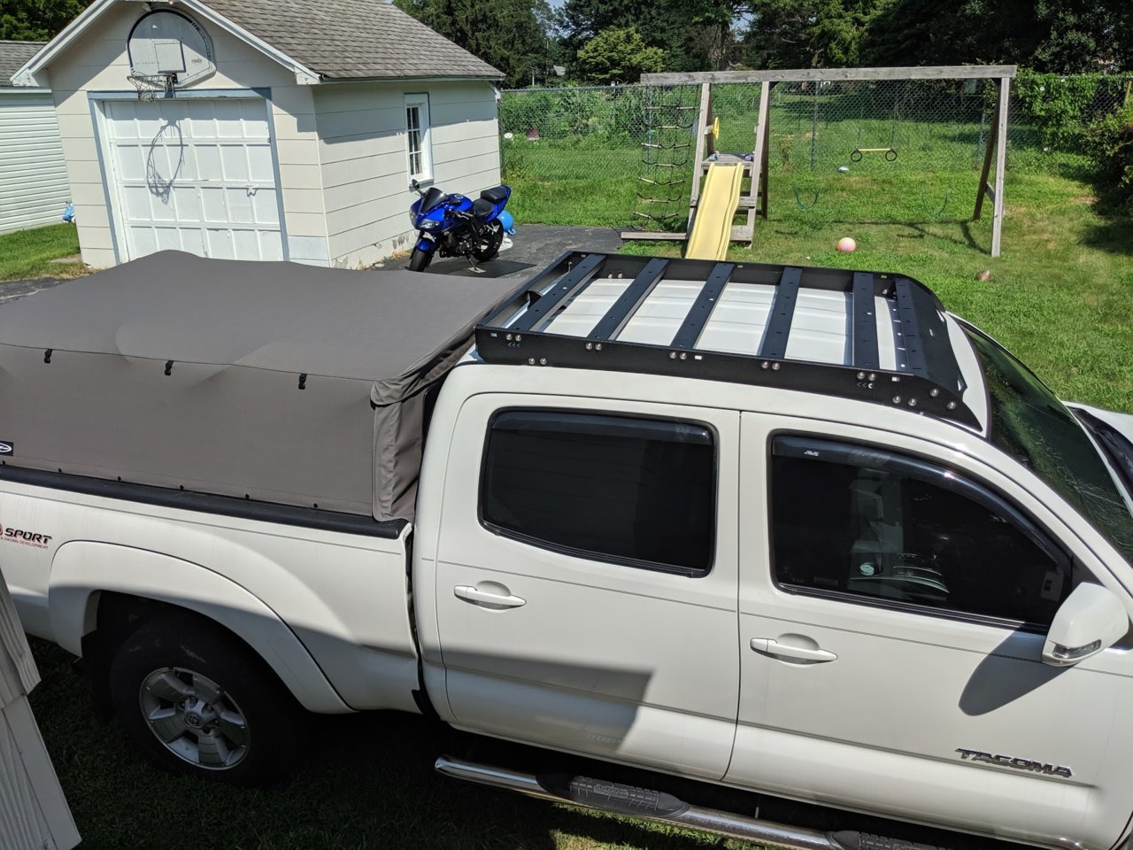

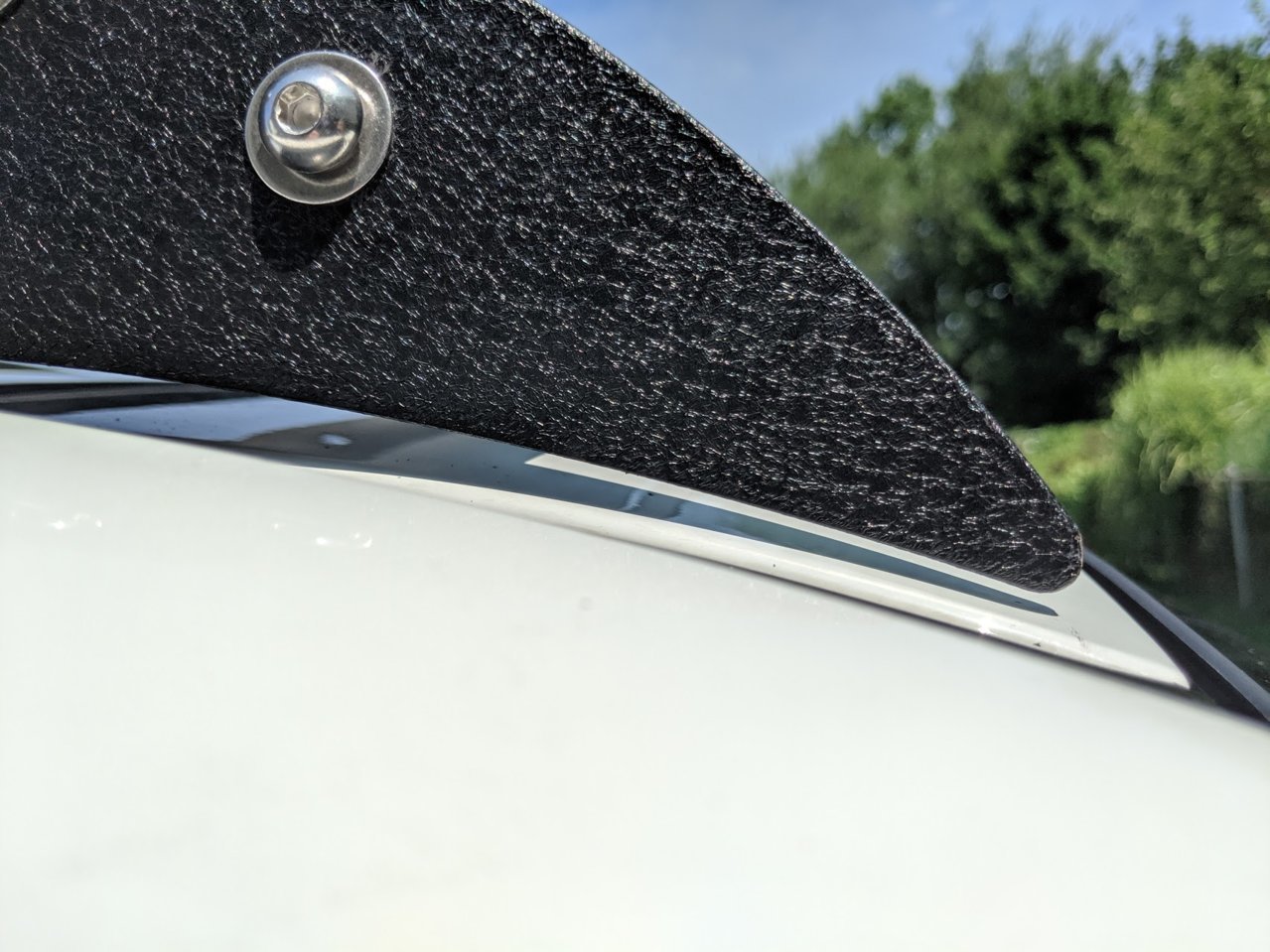

    Did you try putting it in the bottom holes in the back and top holes in front? Thats what i had to do and it came out like this.
    I think i would do that before i would start grinding.

    i was touching on the front with both front and rear in the upper holes, this was my only other thought other than washers. If i did it all over again i would have put 3 5/16" washers under every bracket hole.
