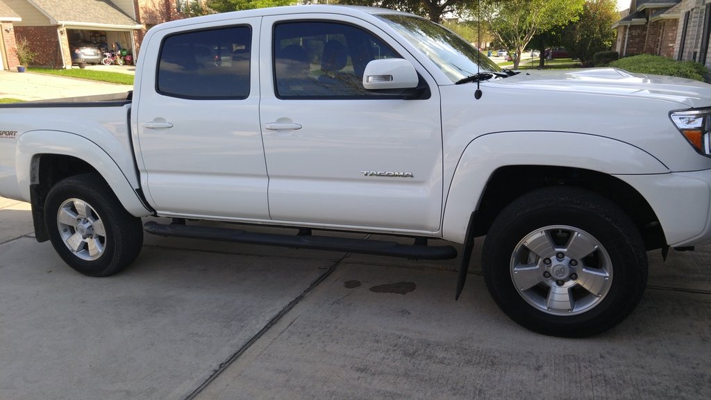

    I bought this 2015 DCSB Prerunner after my last truck was stolen. Got about 23k miles on her. Since I'm used to buying my cars with 100k+ already on them and 8-15 years old, this felt essentially like a new vehicle to me. Love it!
    Pic as purchased:

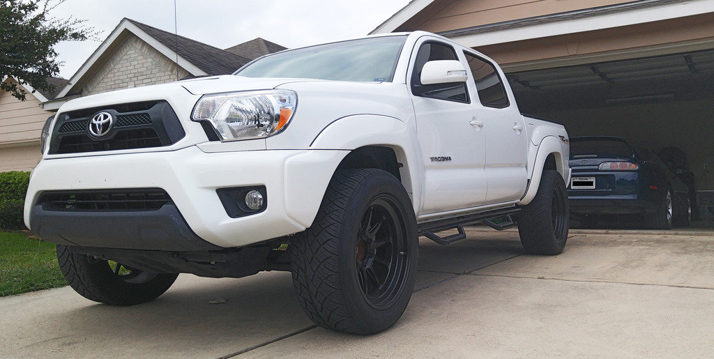

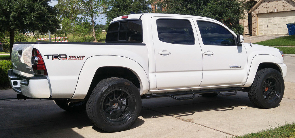

    I removed the mudflaps, replaced the side steps with Nfabs, and got a new wheel/tire setup first:
    Not perfectly clean in these photos neither are they professional but I needed a few of the new setup!
    The wheels are 20x10 -18 Fuel Formulas, and the tires are 285/50 Nitto 420S. These are awesome street tires made in a lot of truck sizes.
    They only make wider (265+) sizes that are of approximate OEM height for wheels 20" and up which made my wheel choice difficult. I had to find 20" wheels that I thought looked good on a tacoma. I am not a fan of most truck wheels cause of all the blingy chrome accents, fake beadlock looks.
    I was happy to find these wheels cause not only does the step-lip keep them from looking too big like a lot of 20s do on tacomas, but they are pretty low-key. The -18 offset makes them a little too aggressive for my taste in terms of poke (+0 or so would have been better), but I had to take what I could find. These were discontinued and had been for a few years so it took me about a month of contacting wheel suppliers to find the last set in the US in a 20" size. Maybe some of the aftermarket flared fenders would keep them looking tucked in a bit, but they're expensive. Maybe later.. I need to fab up some TRD centercaps for these, the Fuel ones are awful looking. Running none right now

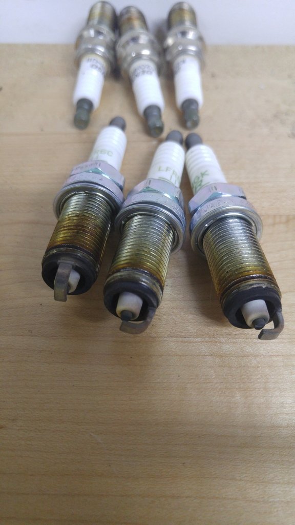

    Didn't get around to posting it, and didn't take much pics (boring job - not really a mod) but did some maintenance this weekend as well.
    Did a full trans flush with Amsoil ATF, swapped the diff fluid for some Amsoil Severe Gear, Changed the engine oil (I use M1 in everything), and swapped my plugs.
    The plugs were the interesting bit. They were a little more toasty than I expected at 30K miles....\
    Does this look normal? Only thing I can think of is I did run a full bottle of seafoam through it about 3k miles ago.
    Anyway, replaced with OEM spec Denso's. So weird how Toyota mixes plugs left/right bank...

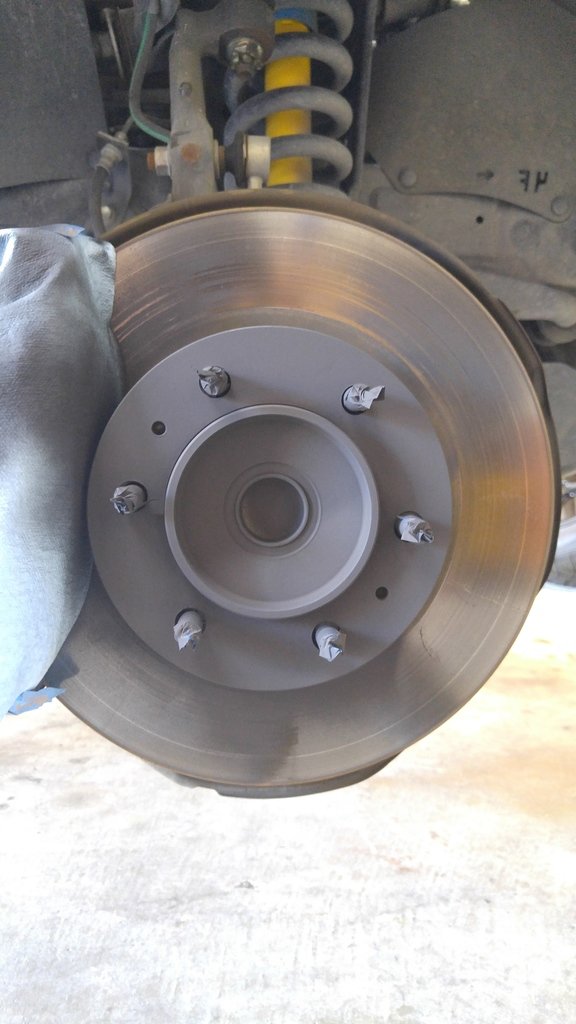

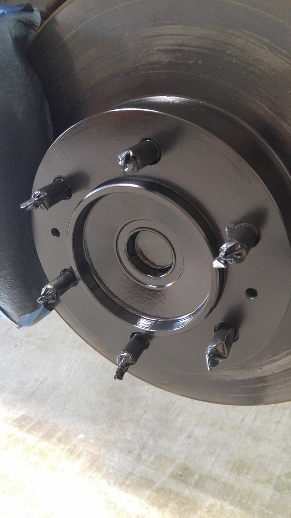

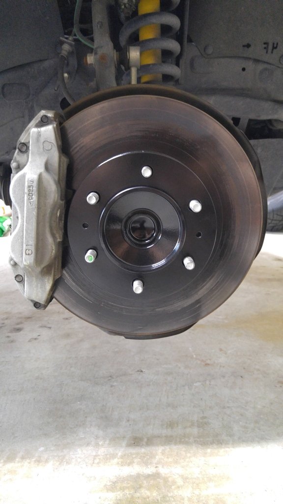

    Haven't had time to get the pics off my phone and hosted, but I got some more fun stuff this week done.
    Painted the hubs, rotor hats, and my rear drums a gloss black. Paint looks to be holding up so far. Used 1 coat of VHT before the gloss paint.

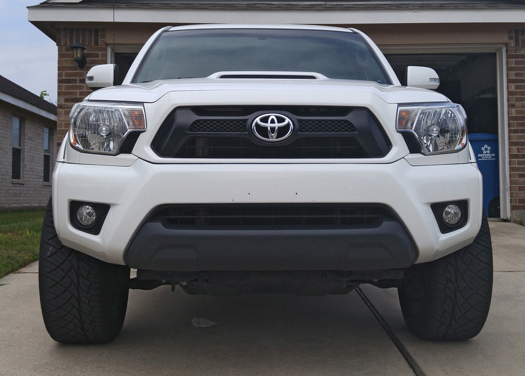

    All my LEDs showed up, pretty much everything interior and exterior besides actual headlight/highbeam bulbs and fogs. Pretty excited. All I got installed so far was the license plate lights cause they're easy. Still deciding on fogs. For the headlights, I received my harness from RallyLights in order to run some high power bulbs I got from susquehanna (?) motorsports. So all that will be going in sometime this week.
    Also, did my Homer grill. Took WAY longer than I thought it would but I'm pretty OCD about that stuff. I have yet to do the bottom part I will probably get to that next week. Also I'm going to paint the bottom plastic trim that goes int he center of the bumper to a smooth gloss black once I sand down the textured finish.

    Finally off work again this week so got some time to upload my pics. Will be doing some more work on it this week but for now let's play catch-up.

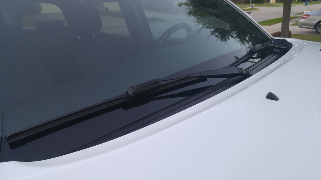

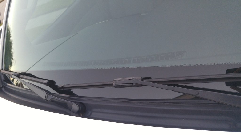

    Got some nice new rainx wiper blades. This is a small mod that actually is very pleasing and it DID improve the looks of the truck by removing the ugly spider-like faded black metal wipers with clean blade that isn't faded.

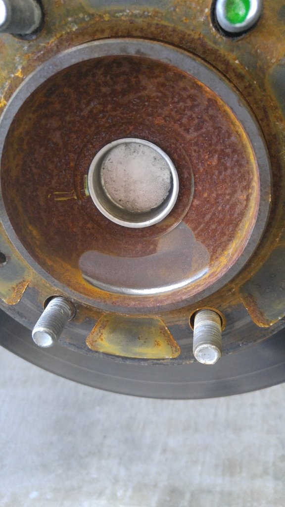

    Next I went and painted my hubs. I ended up taking it a step further and doing the entire rotor hat and rear drums as well. They turned out really well and the paint on the rotors/drums has withstood the heat so far. I used 1 coat of VHT then a few coats of gloss on top. I used a dremel with a small cone wire brush attachment to clean up all the rust and stuff. Took quite a while but I'm happy with them. Might not even do centercaps now.

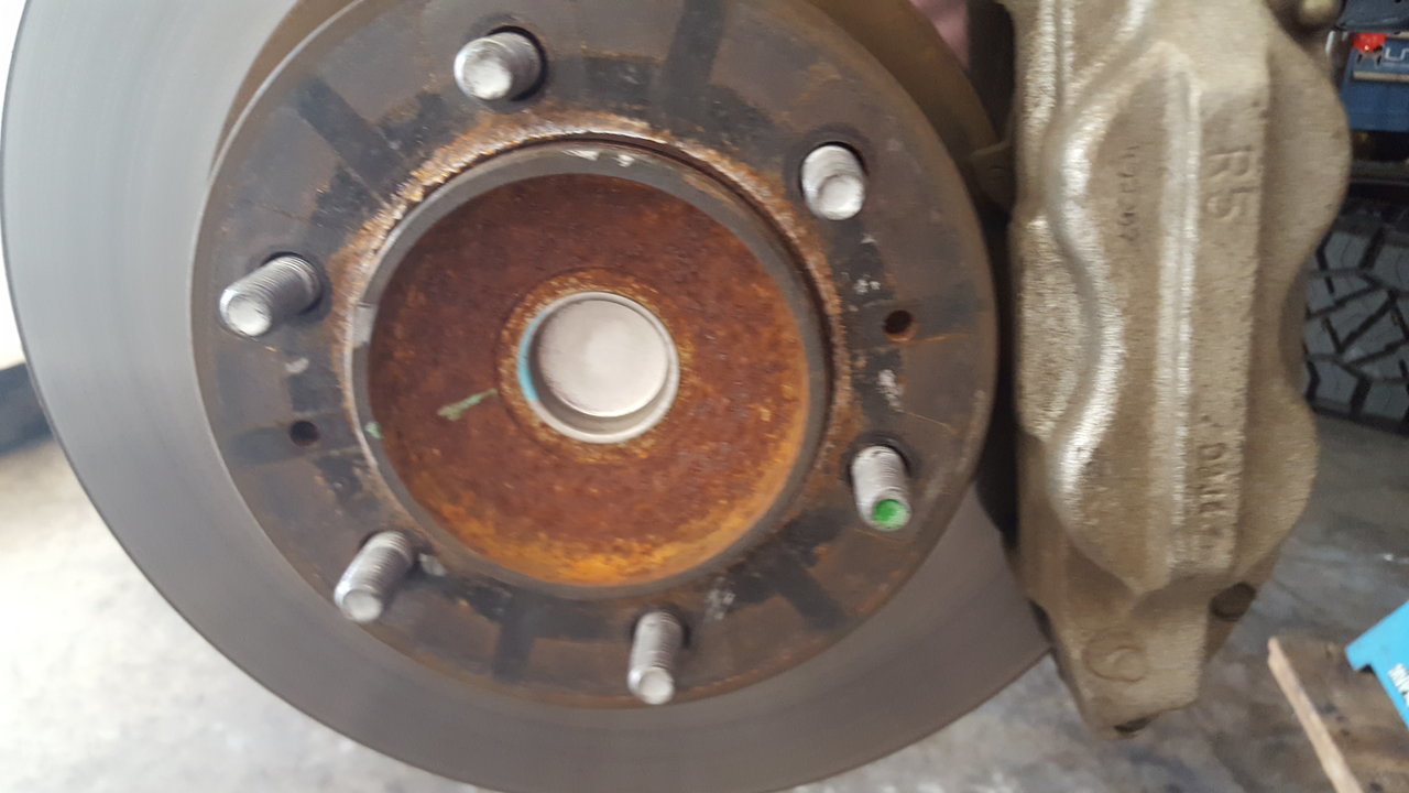

    Before:
    Cleanup:
    Prepped & Ready:
    VHT Coat:
    Finished:
