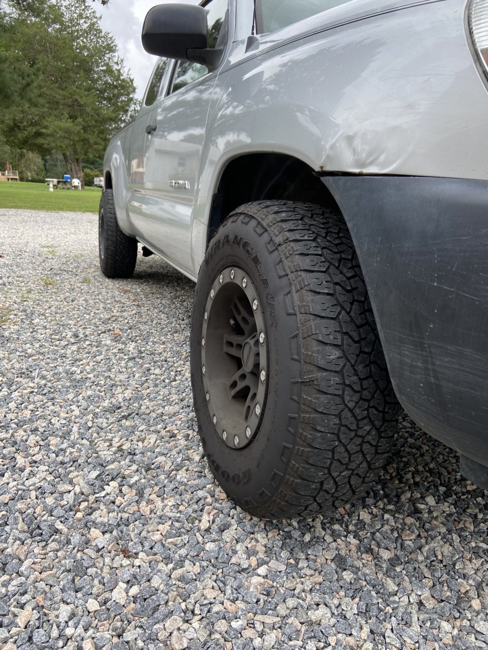

    I’ll have to look into prices and some installation videos for it. I’m about to put a 3” lift on the 4 banger. The shop says I’ll most likely have to re gear anything over 2.5” BUT I think I’m gonna wait just to see how it runs. I will say, I’m taking rather long road trip up towards the blue ridge in VA. (About 2.5-3 hours + hills and travel when I get there) is that risky to do with a new stance on my truck?

    she sits a little low and is already comparable to :turtleride:

    Regearing is for when you get bigger tires, not after you lift.
