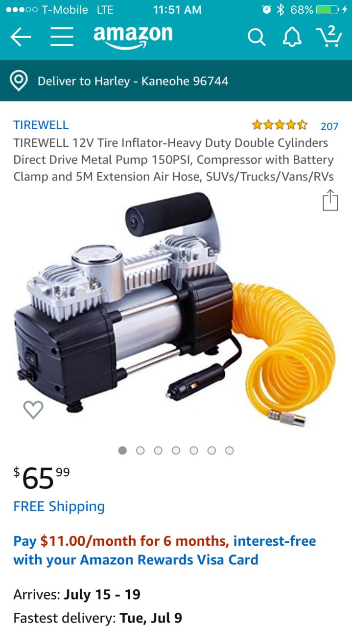

    is an ARB onboard compressor really worth the money or will a cheaper one off Amazon work fine?
    Compressor will be used for tires as well as pressurizing a 6 gallon water tank eventually

    I would recommend the viair pumps

    I have this one. It is fine but look at that tire stem connection in the picture. You have to screw it on and off. The threads are fine so it takes a lot of turns. There is no press connect like filling stations use. Just an FYI

    The viair is threaded also, but it is not difficult to get on or off

    Depends on how much you use it, but I love my ARB. Viair makes good stuff as well.

    Its great if you are looking for true on board air, but even the viair can be mounted under the hood or in the cab.

    FWIW if running tires bigger than 265/70 or 265/75's I would go with something bigger than the 88p Like the 300 or 400 model. 88p works great for me but gets super hot and takes a fair amount of time inflating my 265/70/17s. Anything bigger than that would be a bit of a struggle and warrant the upgrade.

    Agreed, 33's are about as far as you want to take the 88 model.

    Shoot. Maybe I'll just suck it up and go to the ARB single tank compressor kit
