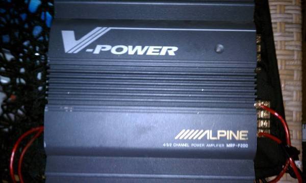

    I have my amp and 8" sub from my car I just sold and want to put it in my Tacoma which still has the stock radio. I just want to make sure I have everything ready before I tear into it.
    I know I have all the power (fused), ground, speaker wire and the tools to do everything.
    Here is my amp..
    http://www.tacomaworld.com/gallery/showphoto.php/photo/203895/cat/500/ppuser/49989
    What is best way to hook it up to factory radio? With one of these... http://www.scosche.com/car-audio/product/994
    And should I tap into rear speakers for it? Where should I tap into them, up where they plug into radio or wires that plug into speakers in rear doors?

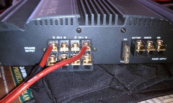

    Two ways of doing this...
    First: See the plug on the right side of the photo? That's a speaker level input plug, meaning you run wires from your stock head unit directly into that plug, then run wires out and back up to your head unit going to the speakers (quick and easy, but not necessarily the best way). Do this if you don't plan on replacing your stock head unit.
    Second: If you plan on replacing the stock unit, or if you've lost the speaker input plug, do as Italyn stated and hook up the adaptor by the radio and run RCA's to the amp

    Know anywhere to get a speaker input plug??? Amp was in my car when I bought it so I didnt get it new. I tried google and ebay and didnt get anything. I searched for... alpine mrp-f200 speaker level input harness.
    I also do plan on keeping the stock HU as long as I can
    All the speakers in the truck are stock at this point but hoping next summer to upgrade those, so Im guessing if I can get a line-in plug that would be the best way to install amp and help in the future?
    Thanks

    yup.... those harnesses are specific to alpine, not to the amp (thankfully)
    actually it might fit another brand, but better to stick the alpine in the search just to make sure
