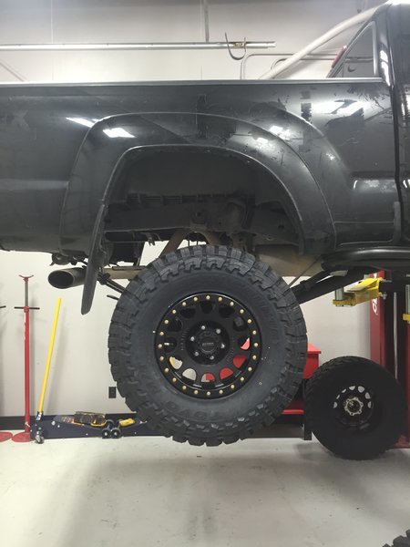

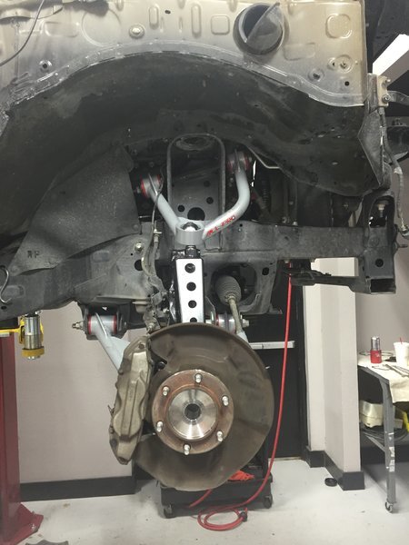

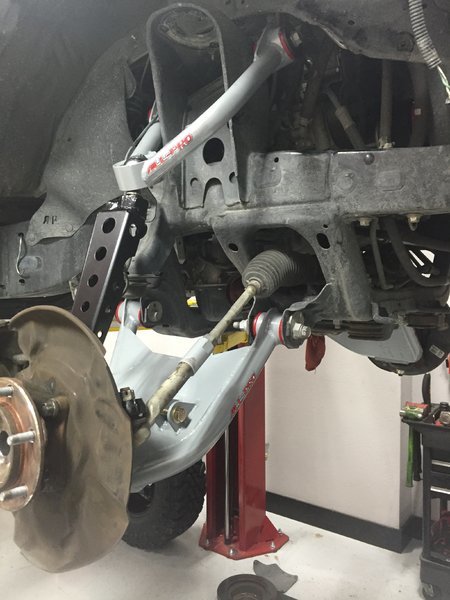

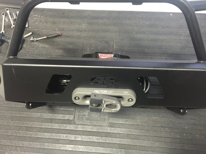

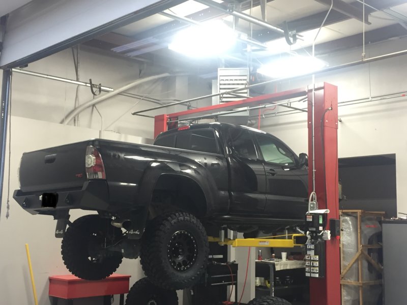

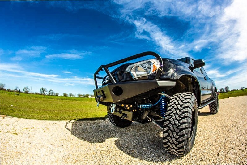

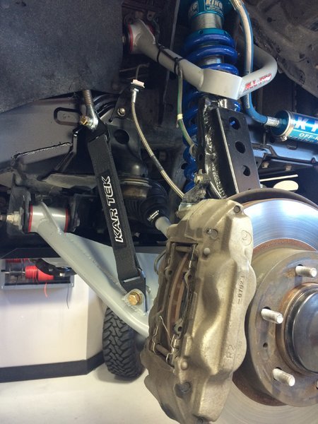

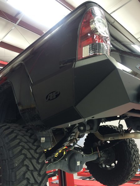

    Update
    Droop for days.......
    LT kit is on. In the process found out one of my front axels needed to be repaired so thats getting done.
    Bumper ready to get thrown on and wired up.
    All that is left to do is the cab mount chop, and install the shocks. FINALLY got a shipping confirmation from King, they arrive monday by noon. Should be on the road by monday late afternoon.

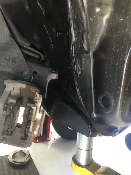

    2012 Tacoma

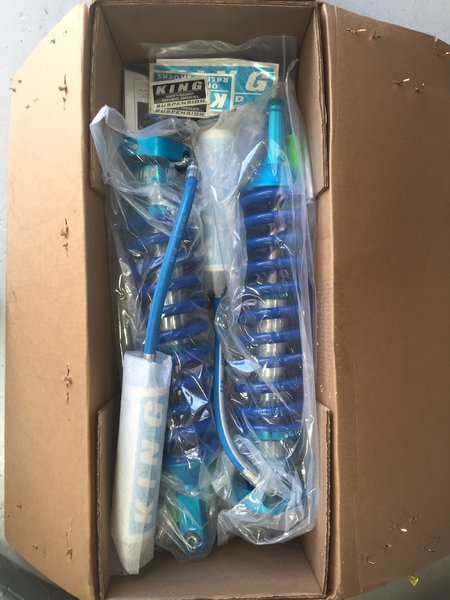

    NOPE! King decided it was cool to not over night the shocks as promised. So they arrived today. However, they also thought it was totally cool to leave my rear shocks sitting on the shipping table..... So now the tears won't be in until tmr.
    At least the coil overs look cool lol
    Pic of the cab mount chop and plated

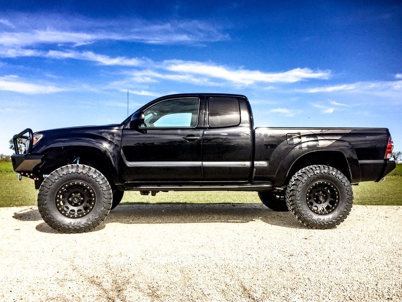

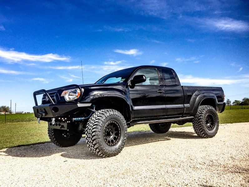

    Had her for a few days before I dropped it back off at the shop for some more work.
    Went on a little road trip to see a buddy and busted out the camera for a bit

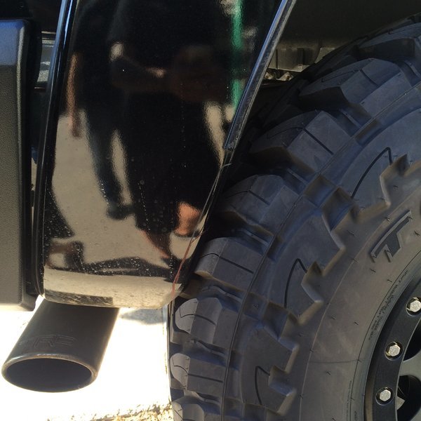

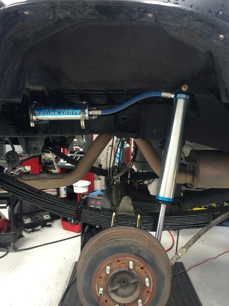

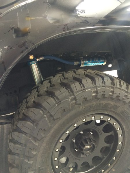

    First chance I have had to update the build on here.
    Rear King shocks finally came in. Custom shock mounts.
    Did a flex test and to my surprise the only cutting I have to do is this red line, doesn't touch the top of the wheel well.
    Got the limit straps and side plates from All Pro that didn't get shipped with the rest, no biggie for that big of a order.

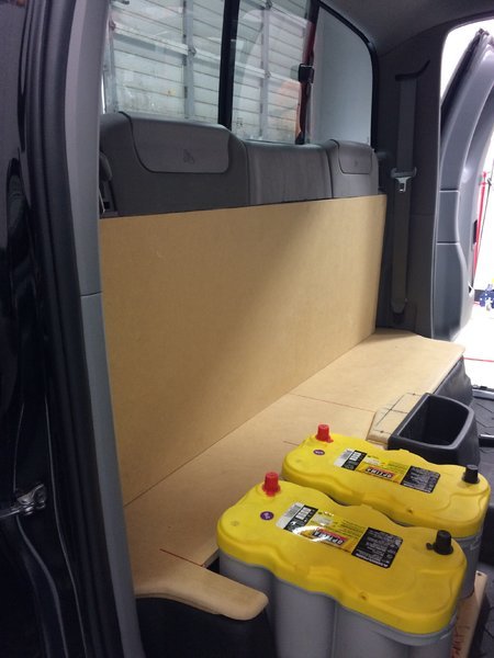

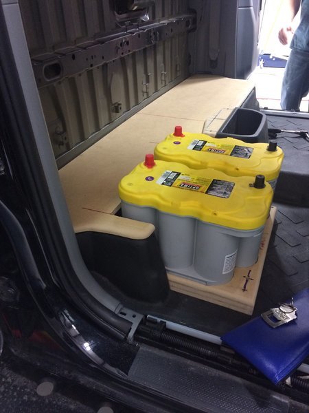

    Update
    Dual Battery system is coming along. No battery under the hood now. Not comfortable to sit in the AC rear, gutted it and put it to better use. Cut out the storage compartment below the jump seat, batteries as far back as they will go, remaining dead space in that storage area will hide all the wires to fuse blocks and relays. Back seat panel is cut, to keep it clean with all the hard lines up top.
    Going with the TJM 'version' of the IBS relay
    Will also have a spot on the driver side to put the fridge if I don't want it in the bed.
