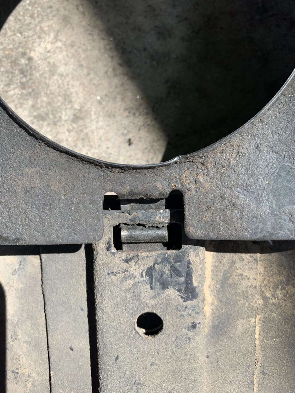

    The interlock tab between skid(splash) pans isn't in the notch for it. Drop all but the front bolts and lock it in before installing all the other bolts.

    Hmmmm are you sure?
    I am pretty sure that I made sure the tab was in. When I removed it this time I just kept it all together as one skid plate and removed the two rear most bolts and the front three bolts.

    So I owe you a six pack. Thank you!
    It seems to be the skid plate. I think there might be something else, but maybe the skid plate is amplifying it? Either way it is less or non-existent with the skid plate off.
    One of the bolts was loose that was holding the two together.
    Is this not how the interlock tab should be?
