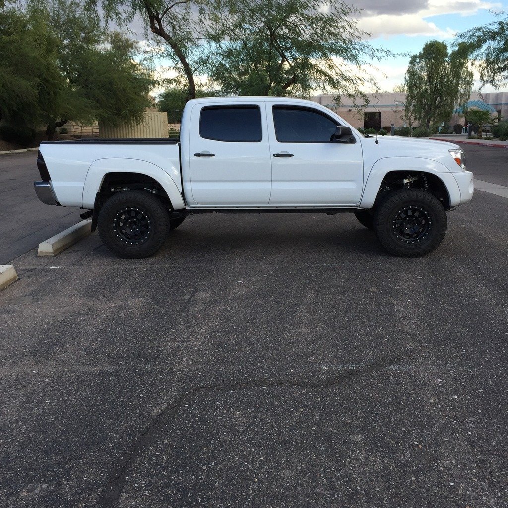

    Thanks Jerry,
    Here she sits on the New Method Standards and the leaf packs have no sag and feel great being just broke in after 6 mos.

    @hollandhunter
    I have a pre-runner and as such run lifted spindles which allowed me to keep my coil overs @ 0 lift. So the ride is outstanding but as you have a 4X4 this won't be an option for you.
    Since the lift you're wanting is 3" then your on road ride will still be very good with which ever of the 'Big 3' (Icon, Fox, Kings) you go with particularly if you like to run at speed.
    If you're a slower speed, rock crawler or slower speed Expedition kind of weekender then the OME set up front and rear will satisfy your needs particularly if you haul lots of weight due to gear. OME would be the most budget friendly of the quality set ups for the Tacoma platform. I would still advise UCAs and extended rear brake lines though.
    For reference my truck is my DD and went with the Icon Digressive shocks because I'm on road 95% with 5% off road.
    I like the more 'tighter' feel of the Icons on road as the wheel feels more like a track suspension and not a cushy sedan feel. And off course off road the ride is outstanding with the suspension impulse virtually mitigated for a nice plush ride.
    Keep in mind all the little things are present as well, limit straps up front, extended brakes lines front / rear, hydraulic rear bump stops.
    Once you understand / know how you're going to drive it in what application then slowly piece it together, I put mine together over 2 years and never once paid full price for anything.. FYI, I bought my remote resi's from Headstrong for literally a couple dollars more than you mentioned . . .
