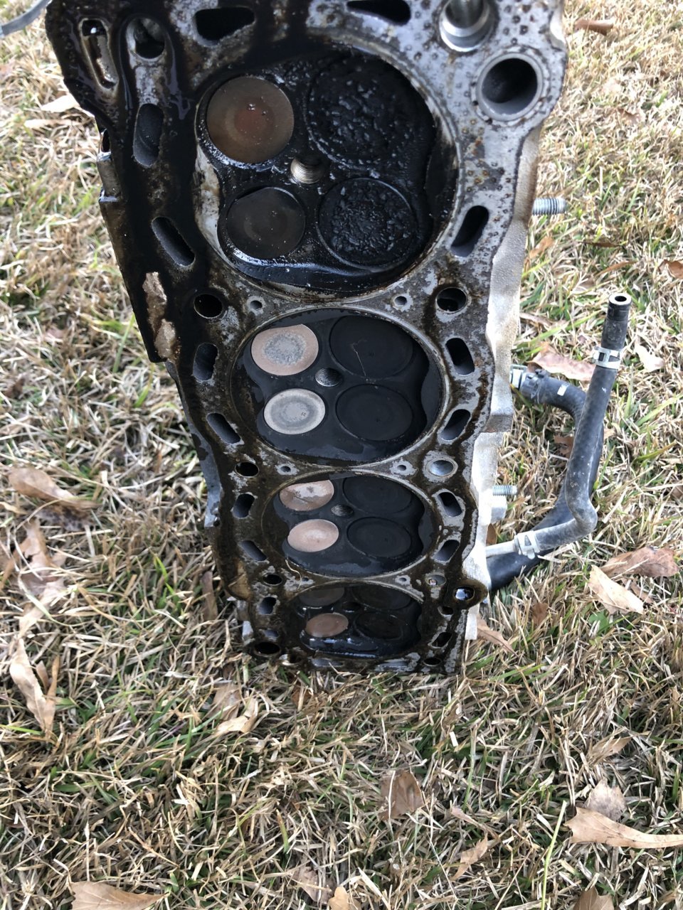

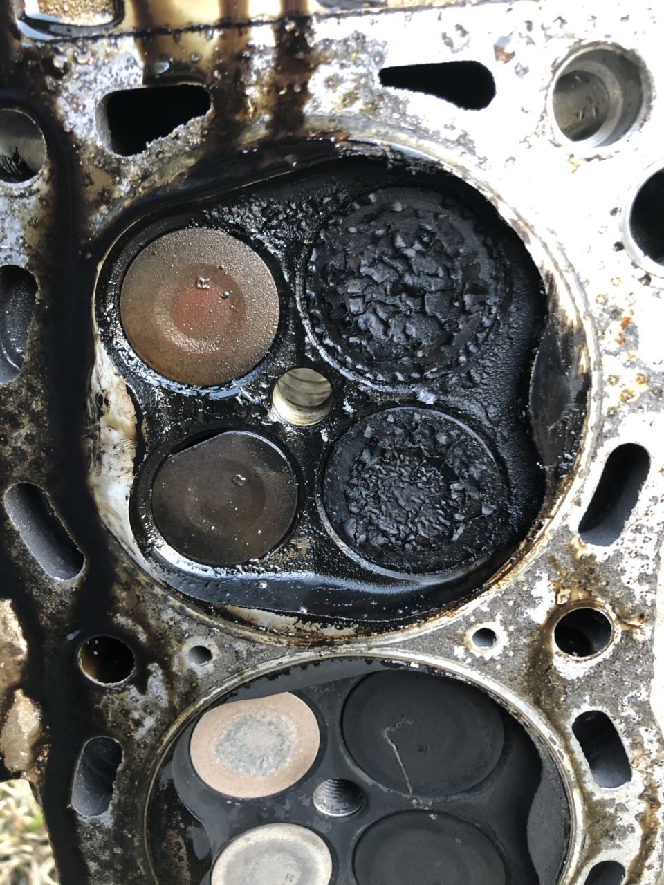

    Well...burnt valve it is.

    Yes, that's it. Might ask them how much to set the valves in shop.

    What's up with the oily exhaust from 4 also? (the one with the wonky measurement.)

    #4 has fresh spilled coolant on it. CNt believe it made 50psi either. You could actually hear it wooshing back and forth as the truck idled. I couldn’t figure out if it was #1or4 because those tie together before the main collector.

    Wish I had been wrong..............
    Actually welded up a head on my 1972 FJ40 Land Cruiser that had a badly burned valve. Was still holding 4 years later when I sold it. [of course that was cast Iron]

    do the guides if changing valves always pair that. Make sure there isn't a crack in the top of that chamber. Lots do.
