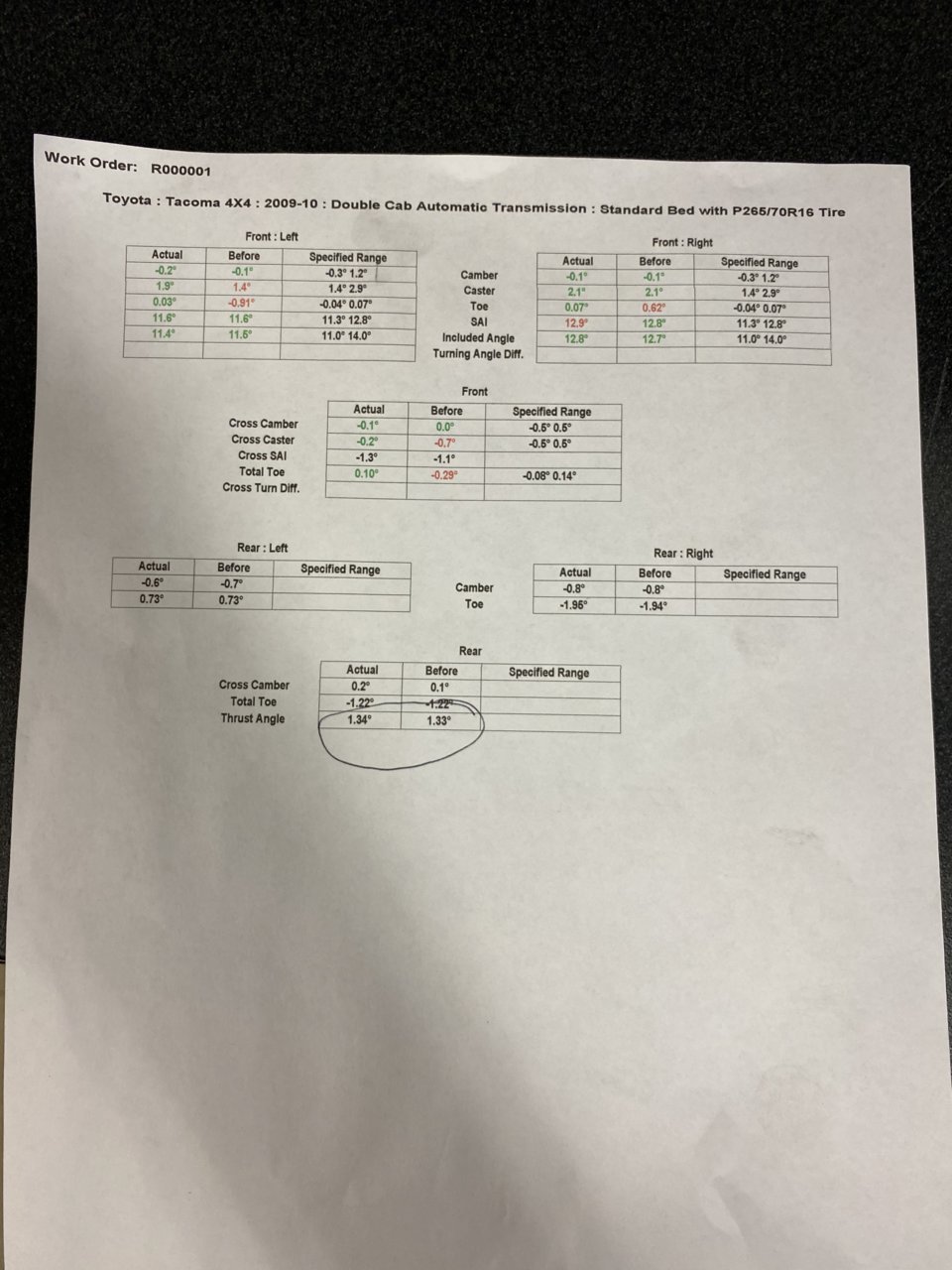

    So long story short was off roading in lake wash ,very sandy. Dodged rock with front of the car but rear slipped back into the sand tracks made by buddy in front of me and back right tire kissed the rock. Coming back from Joshua tree my buddy noticed I was crab walking. Took it to alligment and got the numbers(will post pic). By the looks of it my ubolts flattened the retainer flanges on the top plate plus maybe bent centering pin and bolts. Took it to the to a body shop and they checked drive shaft for wobbles but look normal. Even swapped wheels to eliminate bent rim. Already ordered ubolt flip kit to fix one of the issues. Anyone got any ideas where which points I can measure to confirm axle housing is bent or not.

    Given these rear toe measurements the rear axle is bent a little, you are toed out 1.22* should be pretty close to zero ----1.22* is pretty close to .6"
    You should be able to loosen the u-bolts & move it some like Creed said Take the axle as far forward on the right & as far back on the left you can get it then drive it with someone behind you to see if still dog tracking, listen for bearing noise & if none you may be able to get by with it.

    Thrust angle is the alignment of the axle, total toe is basically how straight your axle is.
    If that alignment is accurate your axle is toast. Total toe has nothing to do with ubolts or alignment of the axle lucky for you can find a housing super cheap at wrecking yards. Also I have aligned hundreds of these trucks usually total toe is around .08-.20 on tacos according to our hunter alignment rack

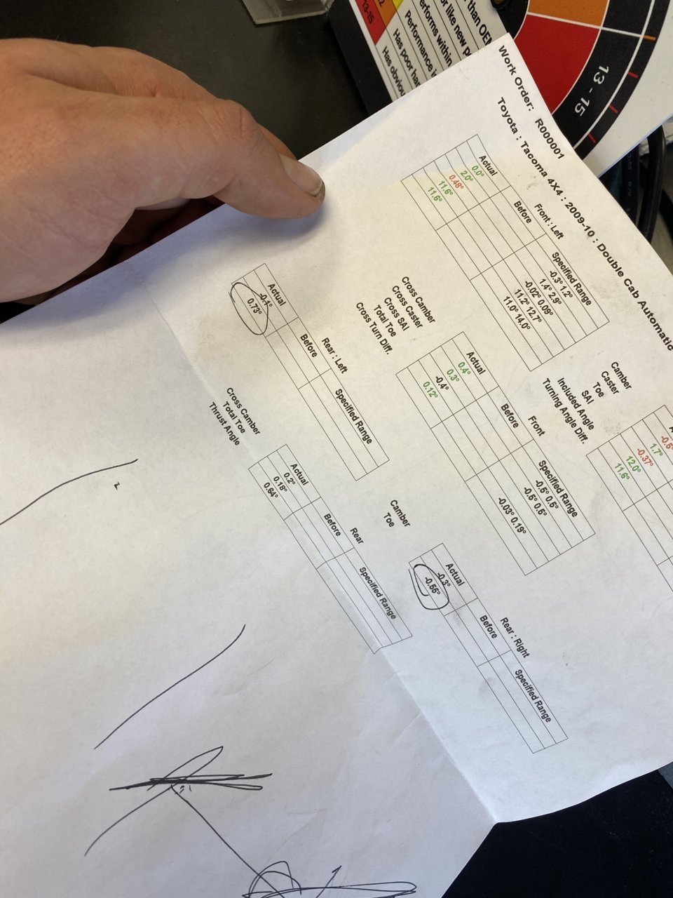

    Well currently I am dog dragging but there is no bearing noise, any leaks, and the wheel does not wobble. What I am confused about is how is my axle shaft is not bent but my axle housing is bent.

    Yea you can see it dog tracking by the alignment sheet you printed.

    Little update, axle was bent. Replaced it with a certified one from a yard off a 15 prerunner. Unfortunately my alligment is still off in the rear but only by .18 degrees instead of the .74 degrees. So far I’ve replaced brackets for leafs with a flip kit and the axle. Anyone got any other ideas before I take it to the frame shop? Could it be a bent centering pin on the side where I flattened the leaf pack bracket?
