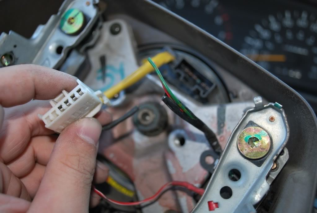

    Got my neighbor helping with the horn now... took apart the steering wheel cover and found these wires...
    Could this be the culprit?
    The red and green wires aren't attached to anything, and there's a wire coming from the white connector that has been taped off.

    That very well could be the problem. The best I could find as far as wiring diagrams for your year is for a 4runner. It uses a green wire with a red stripe for the horn. That same color combo is used up until at least 2004, so I'm going to make a guess that will be the case for you as well.
    The only way to know for certain is to see if it has power before and after you pull the horn fuse. (use either a test light or voltmeter)
    If it is horn related, you can test the horn by touching that wire to a ground and it should beep. (make sure it is horn related before you just go grounding random wires)
    (The wires you're testing are on the connector side, with it plugged in, not necessarily the long ones. The black connector will be the item that has power, so when the white connector is plugged in, it'll have power. Thats where you do the testing. If those longer unconnected wires are supposed to plug into the white connector, they'll be completely dead and would be useless to test.)
    And most important, dont mess with any wires that have yellow shielding around them. They are air bag related. I'd even say to leave your airbag completely disconnected during this whole thing. (assuming you have one)
    As far as what those other wires that are disconnected could be, I really dont know.
    If I were to make a guess at this point, I'd say you aren't the first owner and that the horn has never worked. Maybe at one time the horn got stuck on and this was the only method the previous owner could turn it off.

    Anyone know if there's a place online that sells the cruise control switch with the wiring harness that connects behind the steering wheel cover beneath the airbag unit?
    Seems it would be easier to just buy a replacement unit than try to fix the wires. Three were cut, cruise wasn't working or the horn... my neighbor was helping but the wires are so brittle he was replacing them.
    The horn worked twice, the first time the horn just stayed on, the second time by switching wires around the horn worked when you pushed the cruise control button.
    Not sure what product name to look for.
    It would be the cruise control lever + the wiring that comes from it. The green and red wire + another one come from the cruise lever and into the white connector that plugs into the black female end you can see in the background.
