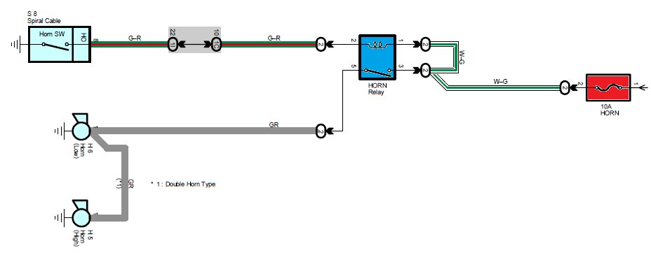

    So when I honk my horn it doesn't honk, I checked the fuse its good, I checked the relay its good, I checked each individual horn they work whe ln connected to power, I press the horn and the relay clicks, I checked the terminal and someone said I have to make sure there's two hots or something? There was only one when ignition on and off. I'm trying to get my vehicle inspected and if I dont register it I will get fined within next month. horn broke within 6 weeks ago.

    Relays usually have 4 pins, 2 would have resistance. From the horn button, power is being supplied to one, the other should go to ground. The other 2 pins, one gets power, the other goes to the horn, then to ground.
    To test the relay, putting power to the 2 pins that showed resistance will cause a click, closing the switch inside, like turning the lights on, or causing the horn to beep. So put your multimeter set to ohms on the 2 pins that go to the horn, apply power to the 2 pins that showed resistance, your meter should show the same as if you touched the leads together. Or it'll show no change, or very high resistance. If it shows either of those 2, the relay is no good. You need jumper wires with tiny roach clips. Or find a mechanic friend with a relay buddy tester, easy.
    I could be wrong, I've seen horns with constant power that get grounded when you push the button.

    I figured it out apparently I must've checked the relay wrong and I bought a new one just to see and it was the brand new relay that was bad. Thanks for all of your comments, and help.
