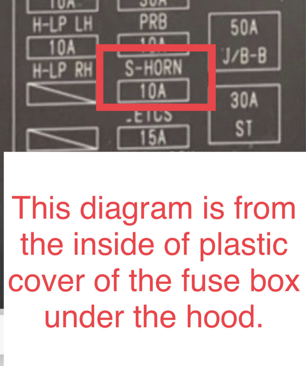

    Bro, I’ve upgraded my horn as well.. Check this; a car comes out and turns right RIGHT in front of me! But with 3 lanes, this dips**t pulls into the one I’m driving in! Long story short, I LEANED on that train horn!! Drove on, got home, and when I set my alarm, no “chirp/honk”.. Just “chirp”. Hmm.. Saw your question and after checking the answers (which are WRONG bc I checked interior fuses) I looked under the hood. Popped THAT fuse box, and BINGO! The dinky 10A fuse was burnt! Replaced IT, and “CHIRP/HONK”!
