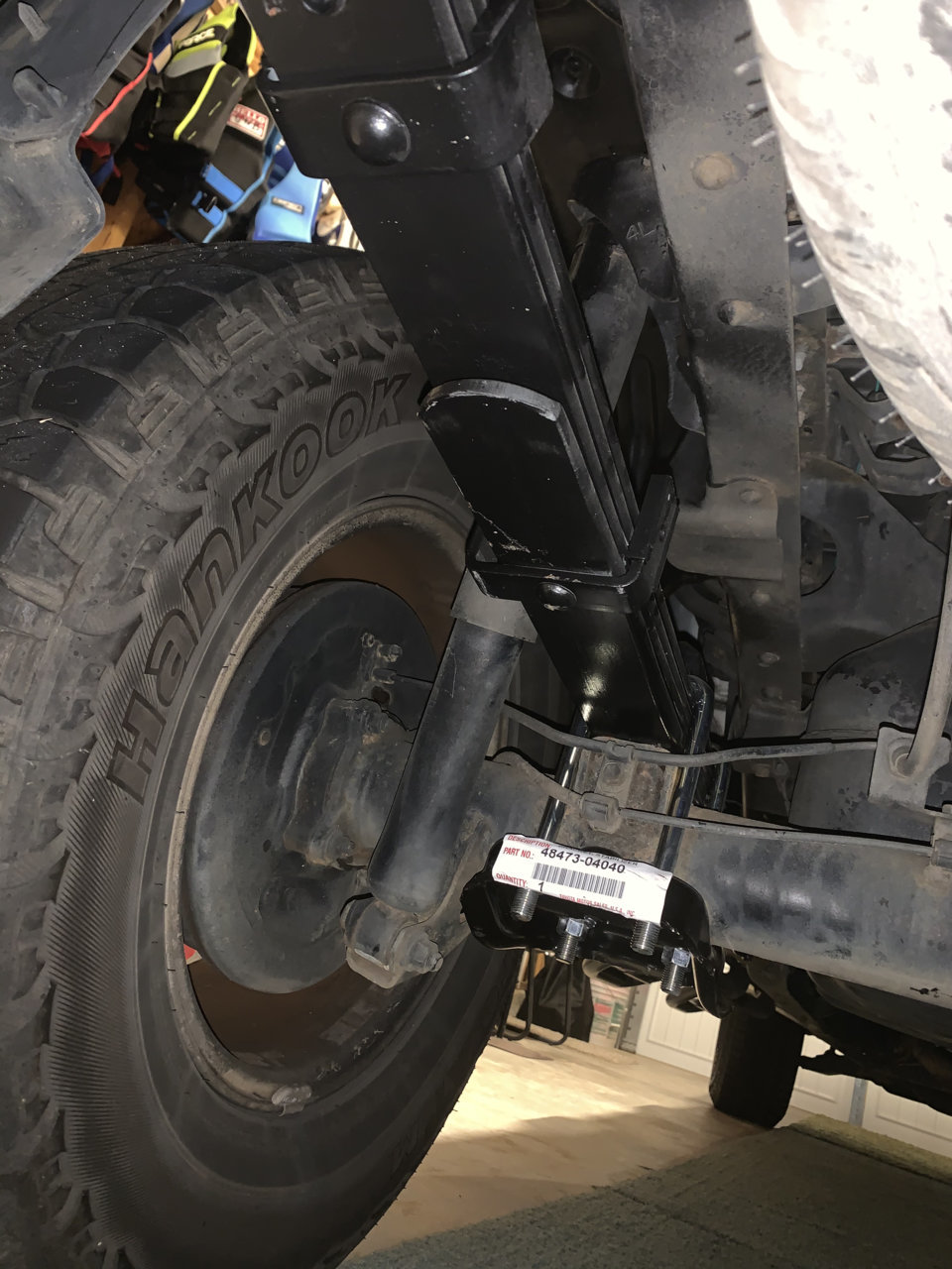

    9FB348D4-86EB-41D1-9C55-1F9FD7C899C3.jpg 974D859D-3774-4669-8616-6AB5433FCB10.jpg Hey! New here!
    Bought a 2006 Tacoma Crew Pre-Runner in really good shape with almost 300k miles!!! Bought This truck for my 16 year old son... So far so good we’ll see.
    Was doing the quick two honks on start up. Unplugged the T-wire splice talked about above. Seems to work...stopped the honk on start up and all functions well. Hope that’s it!!! Thanks!!!
    toyota in athens Ga just performed 2 open recalls on it today...New clock spring in steering wheel and New leaf springs in the rear!
