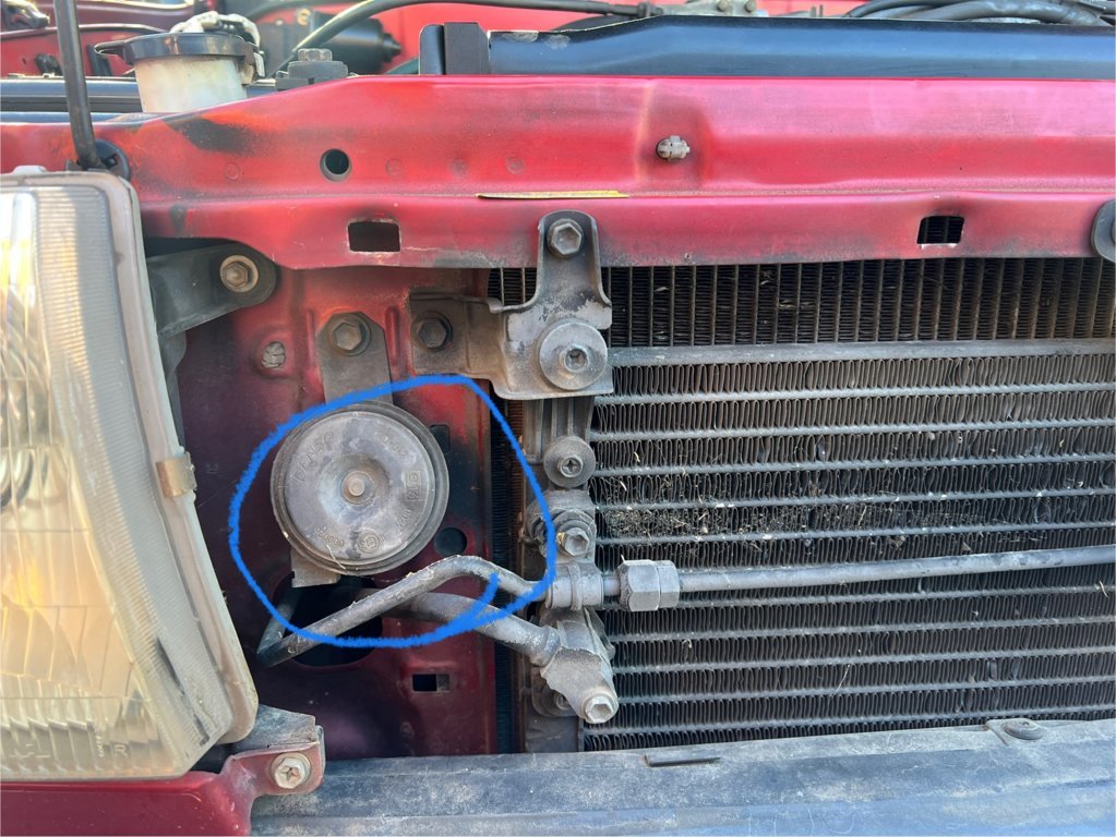

    Bought this used 1st gen Tacoma and discovered horn doesn’t work. Pulled the grill and when I accessed the connector I learned there was no wire running to it - and no loose wires anywhere in the vicinity.
    I assume the wire would be in the only wiring conduit I see which snakes along the top of the radiator support and is shown in this pic with front right headlight wire breaking out of it?
    Thought I’d check here before I start breaking open 26 year old plastic hunting for current with my multimeter etc.
    And yeah, I’m getting to that washer fluid reserve tank next ;)

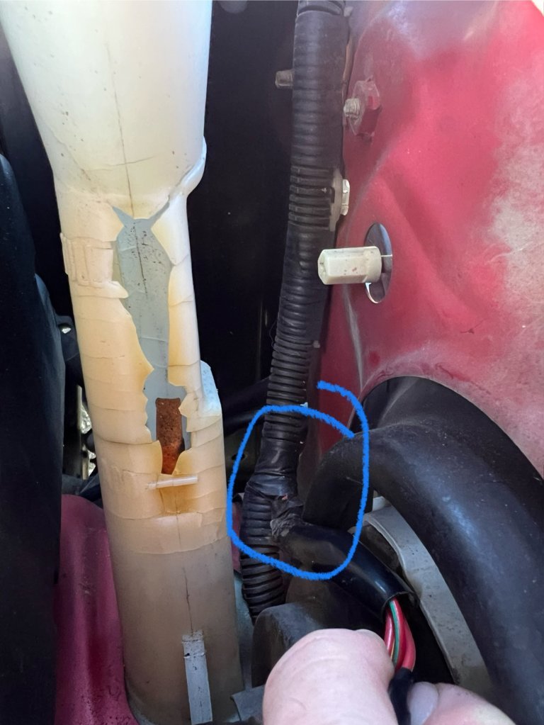

    Keep looking for that wire. I find the horn wires hard to locate on that side. I don't see any reason the horn wires would end up back into the loom. It is possible they were yanked (somehow) from the plug.

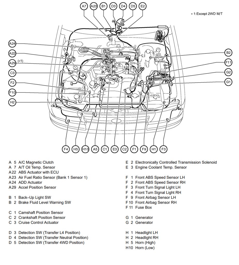

    All I can tell is it will be a black wire, with a single pin connector.

    See H5 in the diagram below for wire routing.

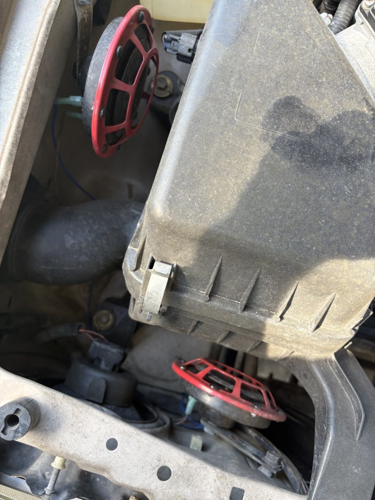

    My set up
    One black wire pigtail connected to the blue wire

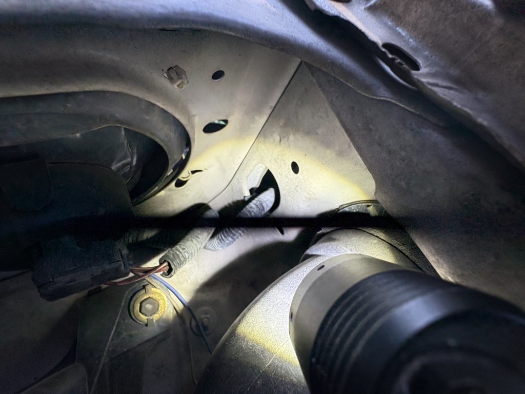

    I traced that loom to here
    Behind r HL on R apron

    Yep that was it- with the help of a tone generator I found that second loom was hiding below the passenger headlight assembly- thanks all!
