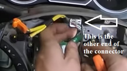

    Yes it does. Yes, all have a horn wire that connects through the spiral cable It provides a ground to complete the circuit for the horn relay coil.
    It sounds like you forgot to connect it back up. As you can see it is green with a red stripe. Connects to the spiral cable to ground when you press the horn button.

    The ground wire goes from the steering wheel back to the horn relay coil terminal. It has a spade terminal on one end and plugs into the center pad area where the air bag is located.
    Video Here: https://www.youtube.com/watch?v=VblczY9PzMc
