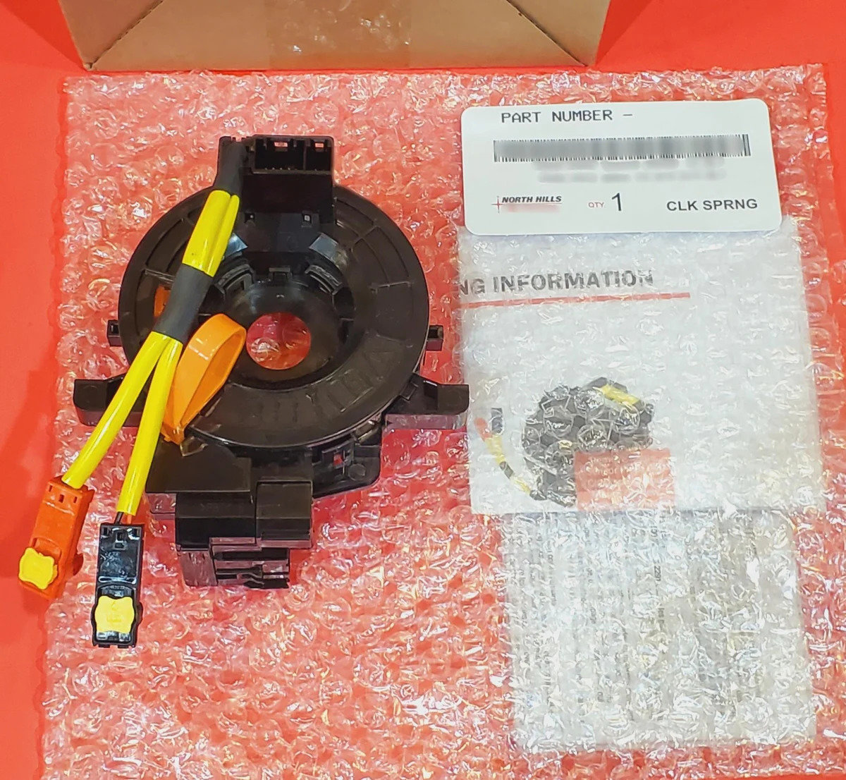

    Like I had been suspecting, it’s the damn clockspring cable aka 84306-0E010.
    I opted to do it myself instead, but have yet to settle on the right part and comprehensive tool kit to buy (per TW), to be more of a DIY owner.
    Starting a new job on Tuesday, also a bit more tied up than I anticipated next week.
    https://clockspringexperts.com/prod...9-2010-2011-2012-2013-2014-2015-2-7l-4-0l-new
    Would this work on my 2015 TRD OR DCSB V6 4x4 6MT? Price just seems awfully low compared to dealer at $383 for the part.

    Just cross reference your P/N my 35$ CS is still good going 4 years

    So, I should probably just buy and get it over with?
    I remember Toyota recalled these trucks under the older steering wheels, in the 2005-09 years.
    Pretty unfair of Toyota to expect us all to replace a never ending defect of theirs at high cost, instead of including it under a comprehensive recall.
    Thanks @Dacapster

    $383 because the dealer is making 40% retail profit on it...
    Online dealers (e.g. Mcgeorge) sell it at reduced markups.
    The aftermarket ones (down to the $30 eBay ones) will work but may have reduced life, as little as a year. I bought one as a sacrificial Dremel practice piece a few years ago before modifying my OEM clockspring to fit a JDM steering wheel.

    Thanks, trying to figure if that part in my link is a good idea or a dumb risk to take, over guaranteed OEM.

    Makes a lot of sense, thanks. I want to do it myself, but if I can get it done at a nearby AAA approved shop ASAP for cheaper labor, I guess that’ll do for now and I’ll save DIY for other stuff, like mods.

    I prefer to go with guaranteed OEM - mostly because I don't wanna repair something 2x
    This part in particular - I hate hate hate messing with the airbags; which is one big reason I haven't fixed mine yet..

    Mine has lasted may years If I have to replace again at 35$ In down 70$ for 9years my OEM lasted for 6 years.

    Just replaced my cs with a cheap aftermarket one. Works for now. :)

    Thanks everyone, I guess one of them will work right and if it goes bad again, hopefully years down the road.
    Definitely have never needed the steering wheel airbag in my many years of driving and hope to never need it in this truck.
