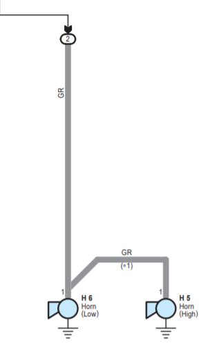

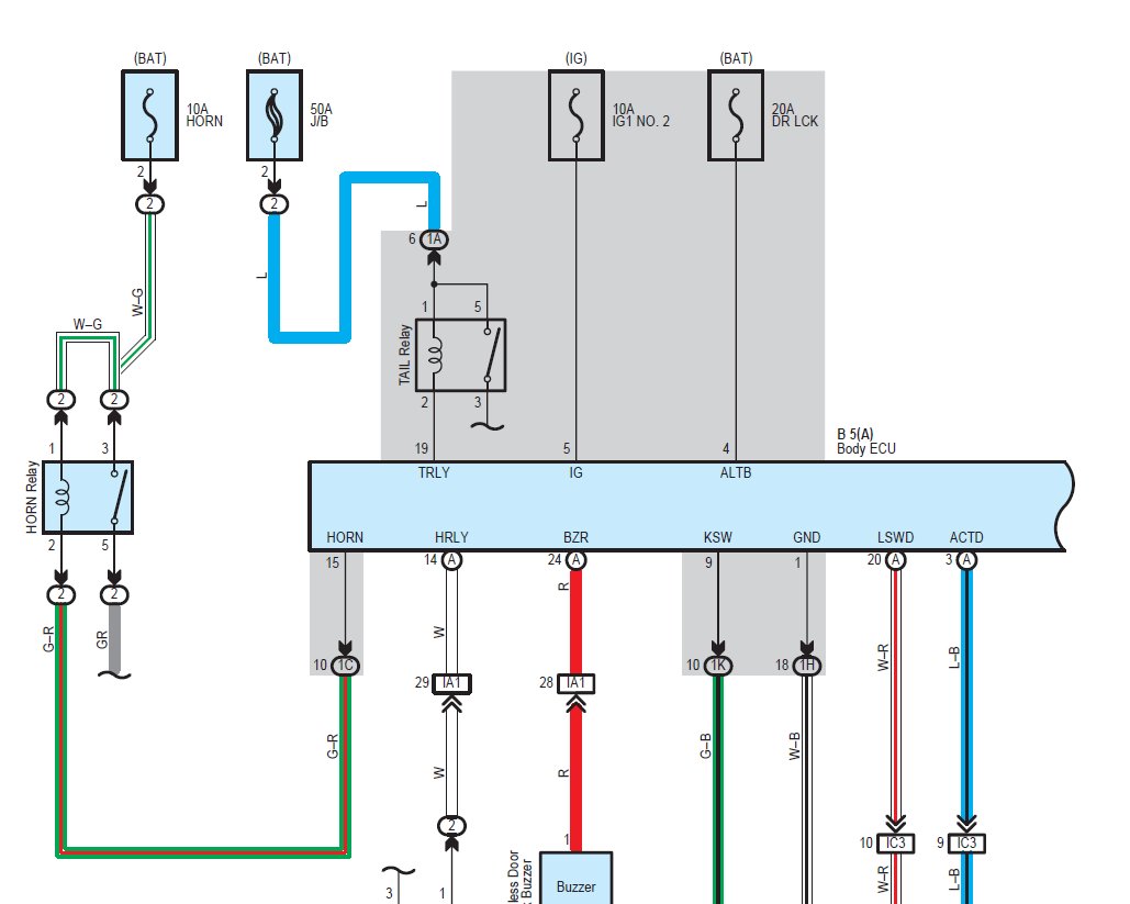

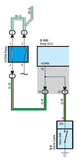

    Here's the schematic for the horn circuit you'll note it's positive switched by the horn relay with the body of the horn assembly providing return current.

    OP just unplug the Green with Red Stripe wire in the steering wheel and ground it. If the horn blows then the spiral cable is the problem.

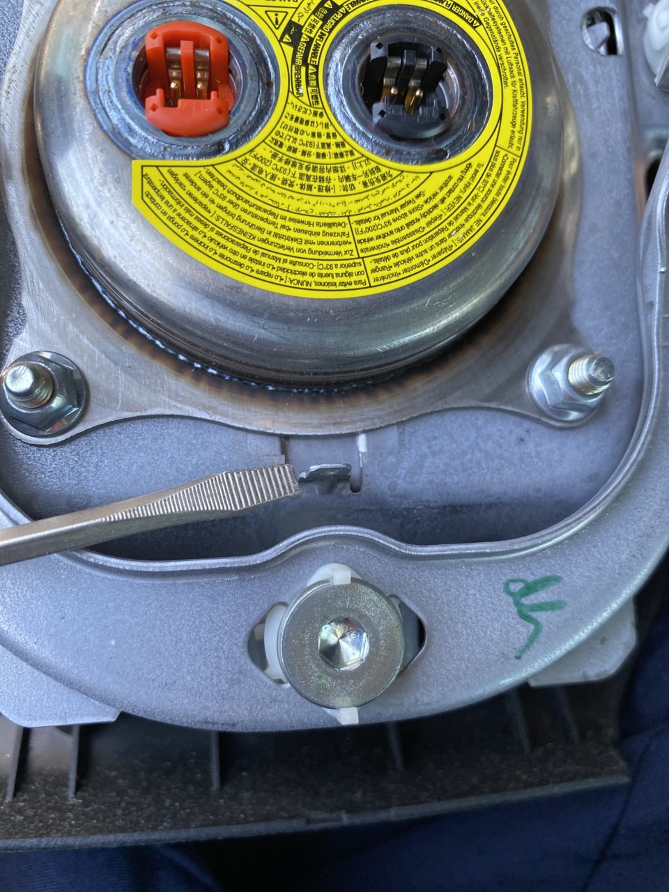

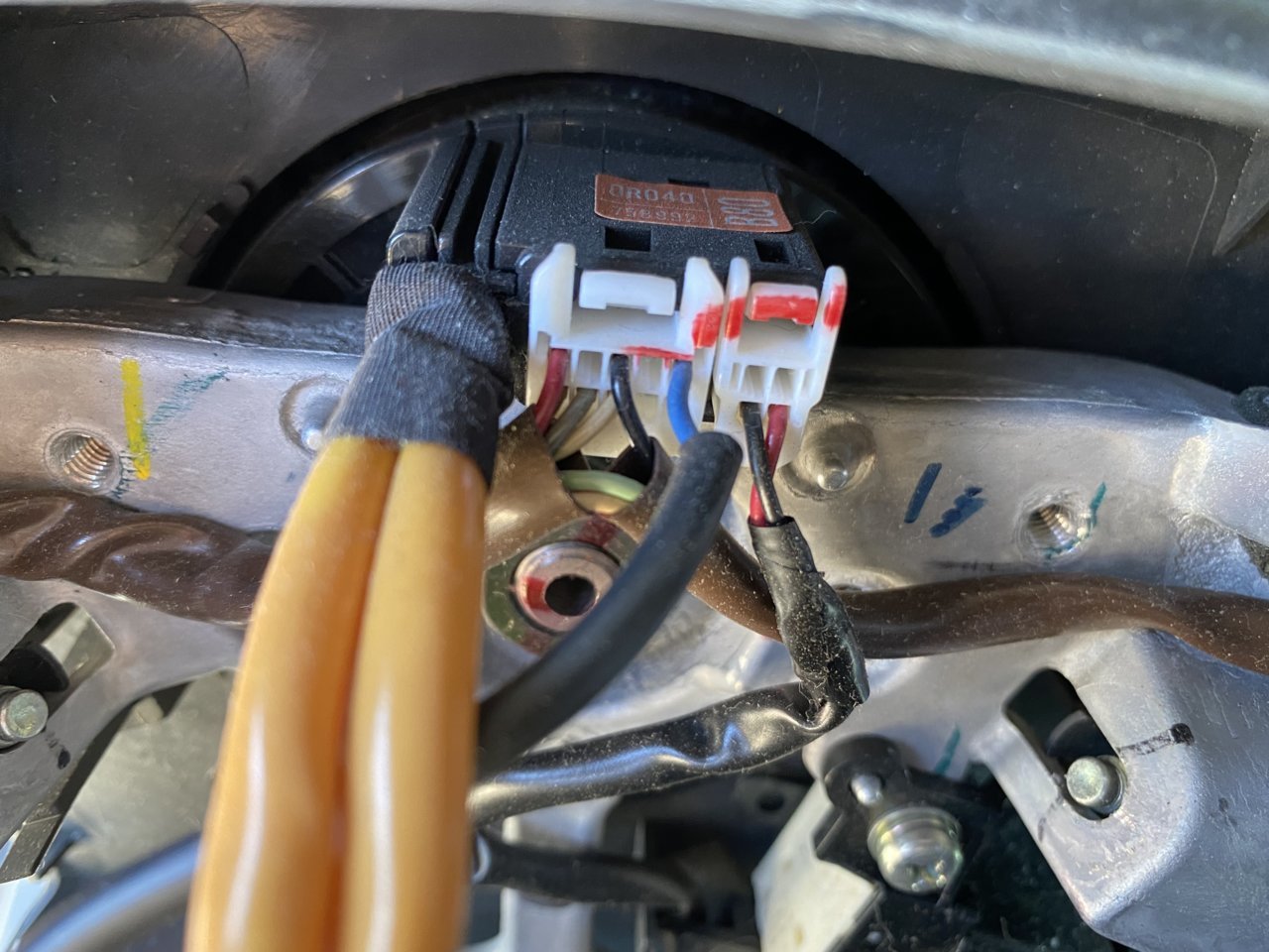

    So there isn't a green with red stripe that I'm seeing. *edit: the green with red stripe is in the terminal on the other end of the clock spring, not right behind the steering wheel*
    The blue wire appears to be the ground from the horn. Should I ground that to test the wiring? *edit: that is the ground for the horn switch*
    It connects to the horn switch/airbag at this terminal by the screwdriver
    When grounding the wire that plugs into the horn switch I get nothing. I'll run back out and test the green/red wire at the terminal later today but everything is pointing to the clock spring so far.

    That is the Green with Red Stripe I was talking about. It's in the video that you attached.
    See the print that was posted above and in your video you linked Green with Red Stripe behind the steering wheel.

    Yeah. That's what I figured out once I got further into it. Horn honked when I grounded the green/red but did nothing when grounding the blue wire that connects to the horn switch. Going to pick up a new spiral cable tomorrow.
