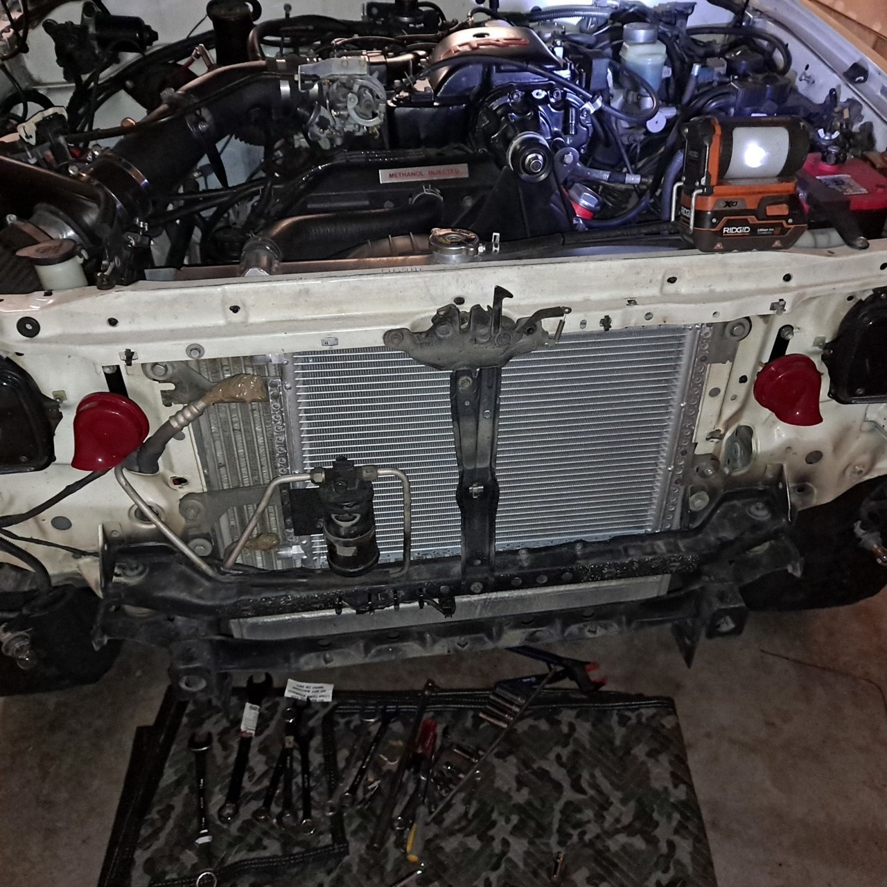

    Did you figure out the problem?
    mine is the same issue as yours,
    my problem is every once in a while horns works,
    when the horns don’t work there is a clicking sound when the horn is pushed,
    I have the same issues.
    Grounds are good,
    New horns,
    New wires,
    Power is good 12v when the horn is pushed,
    so maybe relay or clock spring?

    The horns were working occasionally 10 percent of the time. I ran new wires with a hella horn setup and new horns,
    still having the same results working occasionally,
    thanks for that info on the clockspring because it shows power 12 v when I press the horn.
    I will try a new relay then if I can find the location for the 97 year for the relay. It’s somewhere up by the flasher I think

    Got it fixed, one of the connector to the hella relay was not crimped hard enough,
    thanks
