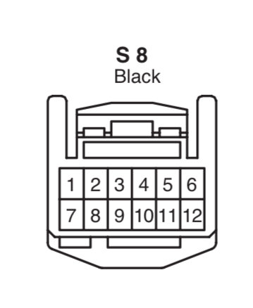

    I have a 06 double cab v6. I just put in a quick release wheel and i had to take out that clock spring, losing cruise control and horn. Im okay with losing the cruise control but im trying to wire up the horn to the wheel i just dont know what wires it is for that. Help!!!

    It's the Green/Red wire, ground it to activate the horn.

    Which connector is it under the wheel?

    The one that’s listed as S8 on the diagram above.
    It should looks like this, and be pin #8.
