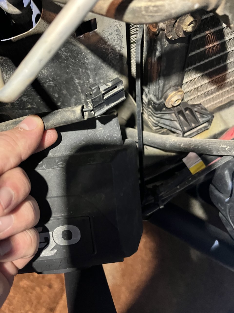

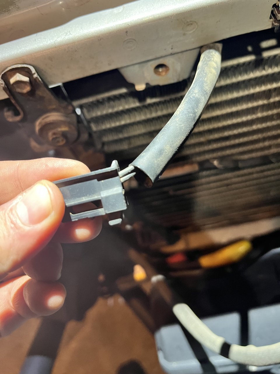

    Howdy folks,
    My 04 has two separate horns and I’m confused. Do first gens have one or two horns?
    The connectors for the horns have one wire and two wires which are both black. How do I tell them apart? Which one goes where? This is way above my skill and knowledges

    the 2 wires going to the horn are +, and then they ground through their mounting. Shouldn’t matter which is plugged to which horn

    Why does one of my horns have two horns going out of it while the other just has one?

    the one with 2 wires is just taking the single wire and splicing out to the other connector. saves money and harness real estate vs running 2 separate wires in the entire harness for the horns

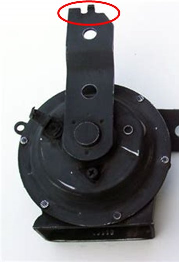

    The horn brackets may be a bit different. It's common on Toyota dual horn systems to have what's called anti-rotation features on the bracket. It just keeps the horn from rotating while it's being tightened to the vehicle. The bracket feature is a brace against the torque when the bolt gets tight.
    Won't affect the function of the horn as far as sound if they are reversed. If one horn has a white paint dot or the anti-rotation features are different, then they are unique. If not, generally they are universal left to right.
    I have replaced the horns on both my trucks so can't confirm, but just look for tabs on them and see how they mate to the body.

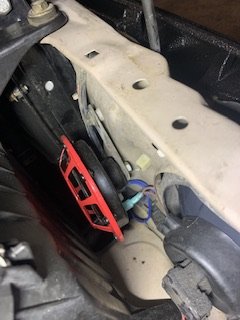

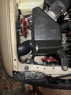

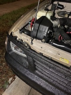

    When I get home will post pix of my set up I just upgraded
    Had
    One horn set up, mounts r side behind grill
    Now
    Dual Hella, mounted front and right of airbox
  15. Sep 26, 2023 at 6:12 PM

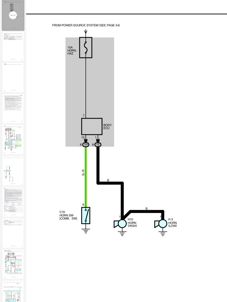

  16. Sep 26, 2023 at 7:23 PM
    #16
    Kevins60
    Kevins60 axle wrap tells me my rear brakes are working
    Dec 23, 2018
    #276677
    1,217
    Kevin
    Odessa FL
    ‘04 4cyl SR5 AT Pre-runner Garage Queen
    SCS Cruise Westin step bars Lund tonneau Jensen HU
    High and low frequency horns

    Crap
    I forgot
    ^^^^ that diagram exactly what I did

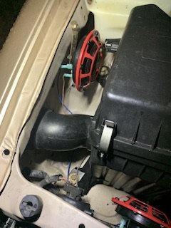

    Clock Volt meter/LSPV Delete/Hyundai 16’s/FP gauge/after 9months of wrenching ZERO oil leaks
    On upper R apron/fender support
    There are some ‘dead panel’ screw holes not needed for my model. Typical 10mm
    I used the original horn mount on radiator support (backwards) for the front most horn
