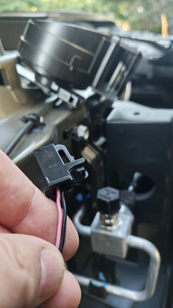

    I need to tap the +/- wires of the horn and have been unable to find any wiring diagram for guidance. There are two horns; driver's side has a pink and black wire and the passenger side horn only has a black wire.
    Haven't pulled out the voltmeter yet and thought I would post here for some input. Thanks in advance for any guidance.

    They only have a power going to them, they ground to the body.
    Black wire is a jumper to the other horn.
