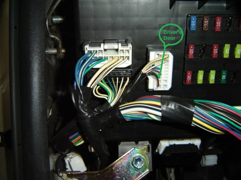

    There are different colored door trigger wires for each door. Assuming you want the drivers door, it's green/yellow.

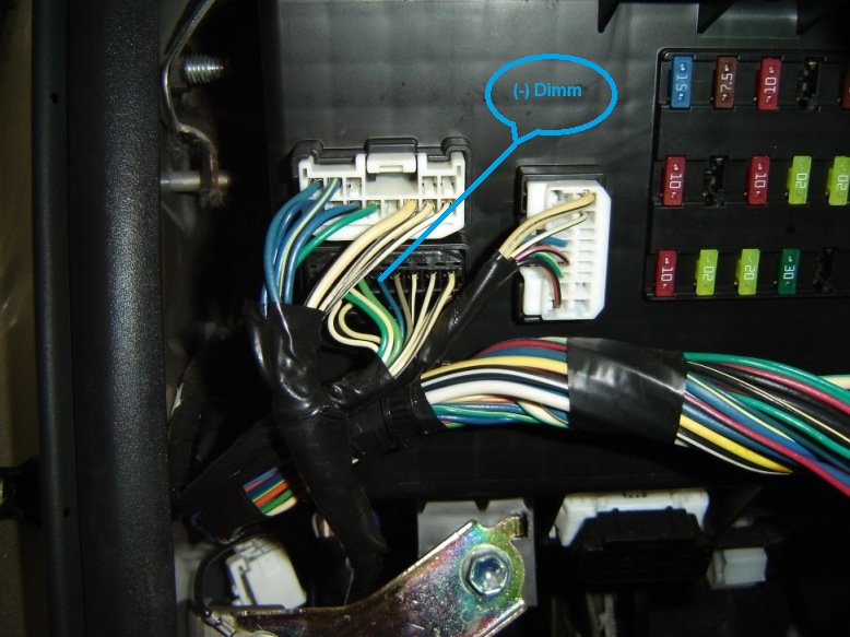

    The Driver Door Pin (-) with autolight only "could" be the blue wire on connector 1E pin 9.
    Pork Chopper likes this.

    Just saw this after replying to previous comment, thank you for posting pics it’s very helpful. Would it turn the map light on that’s above the infotainment system when the driver door opens ? Thanks again

    Okay so if I wire the drivers door switch what light does that turn on? And where would you guys recommend wiring the hood switch to, is there already a place I can just screw it into
  9. Dec 26, 2018 at 4:38 PM
    ToyotaRacingDev
    ToyotaRacingDev [OP] SWO Tacoma Enthusiast
    Nov 27, 2018
    #273997
    341
    London, Ontario
    2008 Tacoma TRD Sport
    Is that a picture of the back of the inside fuse box? I’m really loving the pictures it’s very very helpful

    Overhead lamp....but if you did the map + cab mod then all 3...:woot:

    Wonderful, and the overhead lamp would turn on if I tapped that green/white that you sent a picture of. I can’t thank you guys enough, this is going to save me a lot of time

    Green n yellow...flash washed it out a bit
