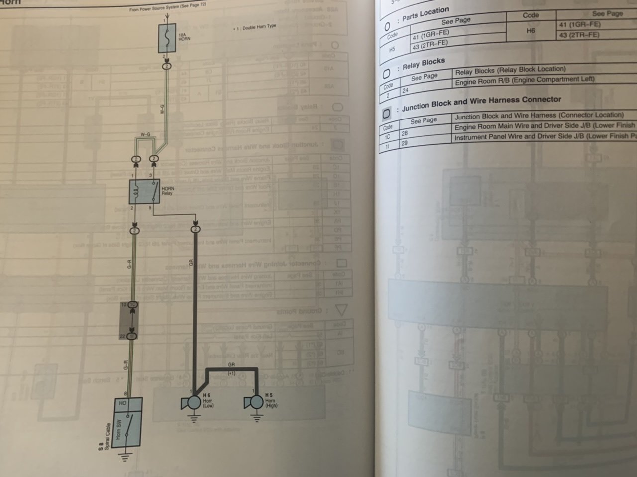

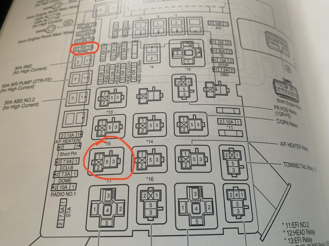

    So all I did was unplug them as I moved them years ago to put the BAMF Behind the grille bar in. Today I unplugged them to start putting my Blue Sea Panel in now they don’t work. Doors anyone know for a definite where the horn fuse and relay are

    Replaced the fuse and nothing so get i gotta get a relay. Can this be popped out without causing problems to any other thing on the truck?

    Pull 1 of the other relays out and try it. If they still don’t work, break out the multimeter.

    They are grounded through the mounting bolt. If you moved them you may need to clean off the mounting surface for the horn.

    They were moved 5 years ago. Once I put them back and attached the bolts boom they worked again. Thanks for the help gents.
