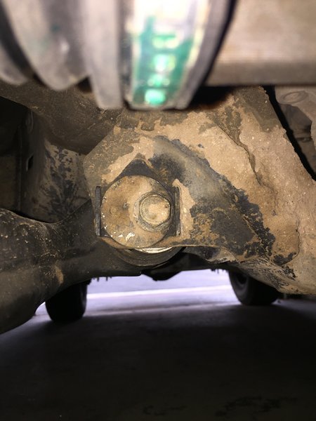

    Just got a alignment and the tech didn't even touch the cams! My caster is only 1*! I have tc uppers as well. Am I maxed out for caster ? The camber was almost -2 degrees as well

    Your cams are completely fucked up, if I didn't know any better I would say you were trolling. :). it looks like you have your caster as low as possible. To max out caster the rear cam has to be as far outboard as possible. It's also set up for max negative camber with the front cam outboard all the way. Your cams look to be set up to make caster as low as possible.

    I wish I was trolling!!! I told him I should be able to get 3* caster and he said "no" he didn't even touch the cams. I was mistaken and thought this cam orientation would give me max caster...either way he should have fixed it
    If that's 1* caster and -1.8 camber...do you think it's possible to get 0 camber 3 caster ??
    It looks like if the caster goes up it will get more negative
    That would explain this

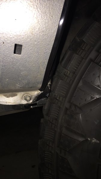

    Take a pic of both cams on both sides.
    The top picture you posted is the front of the rear cam on the passenger side? The second pic is the front of the front cam on the passenger side? :confused:

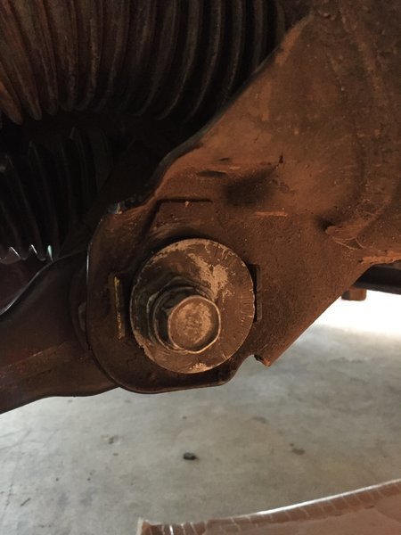

    They are both passenger side...drivers side is the same but the front cam is in neutral position...the drivers side has -.8 camber

    Judging by the cams there is plenty of room to get a decent alignment. You're around 3" of lift with aftermarket upper arms. There is no reason to have such a shitty alignment. I can align that truck better in my garage with basic hand tools and a partially functioning brain.

    Yes, when they move the rear cam to gain caster it will lower camber, BUT you have room to fix that with the front cam.
    Unless your shit is bent to hell there is definitely room for a better alignment.
    If it were me, I'd adjust the rear cam as far OUT as possible and the front cam as far IN as possible and take it to a shop that has a fucking clue what they're doing.
