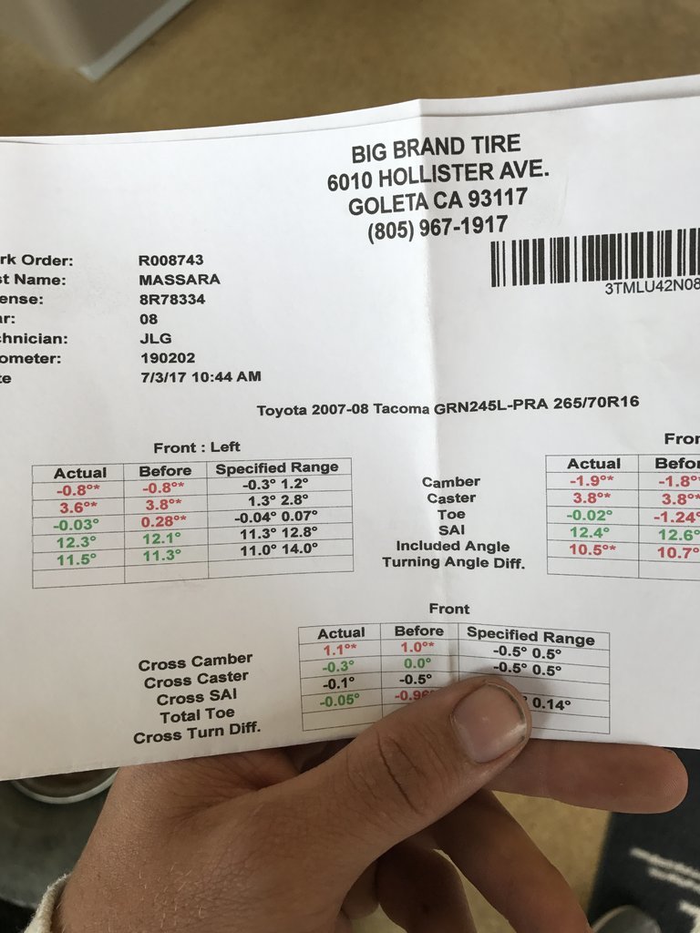

    At first I positioned the cams so the rear was all the way OUT(tire clearance) the. Tried the front cam in every position and couldn't get above -2. If I put the rear cam all the way IN. I was able to get 1.1 max.....this is backwards from how it's suppose to be!

    Figured I would update...replaced the spindle and that fixed all my caster issues....having neg camber issues now though lol....

    Caster that high might cause the positive camber, how do your camber cams look?

    Rear cam all the way out and front cam all the way in...even with both cams all the way in camber was -.08 and caster 1.9 degrees
    I opted for the higher caster because of tire clearance
