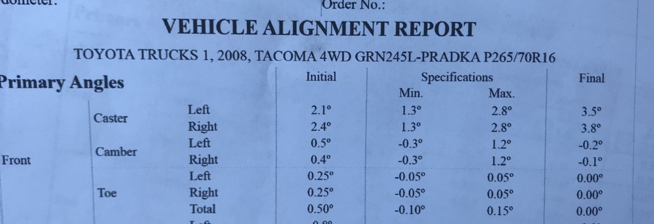

    I wish! Lol. I'm not too worried about the neg camber. It doesn't look bad. Very happy with the caster though

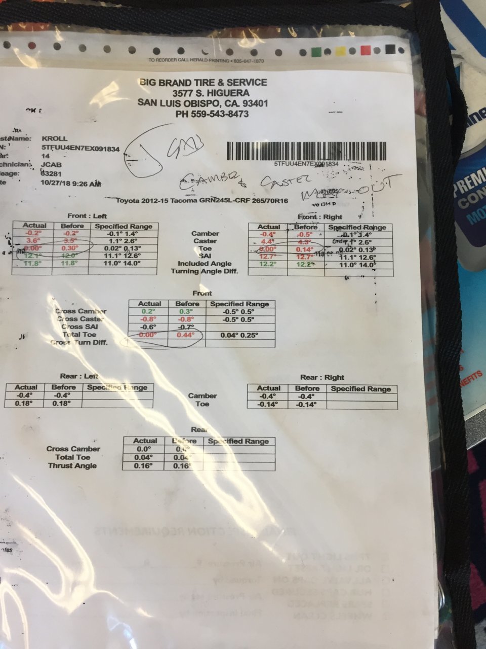

    Can i possibly get some insight on these numbers from anyone?

    It looks good to me. I would like the caster to be closer but if it drives ok then it’s fine.

    Still kinda learning the alignment stuff. Asked for custom #s after realizing they just align to factory specs. Said cams were maxxed out so couldn’t do much. Thanks for the reply

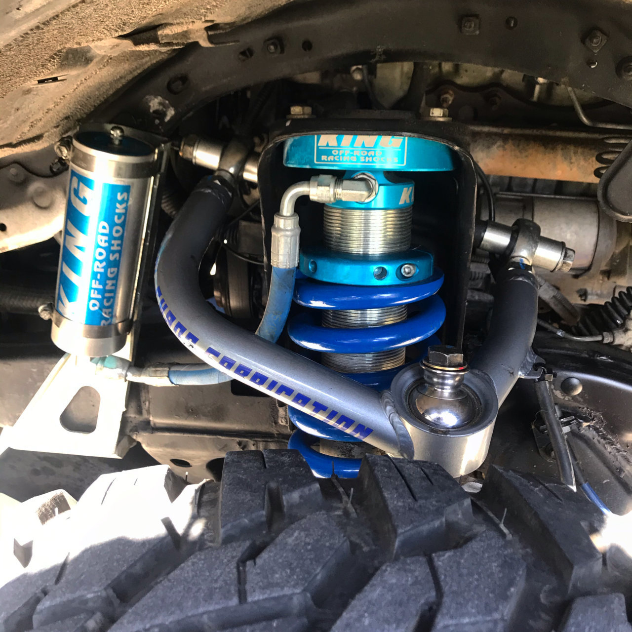

    Figured I would update in here
    installed these
    And they completely fixed all alignment issues.
