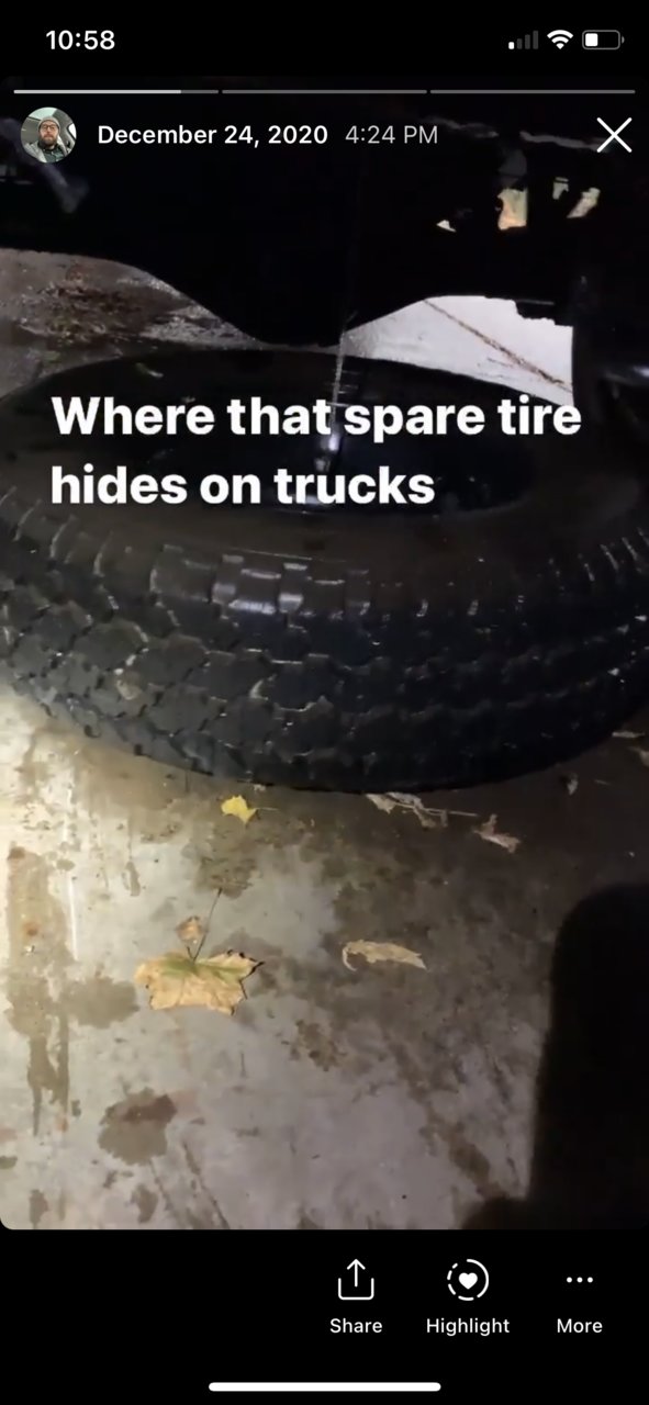

    Also- the spare tire moves around a bit (original mounting spot). Is there supposed to be anything to hold it in place besides the mechanism that retracts via cable?

    Spare tire wobbling is normal but you should be able to tighten it a little if its excessive.

    No, and there was a recall on those cables rusting and dropping your spare onto the highway and through people's windshields. I recommend dropping the spare and checking out to see if the cable is compromised.

    Oh damn. I checked it out a few weeks ago, looked clean. Even made a lil Instagram story heh
