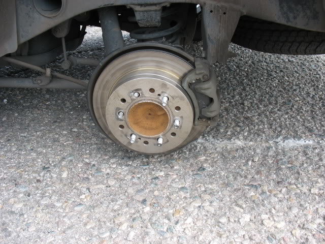

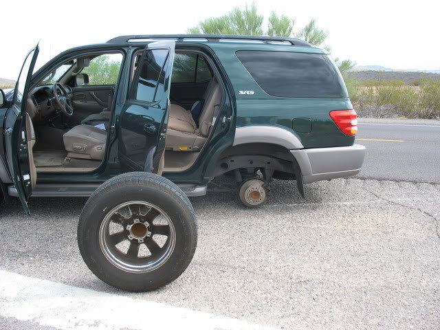

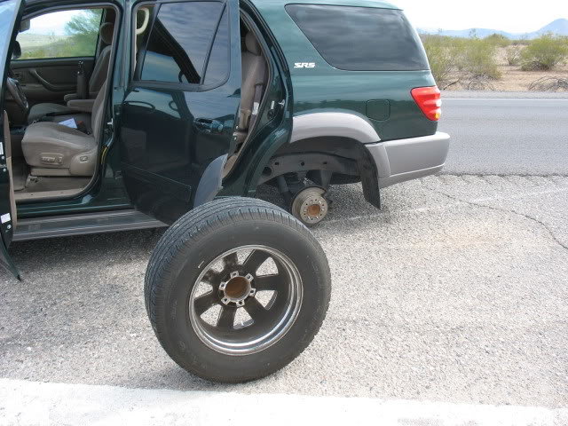

    make sure all your lugs are on and tight. me and my dad were taking a roadtrip to vegas and had the same exact issue. when we were going low speeds the vibration was terrible but once we got up to around 65 it would go away. sure enough when we hit 70 the back of the truck dropped and the wheel rolled past us. not just the tire the entire wheel. here's a pic.
