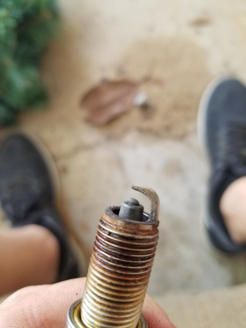

    You haven't said anything about the plugs, have you checked them?? Before throwing a fuel pump at it I'd check all the basics first.

    I replaced plugs at the 305k mark if I remember correctly. I was probably 50k over due at the time.
