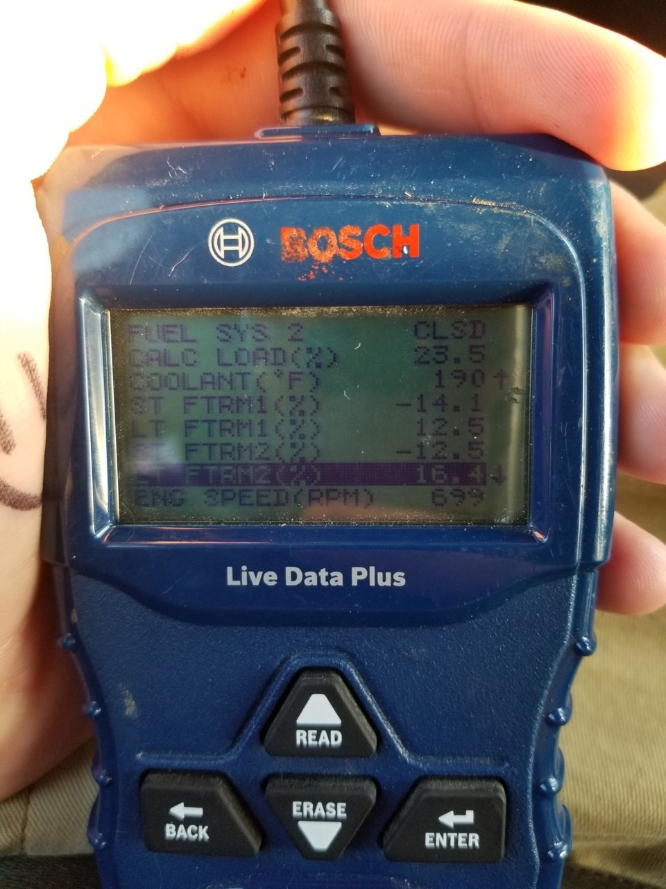

    I know I had someone say something about fuel trims. As you can see, the LT trims seem to be abnormally high. I'm not sure if this help my cause but they are definitely above +10 and will go all the way up to +20 driving on the highway and will shoot down to -20 letting off the gas.

    I think anything -20% to +20 is with in range on FT.
    Although I think closer to 0% is desired?
    I don’t know if a lack of fuel pressure would would make the ECU go up on the fuel trim?
    If it were very low on pressure! I would think it call for more + Trim than 14%?
    But, like I said. I’m not a mechanic. Am at best an ok parts changer. And that’s on a good day.

    From what I read, the change out of the MAF made the crappiness go away temporarily until it came back again. If the fuel pump is the issue, wouldn't the severity of the symptoms remain consistent regardless whether the MAF was changed out or not? I don't have a solution, but just a thought that came to mind. Maybe I'm incorrect on how this works.
