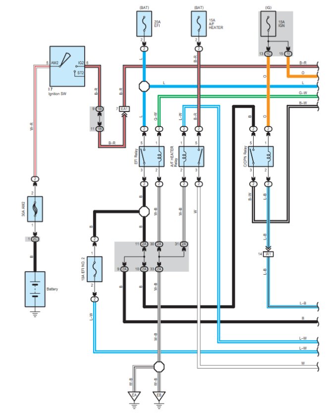

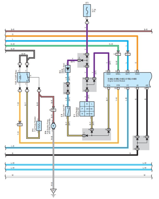

    2012 Prerunner SR5
    The Fuel Pump Relay controls the speed of the fuel pump.
    The COPN Relay is what actually energizes (turns it on and off) the fuel pump.
