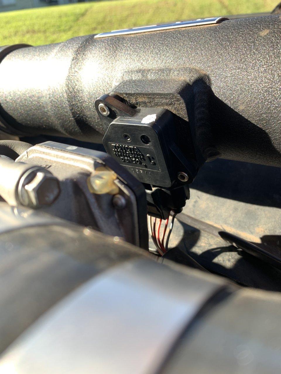

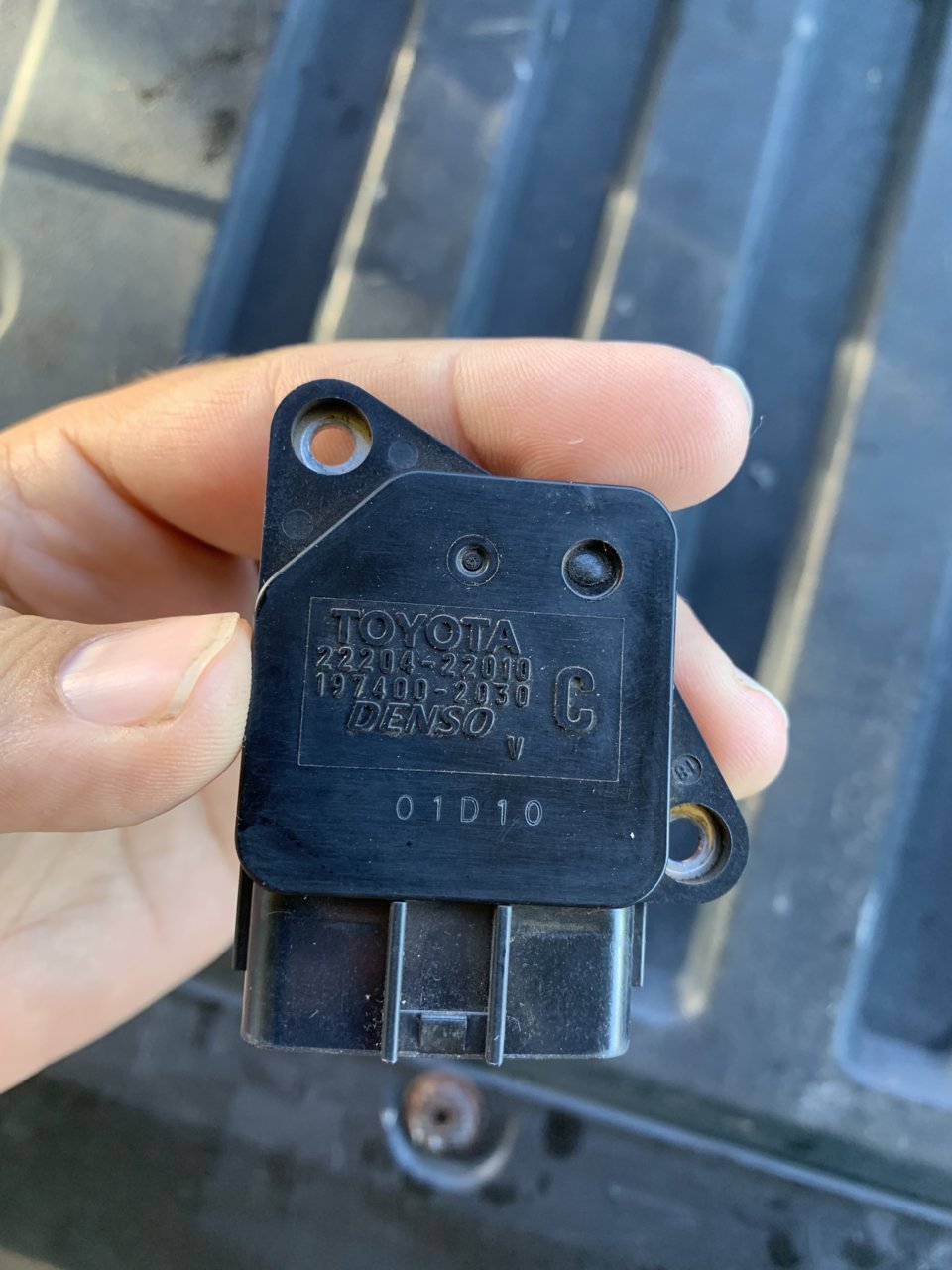

    @RocketTaco808, you listed that you replaced the MAF. For the sake of the forum, can you post a photo of it showing part number? I just want to be absolutely sure that the OEM MAF is the proper one for your truck. I ask this because just recently I have come across people with OEM MAF sensors but not the proper OEM MAF.

    regarding MAF, let me grab a couple pics.

    have a spare ECU NIB from toyota matching p/n of ECU in my truck, which matches the p/n from the ECU p/n post I typed out (with valued help from folks in TW that seconded my ecu being the correct p/n). J knows, and we’re saving as a nuclear option. Not a bad idea to send over now for the mongoose treatment.
    here are the pics. MAF installed is what J and I have been running with. Other MAF is what we were trying to run with (no difference seen in output results from the swap). Both were NIB from toyota.
    Please lmk if they’re not the right ones!

    Well, not being told to lynch my MAF for being the incorrect one, so assuming that’s the right one :)
