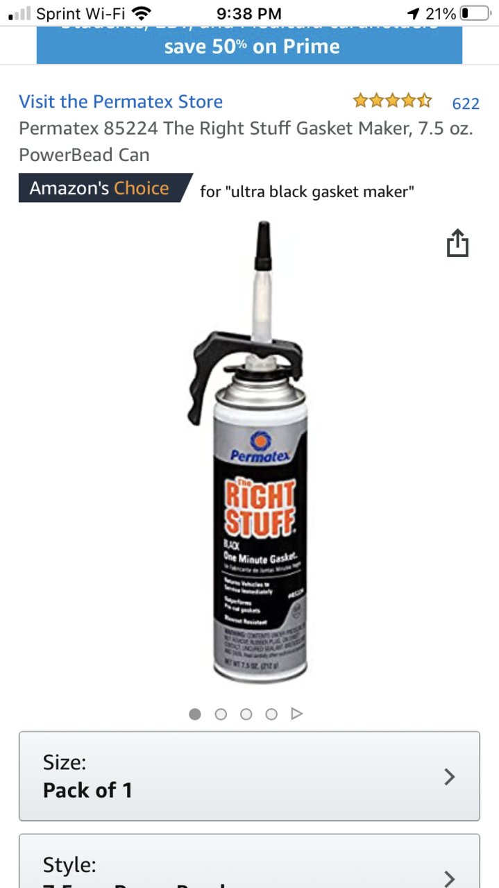

    Use this. It’s amazing. Sets in one minute. My go to for anything oil....068982A6-C812-4C98-84B7-53007696530C.jpg
