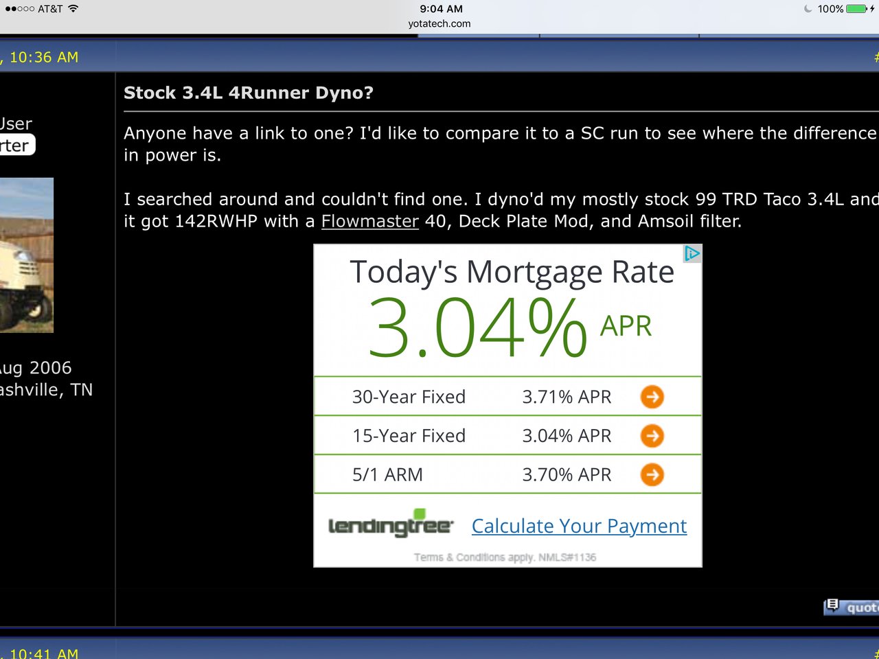

    Yes correct, depending on each truck setup, I looked up the rear stock dyno runs for a stock 3.4
    and found them on the low end at 122hp rear wheel hp to 142hp rear wheel, a 25 percent loss or more. Of course age, miles, etc will vary.
    This guy got 142hp with a flowmaster exhaust, deck plate mod and Amsoil filter
    And this other post shows 122hp on astock 3.4, if you turbo the 3.4 you can get
    350hp at the rear wheel but that's a complicated process as there are no true bolt in turbo kits at 3.4
