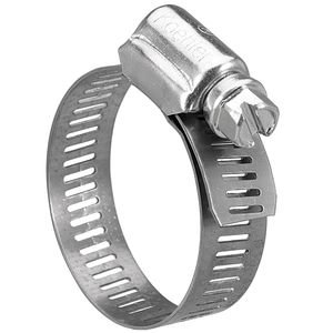

    I'm having a terrible time running down a coolant leak. It's now coming from the lower radiator hose where it connects to the water inlet. I have a new radiator, new lower radiator hose, new water inlet, new thermostat, and thermostat gasket. Literally, the only thing on the lower end of the cooling system that I haven't replaced is the hose clamp.
    I have this style on there: hoseclamp.jpg
    Can it be bad? Have I done it wrong? Should I use something else?
    Thanks

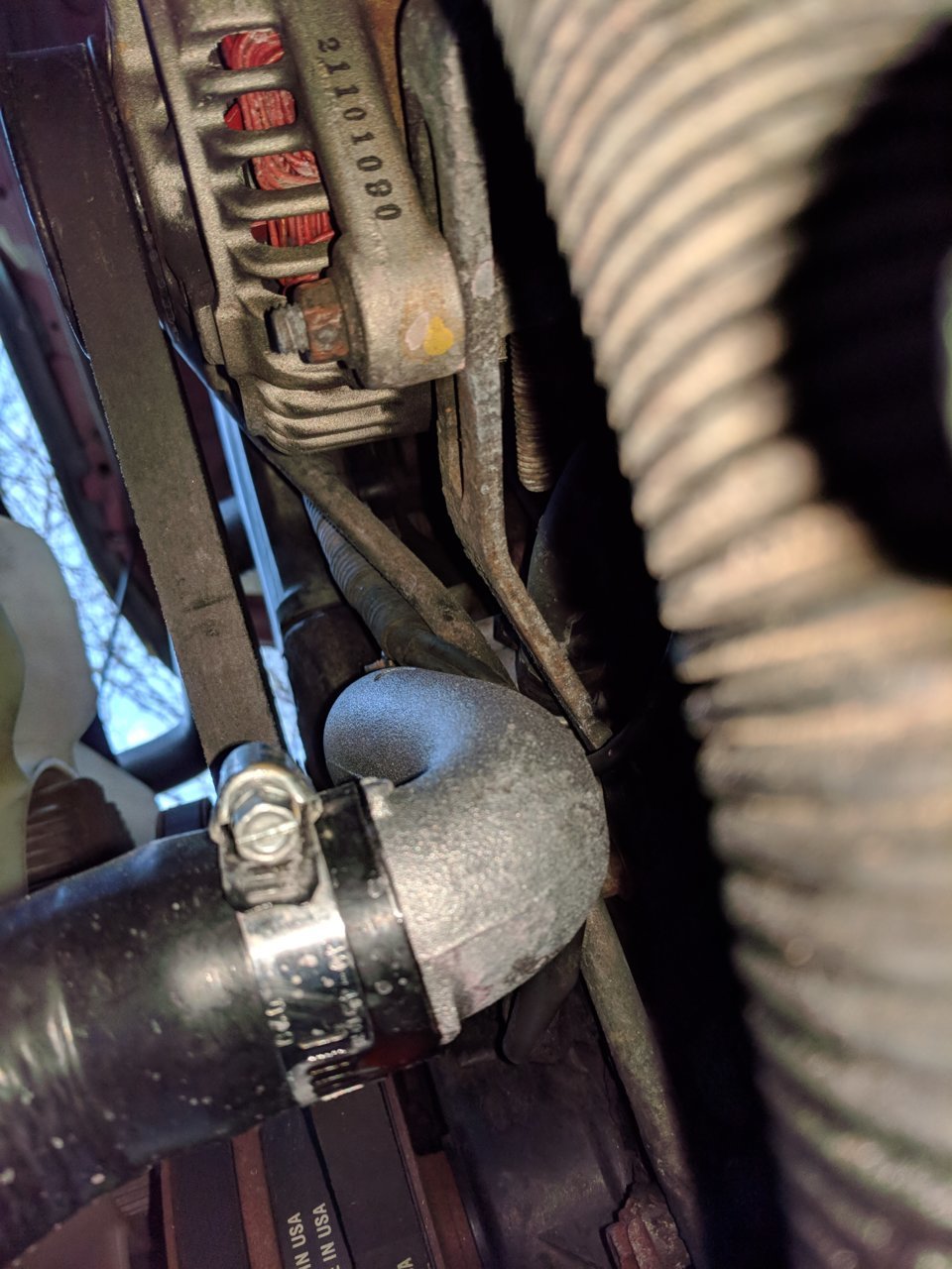

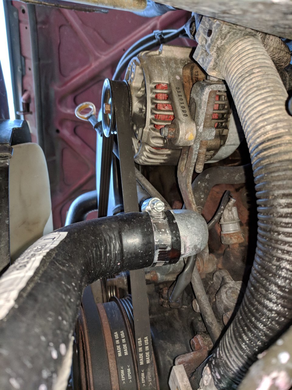

  15. Apr 2, 2018 at 3:04 PM
    pray4surf
    pray4surf Well-Known Member
    Jun 26, 2014
    #132750
    492
    Rick
    Oceanside, CA
    98 PreRunner conv to 4x4
    F&R suspension, OBA, Custom bed rack, RTT, rear frame plates, 4x4 conversion from prerunner, many other
    FYI - my daughter just paid Toyota of Escondido ~$500 for a radiator (and hose) replacement - the old was plastic, pert sure the new one is too...
  16. Apr 2, 2018 at 5:13 PM
    #16
    mwrohde
    mwrohde [OP] Well-Known Member
    Mar 12, 2014
    #125160
    1,062
    Sugar Hill, GA
    2003 Tacoma 4x4 5-speed 3.4 TRD SR5
    Here's some pictures. You have to look close, but you can see a drip of coolant on the hose clamp.
  17. Apr 2, 2018 at 5:26 PM
    #17
    Timmah!
    Timmah! Well-Known Member
    Feb 25, 2016
    #179385
    1,224
    TIM
    Maybe that elbow has some pitting on it which is causing the hose connection to leak. It's pretty common that these hose fittings get pitted from corrosion.
  18. Apr 2, 2018 at 5:28 PM
    #18
    mwrohde
    Mar 12, 2014
    #125160
    1,062
    Sugar Hill, GA
    It's two weeks old. I got tired of this shit and replaced everything. Took it out of the box from camelback with a new thermostat, lower hose, and thermostat gasket.
  19. Apr 2, 2018 at 5:30 PM
    #19
    NMTrailRider
    NMTrailRider Well-Known Member
    Sep 28, 2009
    #23469
    5,292
    New Mexico
    This would tell me it's leaking under pressure (hot fluid increases pressure). And not leaking when cold.
  20. Apr 2, 2018 at 5:38 PM
    #20
    NMTrailRider
    Sep 28, 2009
    #23469
    5,292
    New Mexico
    For kicks... Take off the hose clamp and reinstall it, making sure it's completely straight and flat. Sometimes these clamps get just a tic out of alignment and don't cinch up "flat" on the surface of whatever they are sealing.
    Is this the same location as where the OEM clamp sits? Seems to me it should be clamped closer to the end of the "male" end (i.e. moved to the left in your picture). I haven't looked at mine in awhile, so I could be wrong.
