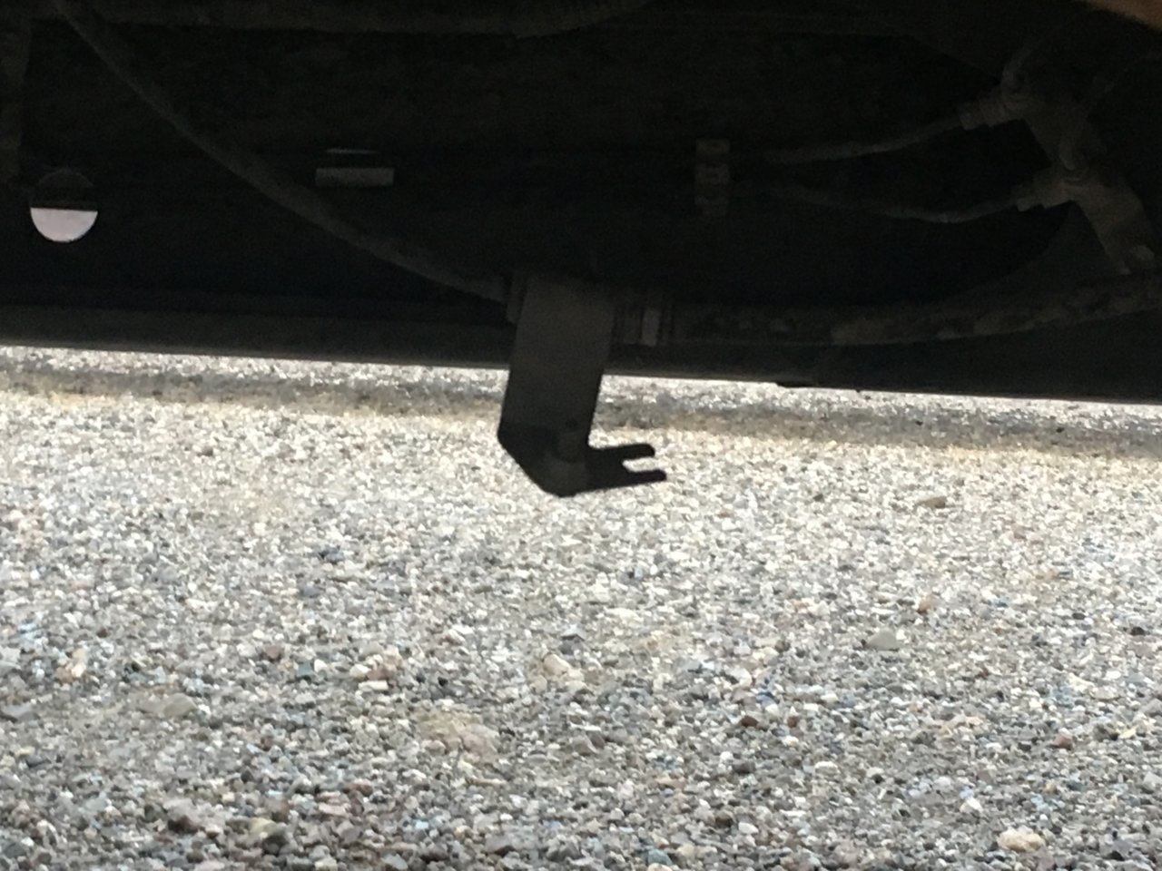

    F8C0C8A9-04C2-4BA1-B401-63B4815ACD06.jpg Maybe I’ve just been clueless and never noticed this before but is this hose supposed to be hanging like it is? This is in the middle of the truck, not entirely sure what it is just want to make sure it’s not problematic.

    Looks like shift cable possibly? Or parking brake. Either one needs to be tucked up.

    Looks like auto trans shift cable or a parking brake cable... bolt probably came loose. Definitely going to want to fix that.

    Yeah looks like bolt is broken off in bracket

    Thanks guys, I’m in Death Valley for a cpl days and I must have knocked it loose sometime today. I’ll get it fixed up hopefully tomorrow, will stick to pavement until I do

    Just poke your head underneath, I bet its a m6 bolt or nut that came loose, easily sources from elsewhere in the truck (fenders, near the rear tail gate / rear lights) bolts.
    I wouldnt drive it at all until its tucked back up in place for fear of melting it or it getting mangled by the driveshaft. Even a good zip tie to hold it to about where it should go is plenty good for the short term.
