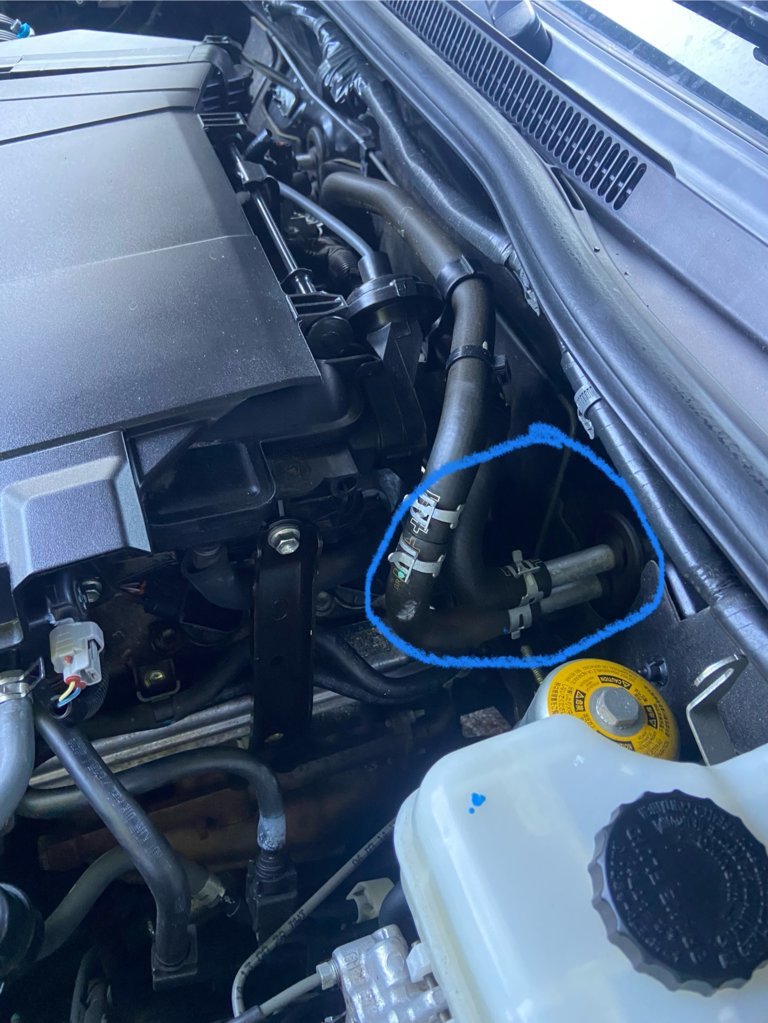

    I am trying to replace my PCV valve and I’m curious what these hoses are in below photo? Also - are they safe to remove to replace the PCV valve? Thanks for the help!
    Also if anyone on here has created a proper under hood identification diagram for 1GR-FE Tacomas, can you please share?

    Those are the heater hoses, you can unhook them but coolant will run out.

    Heater hoses with coolant in them.
    You can shift the hoses out of the way without opening them. You can also unclip the holder on the back of the intake manifold.
