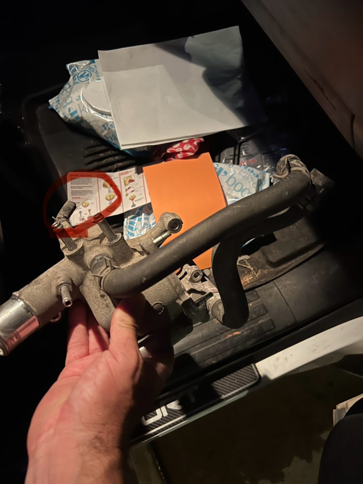

    I am trying to locate the replacement hoses that connect to the thermostat housing. Especially the one that is hard to get to and runs out the back (I cut this one when removing it.). Was just going in to replace the water pump and it has turned into, thermostat replacement, pulleys, belt and radiator hoses. Everything is apart I’m ready to just get it back together.

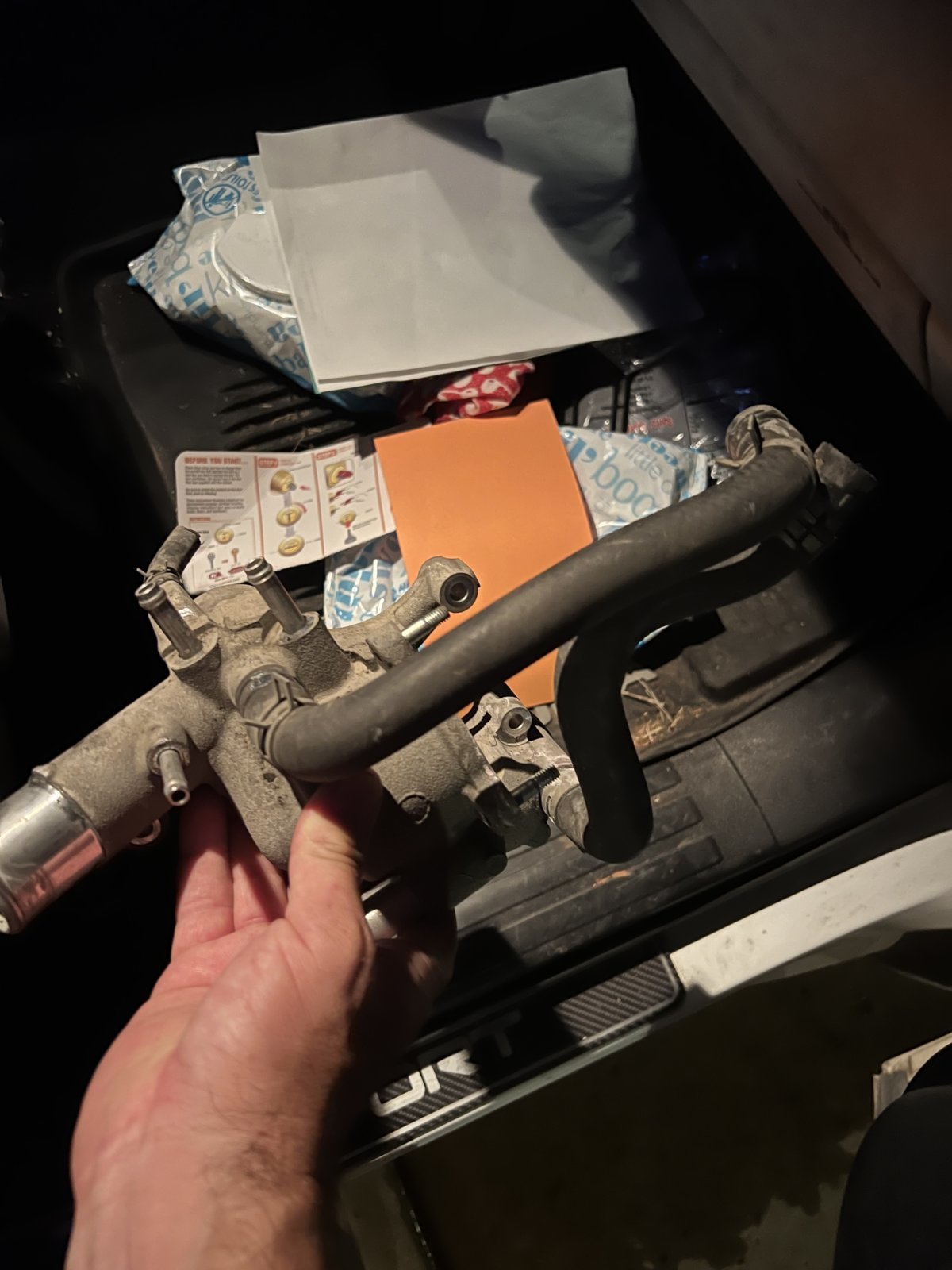

    are they the ones that went to the oil cooler? (under the oil filter)

    Thank you! Those are the oil cooler lines. What I was looking at didn’t have the tow package and I guess that was the difference there. Any idea on this circled red one. I’m having trouble even with the diagrams and parts list on this one.

    I think it goes to a a metal pipe that goes under the intake.
    I'll have to see if I can find a picture of it. (Diagram)

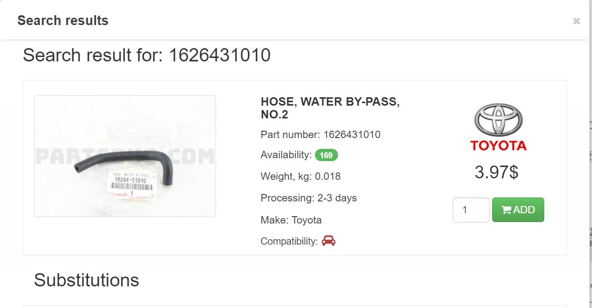

    Here you go. All hose are there.
    Click on the number circled in blue for the Toyota Part #
    I think it's the water by-pass hose #2
