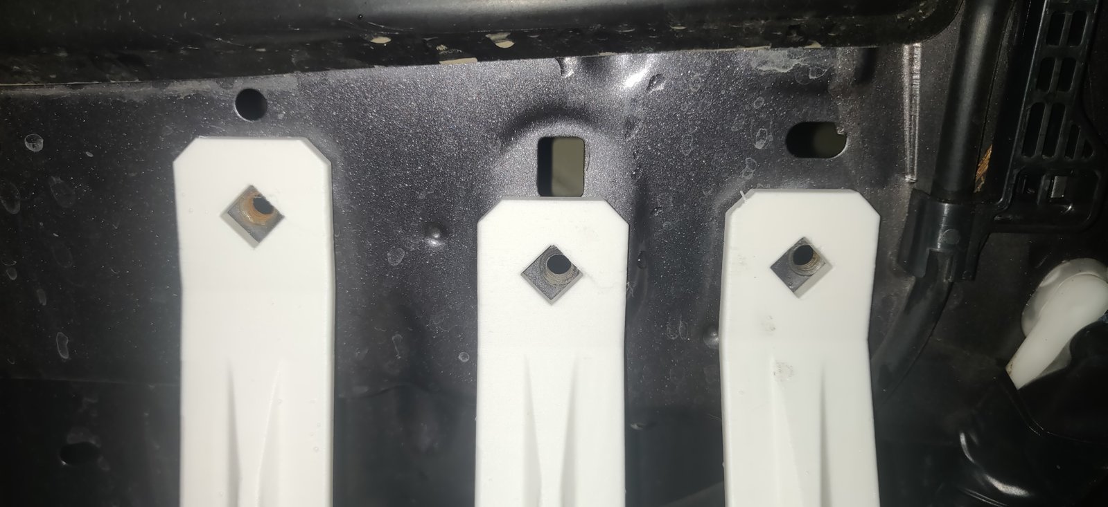

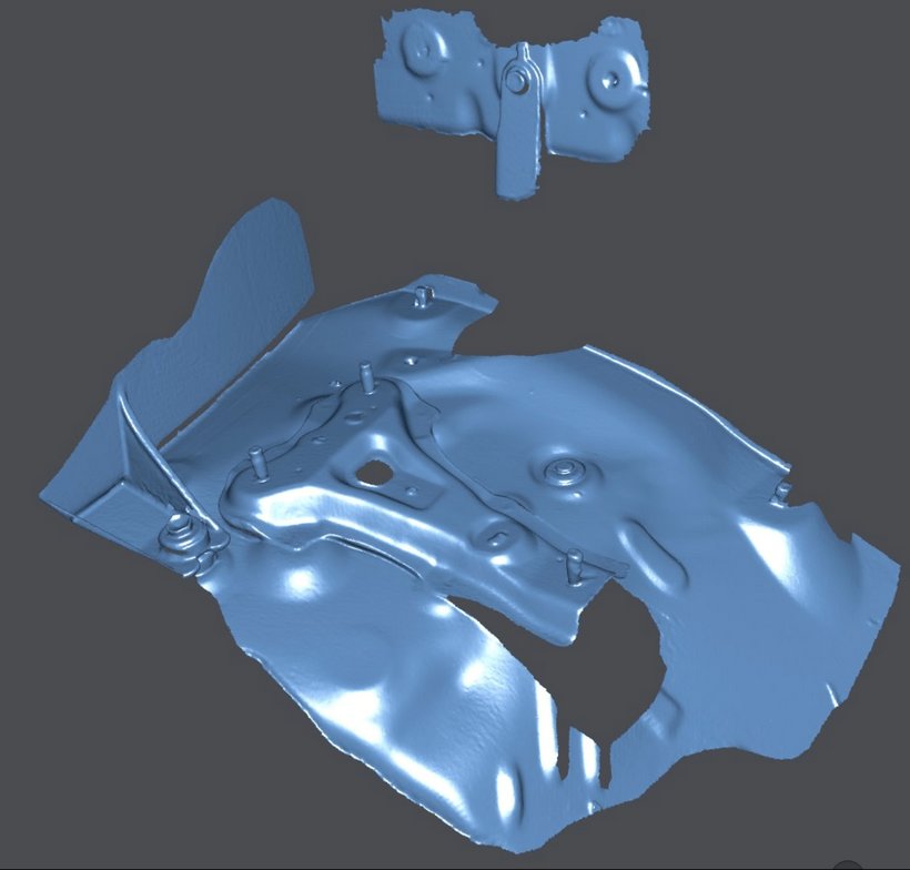

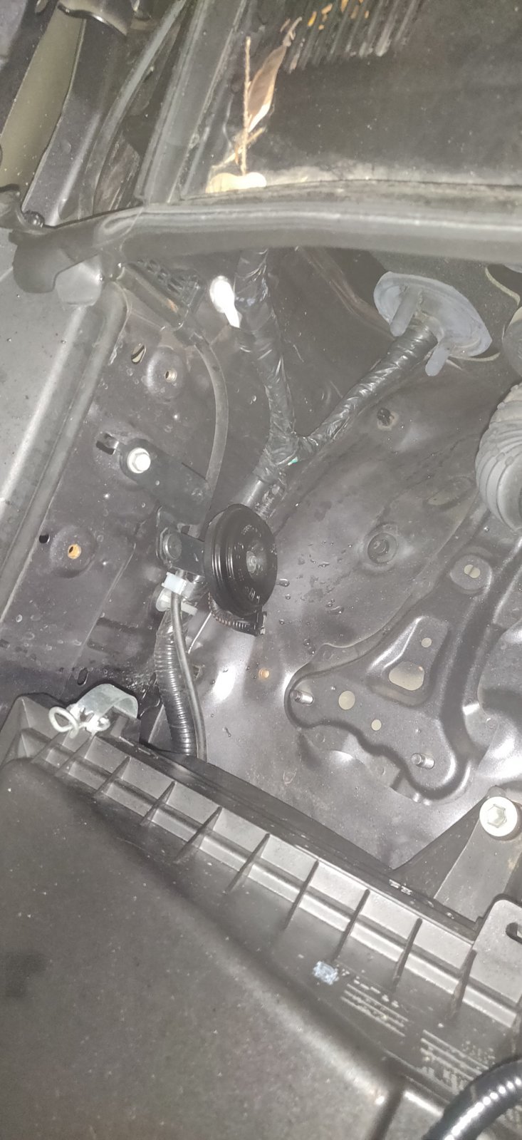

    Using scans sent to me, I learned a lot about the current offerings of free tools.
    I took this scan of the RR engine compartment, cleaned and trimmed it, then used the geometry to create a test fit gauge to see if it's accurate.
    And yes, yes it really is!
    Blame the very slight misalignment on the flimsy gauge I printed. I was rushing to get something on the printer before I went to sleep.

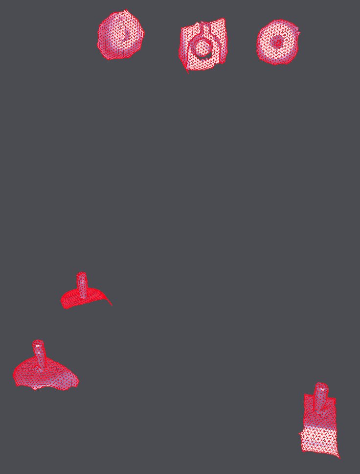

    The scan was made with this, which is perhaps on the lower end of the scale both in price and expectations:
    https://www.creality.com/products/creality-cr-scan-lizard-3d-scanner
    I used MeshLab initially to do all of the cleanup and trimming. It's a very powerful tool and I barely scratched the surface of what it can do.

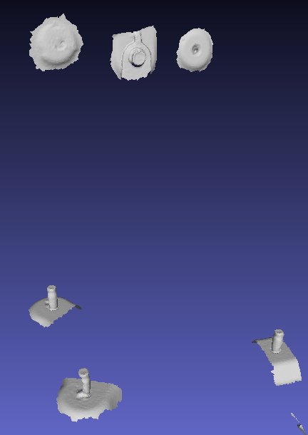

    After cleaning it up and trimming it, I ended up with something like this:
    And then quite a bit more trimming away what I didn't care about for now. Solidworks wasn't dealing well with the massive meshes but smaller subsets it was okay with.

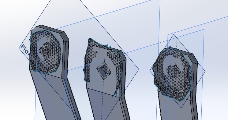

    Then I brought this into another tool I stumbled across called "Instant Meshes". This provided a very automated way to generate a simplified and more geometric surface mesh.
    This is the mesh I then imported into Solidworks, created a few planes based on the geometry, and started throwing together a gauge build off the geometry.

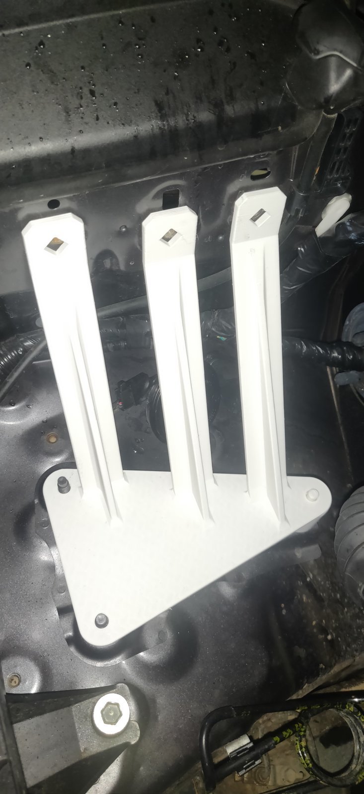

    Then to verify the geometry, I 3D printed the gauge and it fit beautifully the first time! This proves that I can now use the geometry to create other things as well.

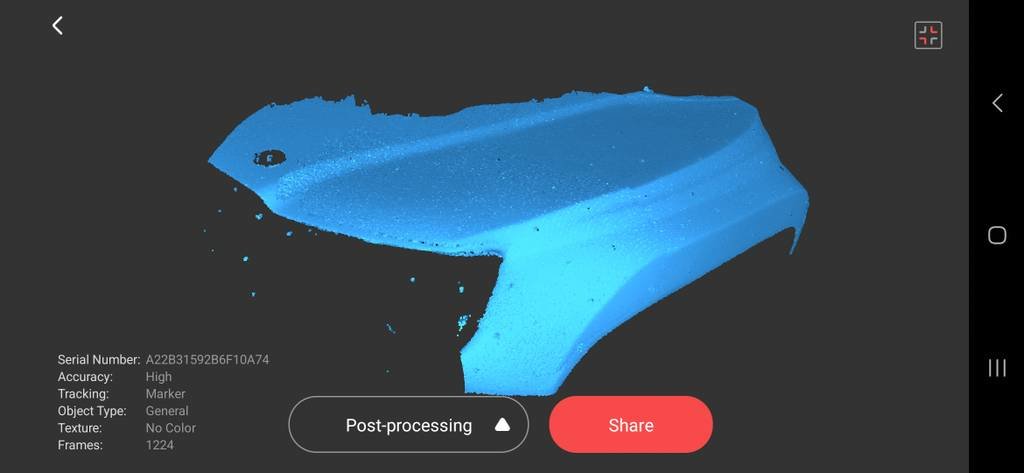

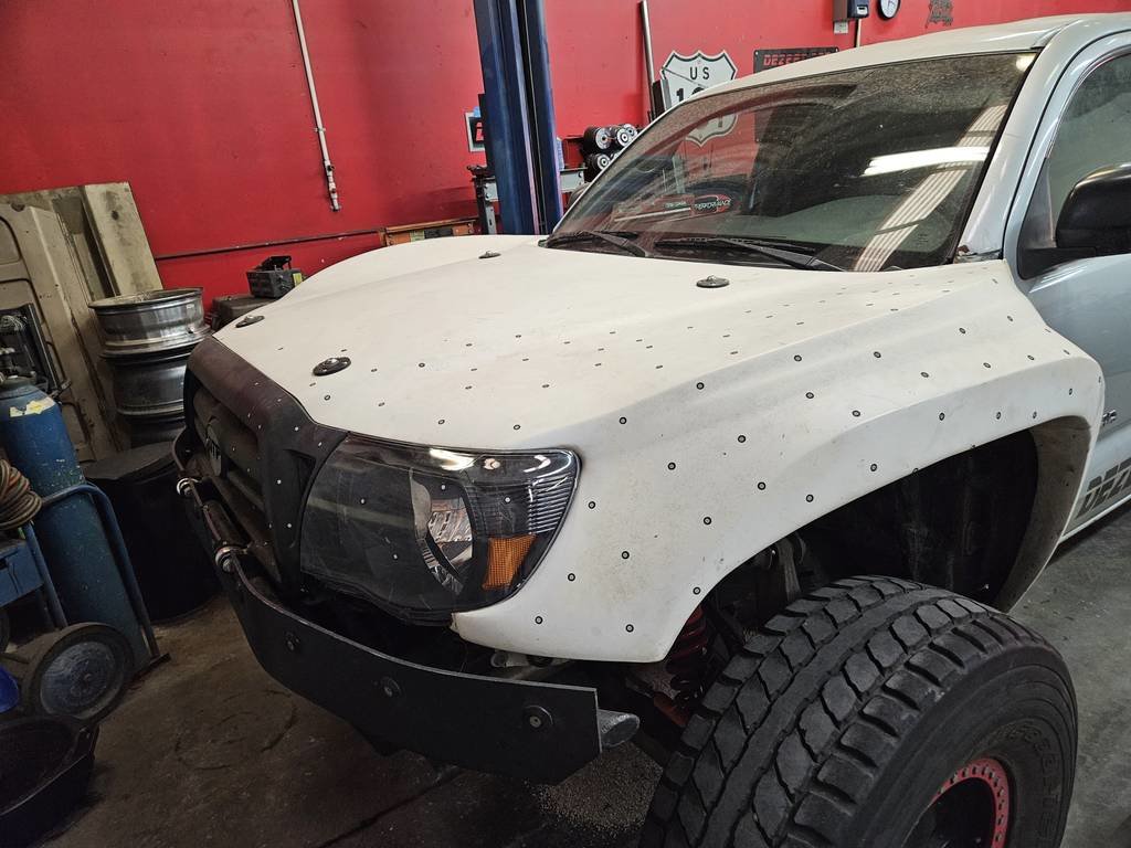

    I actually picked up a revopoint range last year and plan to do more scanning this year. I really like the idea of sharing the files for these trucks.
    This was me just testing the scanner out. Completely raw scan with no post processing

    #266818
    2,021
    are those reflectors for scanning?
  16. Jan 25, 2024 at 10:55 AM
    #36
    DTFtacoma
    DTFtacoma Dezert Toy Fabrication Vendor
    Mar 5, 2009
    #14364
    6,954
    Anthony
    Santa Maria, CA
    06 PreRunner D-cab
    DTF LT front & rear
    Yes those are tracking dots.
    It helps keep tracking

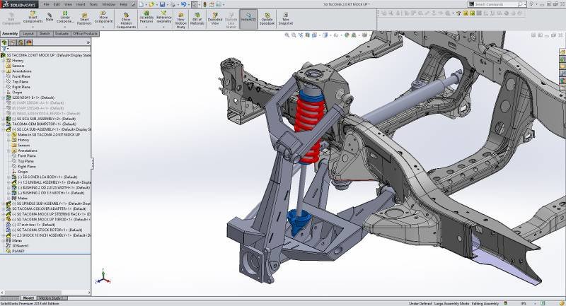

    The first pic doesn't have any scans in it. That's just my suspension design of a tacoma frame file.

    Where did you get the frame model? Which generation? Is it dimensionally accurate?

    Bought it online, appears to be 2nd gen (2015), and yes it is.
