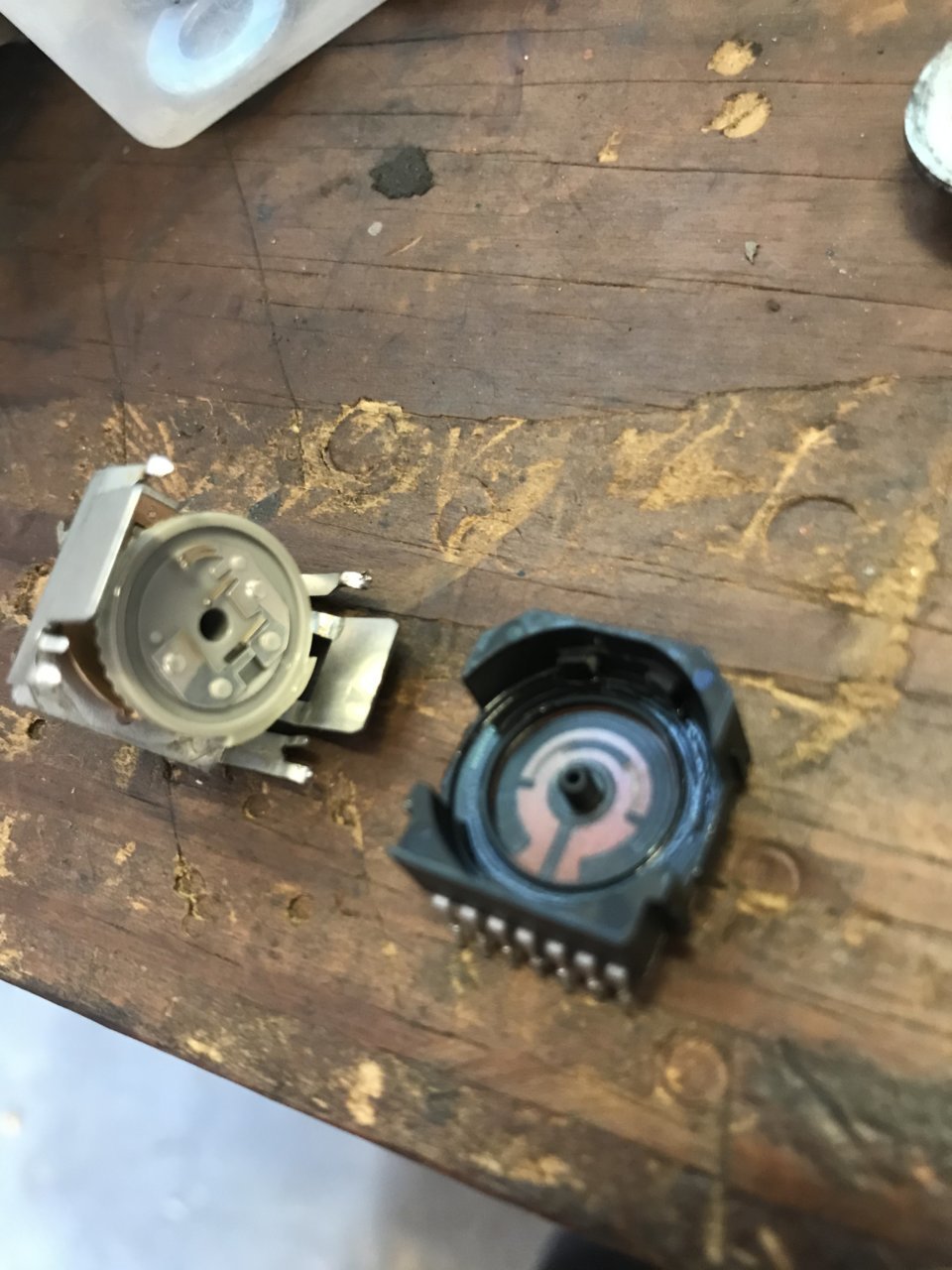

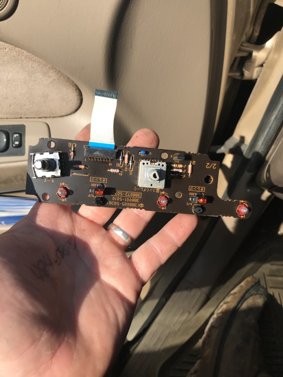

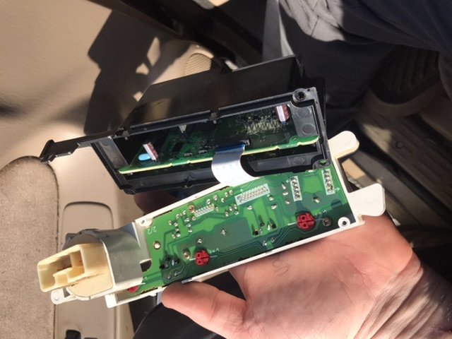

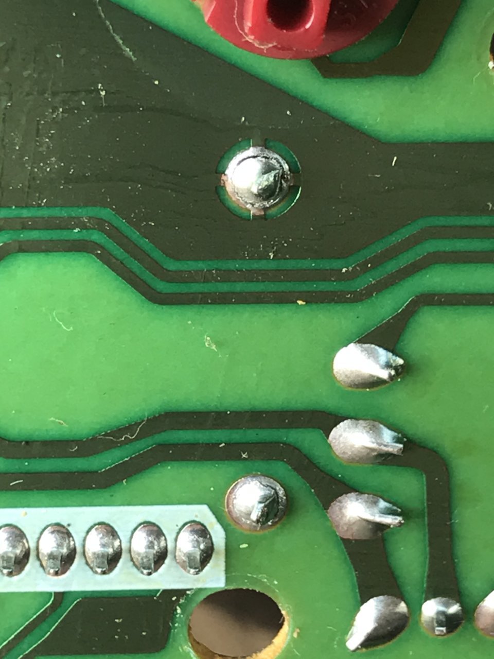

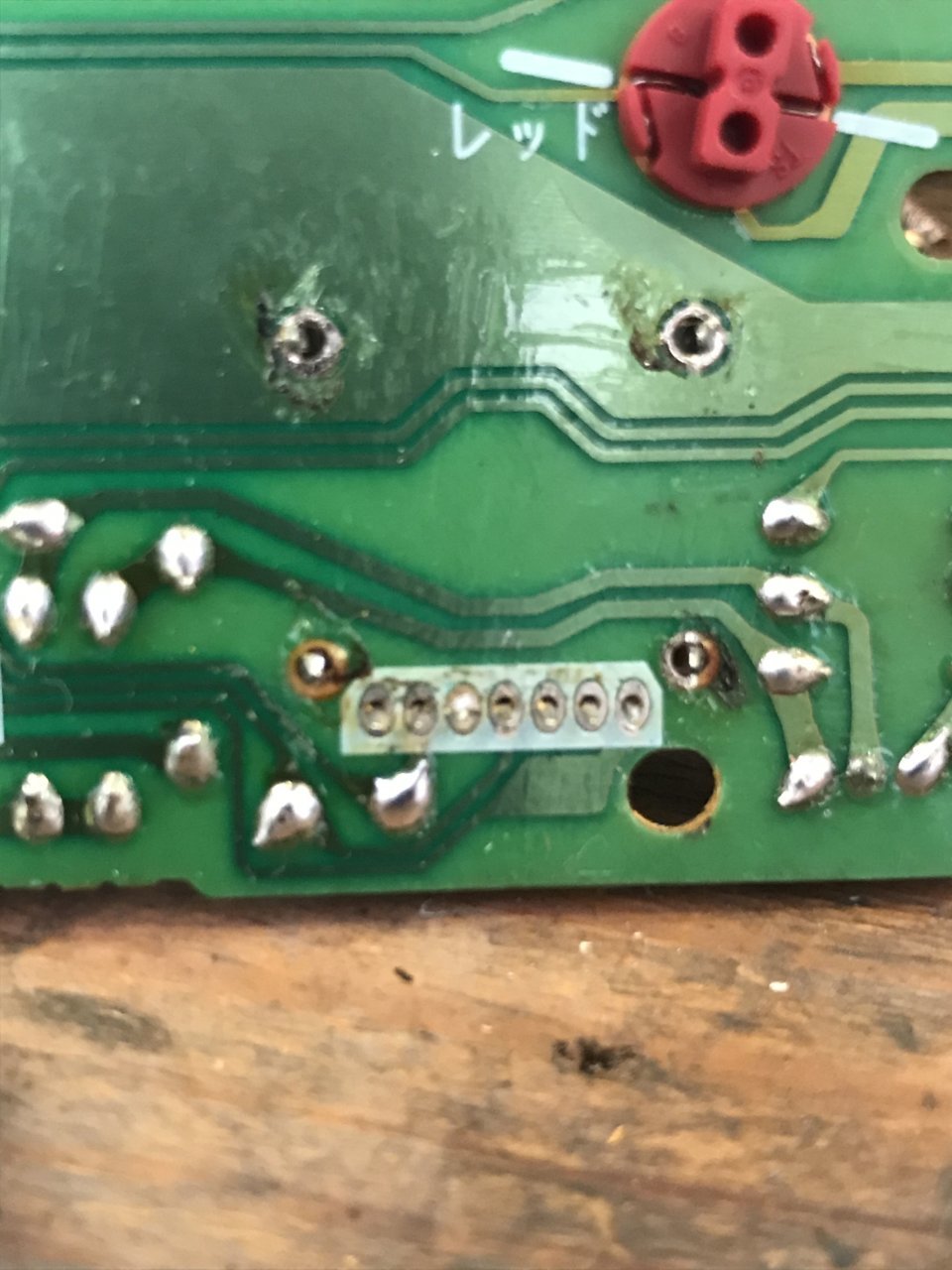

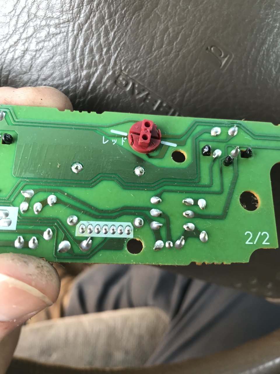

    Hey guys I am new to the forum but I just had the same issue with my 01 Tacoma. It was intermittent and would default to heat. Moving the know around would usually get it working after a while so I figured it was something with the control itself. I took it apart and disassembled the control and found two broken solder joints for the temp control knob. I resoldered the joints and put it back together and it works perfectly. This issue would apply to the 01-04 models. I can’t promise this is your problem but it is worth a look since you are going to be replacing that control anyway. It is easy to disassemble and the get to the back of the knobs. I posted a few pics of the spot that was cracked. Hope this helps someone else.

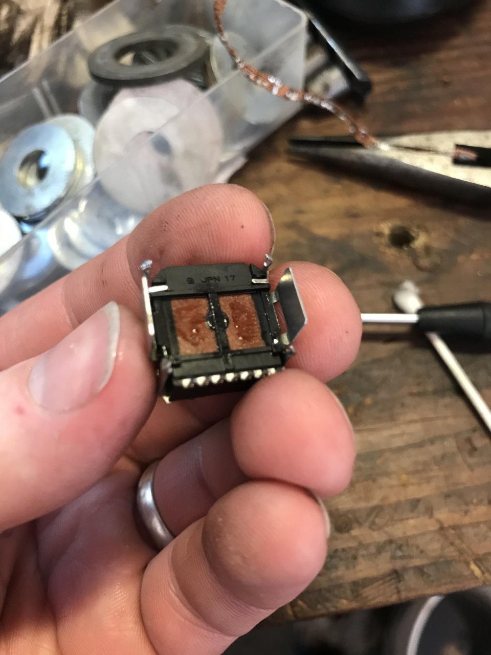

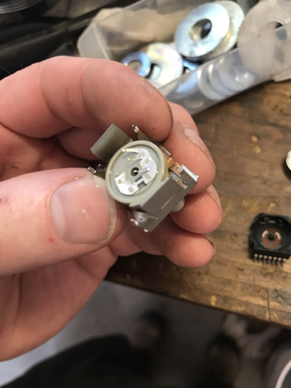

    Ok quick update. After about ten minutes it started acting up again. I could still fix it by playing with the control knob so I took I back apart and de soldered the temp control varistor switch from the board and carefully opened it up. You have to be very gentle when de soldering so you don’t damage your board. I had two spots delaminate but they fortunately were not actual circuits so it worked out. Once the switch was out I had to bend a few tabs to expose the contacts. Pay attention to the orientation so it goes back together the correct way. I would mark the housing before taking it apart. Inside there are several wiper contacts and carbon tracks which allow the switch to change the resistance and tell the board what position to put the blend door in. I gently cleaned the carbon tracks with contact cleaner and a Q Tip and I very gently bent the wipers out just a smidge to tighten up the connection. Then I put it all back together and re soldered it to the board and re assembled and tested. Now it works perfectly and hasn’t given any more problems. I am posting a few pics for reference. If you have never soldered or de soldered board components before I would recommend finding a friend who has or practicing on a junk board from and old computer or appliance before attempting this. It is easy to screw up and then your control is shot. Hope this helps.
    -Nathan
